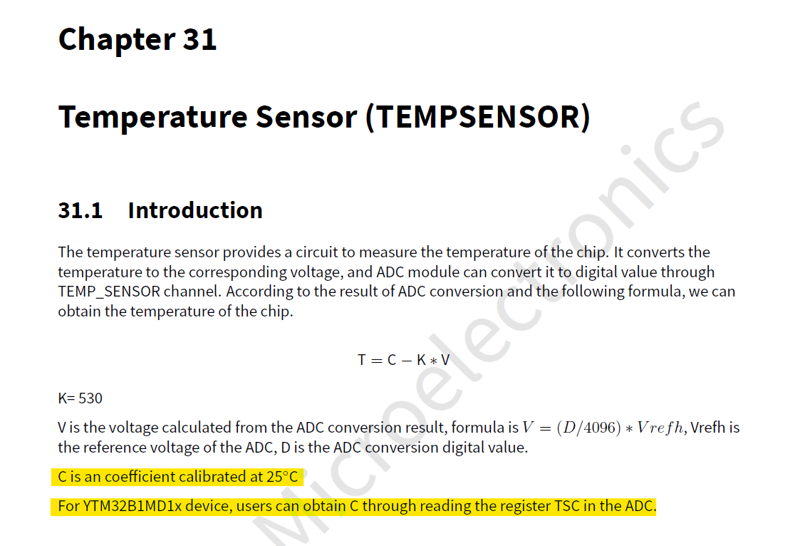

    Hi everyone,
    I’m trying to read the MCU temperature from the internal temperature sensor of the YTM32B1MD1.
    According to the Reference Manual, it says I need to read the C value from the TSC register in the ADC. But I couldn’t find any register named TSC in the ADC register group, or anywhere else in the document.
    Has anyone worked with this before? Is it a typo in the manual, or where can I find the TSC register? I'm using the RM Rev. 1.3.
    Thanks in advance!
    • runR 离线
      runR 离线
      run YunTu
      Currently,you can get some reference from the YTM32B1MC0 reference manual.
      The next version of the YTM32B1MD1 reference manual may update the relevant registers.

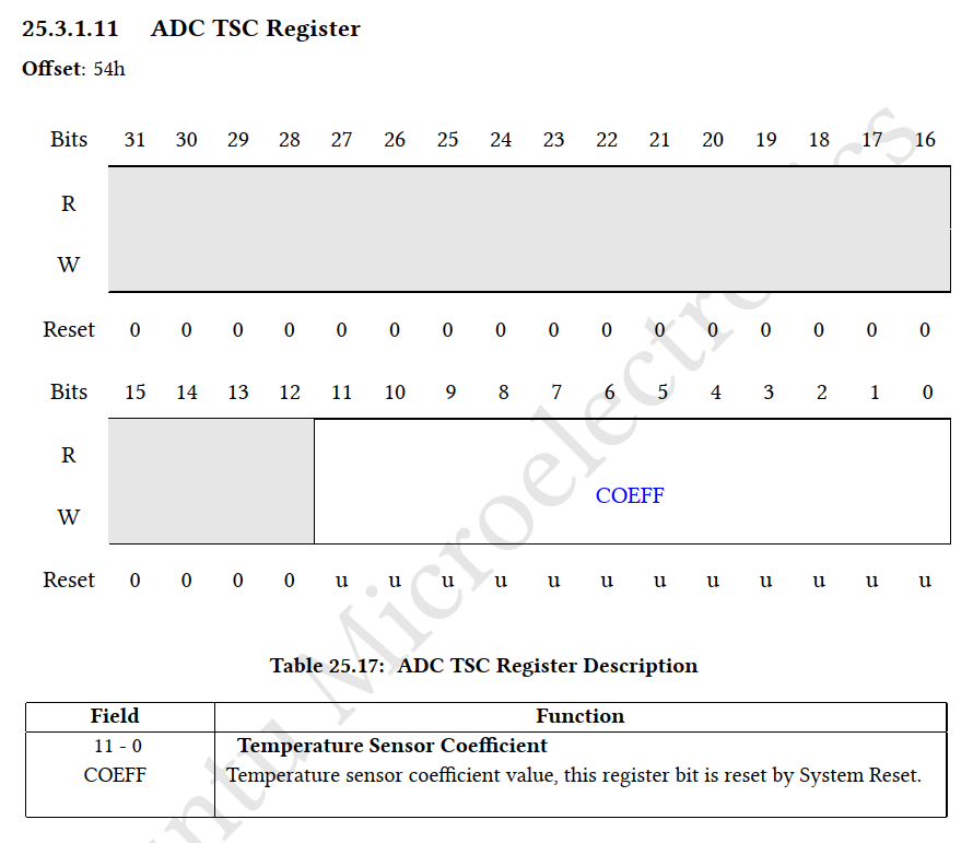

      • runR 离线
        runR 离线
        run YunTu
        You can refer to the attachment below: YTM32B1MD1_TempSensorDemo
        YTM32B1MD1_TempSensorDemo.zip

              Hello, one more question from my side. How could I know if the coefficient I readback is correct or not?
              I refered from your example code and got the coefficient value was 386. Is it correct or not?
              Thanks in advance!
              • runR 离线
                runR 离线
                run YunTu
                Generally, if the reading is not entirely FF, it is correct. You can use a temperature sensor at room temperature to measure the actual temperature. If it is close to the ambient temperature, it confirms that its COEFF is correct.
