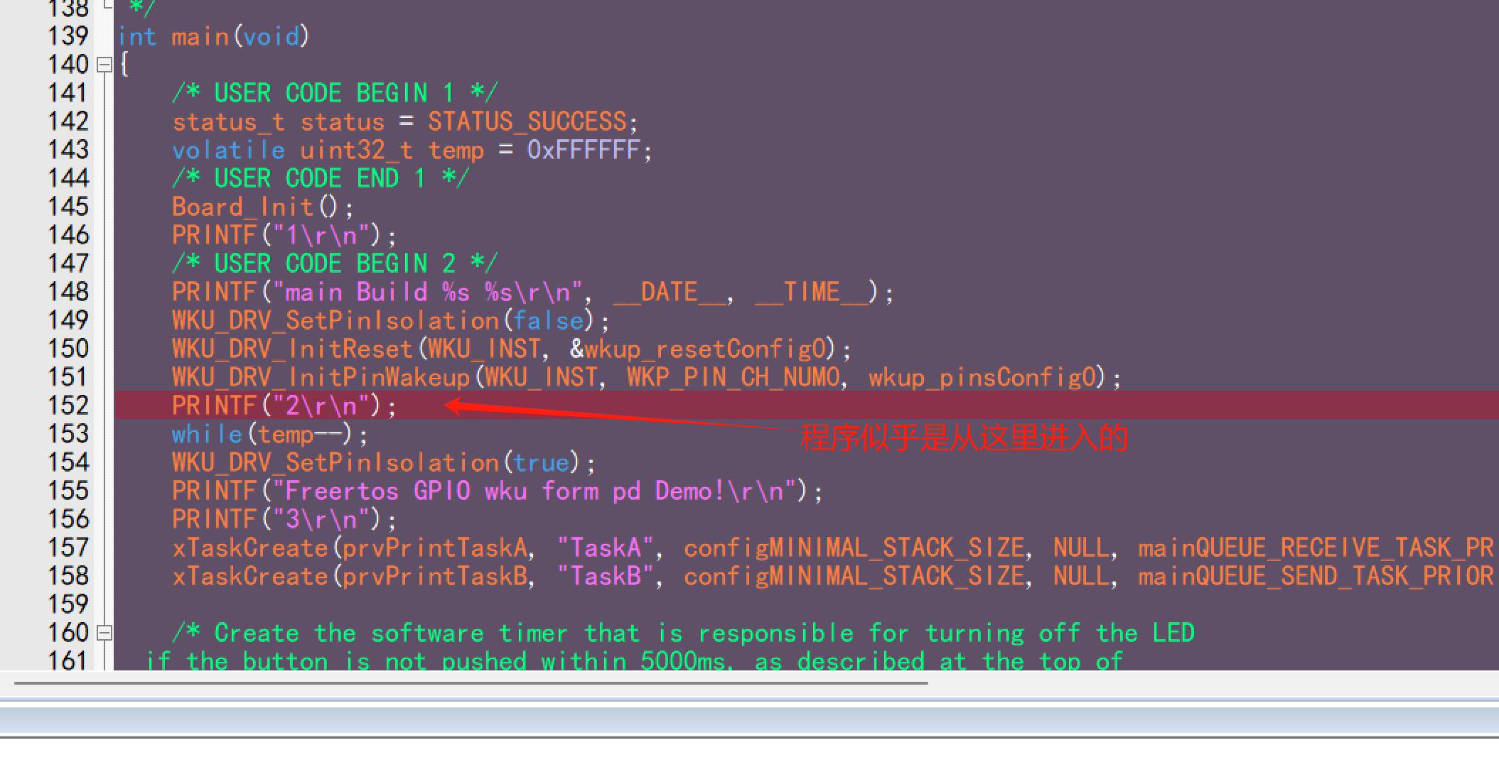

    使用YCT的生成的HA freertos增加gpio wku唤醒powerdown,发现程序并没有进入复位流程重新执行main程序.没有打印Build信息
    void prvPrintTaskB(void *pvParameters)
        (void)pvParameters;
        while (1)
            PRINTF("POWERDOWN_MODE \r\n");
    	POWER_SYS_SetMode(POWERDOWN_MODE, POWER_MANAGER_POLICY_AGREEMENT);
            vTaskDelay(2000UL);
    int main(void)
        /* USER CODE BEGIN 1 */
        status_t status = STATUS_SUCCESS;
    	  volatile uint32_t temp = 0xFFFFFF;
        /* USER CODE END 1 */
        Board_Init();
        PRINTF("1\r\n");
        /* USER CODE BEGIN 2 */
        PRINTF("main Build %s %s\r\n", __DATE__, __TIME__);
        WKU_DRV_SetPinIsolation(false);
        WKU_DRV_InitReset(WKU_INST, &wkup_resetConfig0);
        WKU_DRV_InitPinWakeup(WKU_INST, WKP_PIN_CH_NUM0, wkup_pinsConfig0);
      	PRINTF("2\r\n");
        while(temp--);
    		WKU_DRV_SetPinIsolation(true);
      	PRINTF("Freertos GPIO wku form pd Demo!\r\n");
      	PRINTF("3\r\n");
        xTaskCreate(prvPrintTaskA, "TaskA", configMINIMAL_STACK_SIZE, NULL, mainQUEUE_RECEIVE_TASK_PRIORITY, NULL);
        xTaskCreate(prvPrintTaskB, "TaskB", configMINIMAL_STACK_SIZE, NULL, mainQUEUE_SEND_TASK_PRIORITY, NULL);
        /* Create the software timer that is responsible for turning off the LED
      if the button is not pushed within 5000ms, as described at the top of
      this file. */
        xPrintTimer = xTimerCreate("PrintTimer",         /* A text name, purely to help debugging. */
                                   5000UL,               /* The timer period, in this case 5000ms (5s). */
                                   pdTRUE,               /* This is a one shot timer, so xAutoReload is set to pdFALSE. */
                                   (void *)0,            /* The ID is not used, so can be set to anything. */
                                   prvPrintTimerCallback /* The callback function that switches the LED off. */
        xTimerStart(xPrintTimer, 0);
        /* Start the tasks and timer running. */
        vTaskStartScheduler();
        /* USER CODE END 2 */
        /* Infinite loop */
        /* USER CODE BEGIN WHILE */
        while (1)
            if (status != STATUS_SUCCESS)
                break;
            /* USER CODE END WHILE */
            /* USER CODE BEGIN 3 */
        return status;
        /* USER CODE END 3 */
    后面测试发现如果我注释掉WKU_DRV_SetPinIsolation的两句配置后能正常从main进入,如果我把WKU_DRV_SetPinIsolation(true); 加到 POWER_SYS_SetMode前面现象同上
        //WKU_DRV_SetPinIsolation(false);
        //WKU_DRV_SetPinIsolation(true);
    看到Power_Pin_Wakeup_From_Powerdown_Mode_Demo也有这个操作
    WKU_DRV_SetPinIsolation API我的理解是保持引脚状态,为啥会影响从PD唤醒的程序的执行的位置

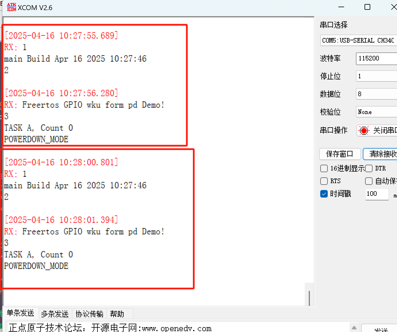

      major 感谢您的回复,我调整了一下 WKU_DRV_SetPinIsolation(false); 的位置(放到打印之前),程序运行确实与预期相符了

          WKU_DRV_SetPinIsolation API确实是用来保持引脚状态的,并不会影响程序执行,测试效果上影响程序执行是因为UART的引脚在隔离状态并不会输出,也就表现为没有打印状态,因为处于唤醒隔离状态IO是保持原有状态的,必须解除隔离才能有正常的功能。
