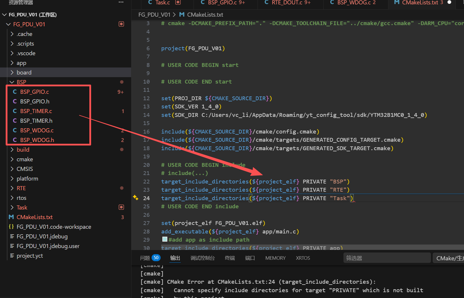

      Frankie # USER CODE BEGIN include
      增加bsp/inc头文件搜索路径
      target_include_directories(${project_elf} PRIVATE "bsp/inc")
      USER CODE END include
      USER CODE BEGIN add_executable
      增加源文件bsp/bsp.c 作为源代码
      target_sources(${project_elf} PRIVATE "bsp/bsp.c")
      USER CODE END add_executable
