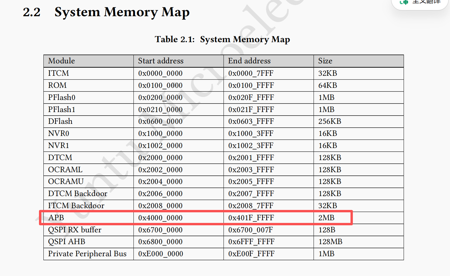

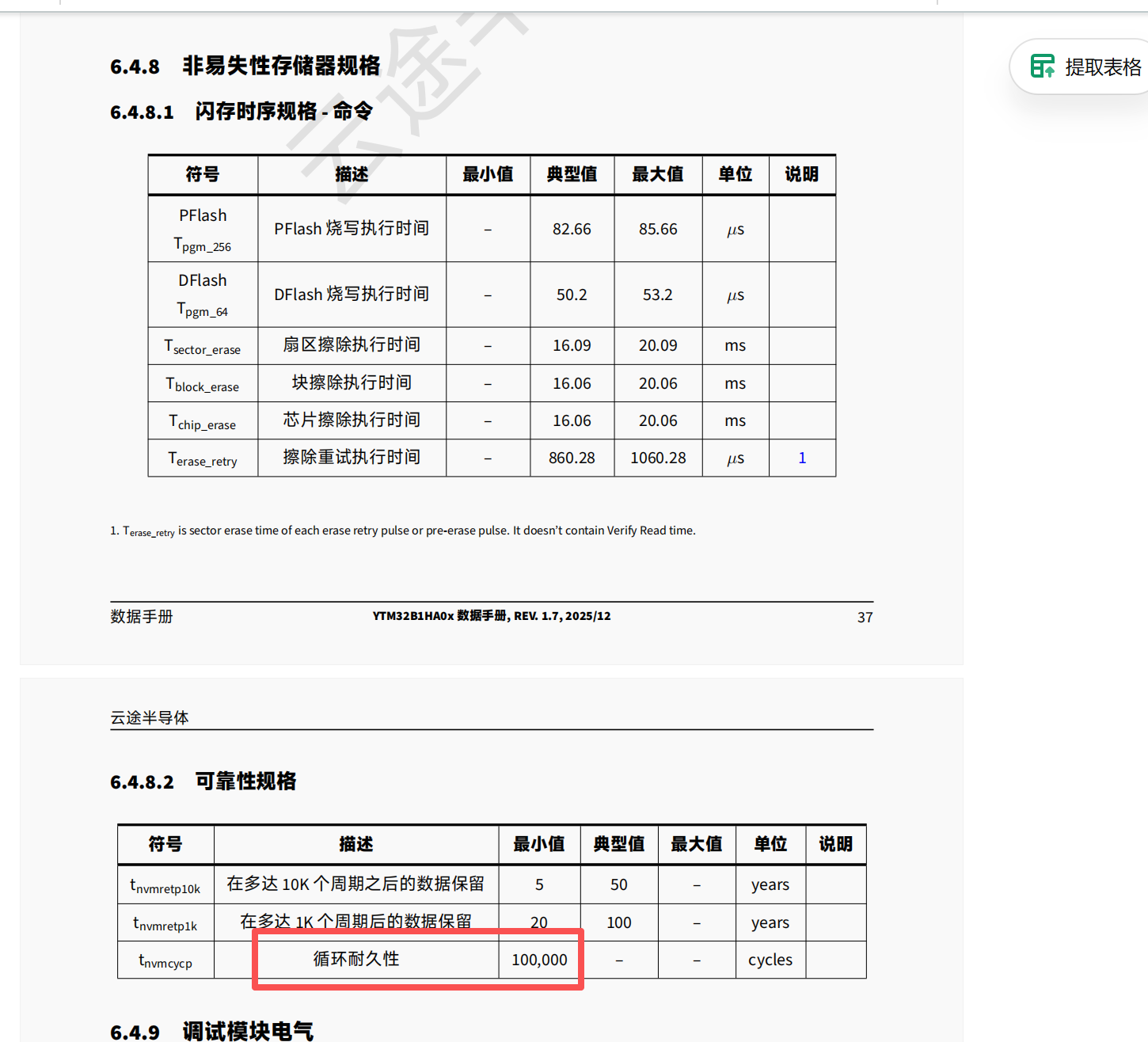

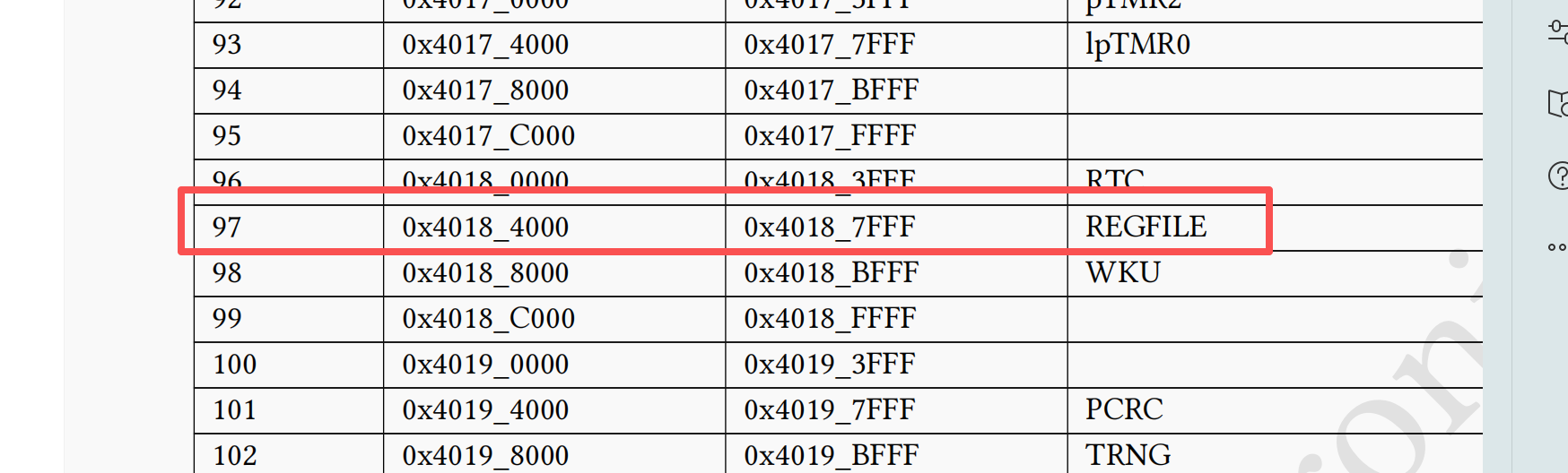

    请教一下各位,HA的REGFILE寄存器的擦写次数(min)也是10W么
    c66030d9-d98b-47b6-8ae3-3c53c02f3b2a-image.png 29e5b29e-babb-4c2d-944e-77d1e9cd9bb9-image.png
