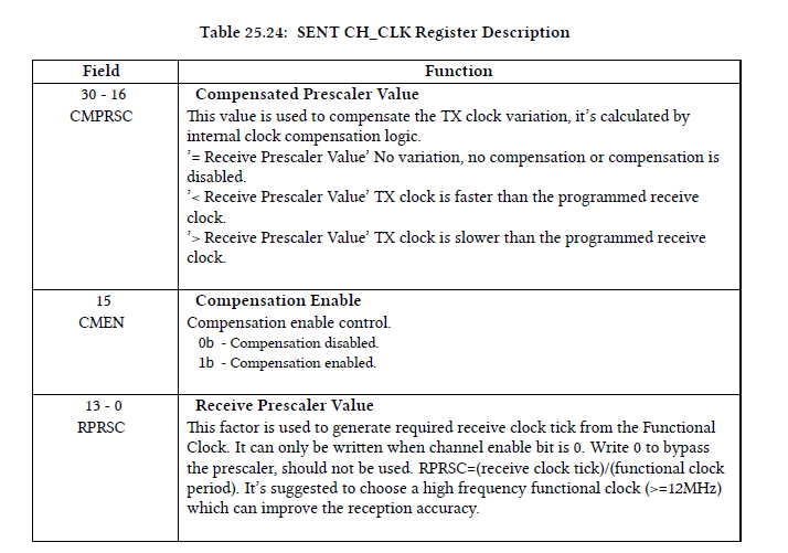

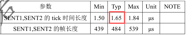

    YTM32芯片手册SENT解析 的1TICK在3us到90us之间,但是EPS hella传感器sent有两路了是1.65us的,是不是就不能解析?cec8fb37fc6a2b9fd083fb0ea53960ef.png 但是EPS的传感器信号时间小于3us 6517d626f765e22ff5c9ab3e7cee6535.png
      是的,MD1 只支持两路 SENT 通道,如果这三路 SENT 是同时发送数据,那 HA01 是更好的选择
        可以支持,但是 SDK 不支持配置,需要自己手动修改寄存器来满足该 Tick 值,具体请参考 CH_CLK 寄存器描述

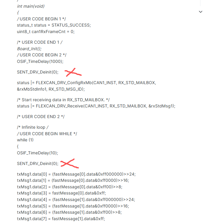

              测试SENT例程只运行一次,请问怎么周期性采集SENT信号呢?
              • haiyangH 离线
                haiyangH 离线
                haiyang YunTu
                具体哪个demo,正常只要你SENT信号在发,中断就会一直进的,也能一直采集SENT信号的

                  /* USER CODE BEGIN Header /
                  you can remove the copyright /
                  • Copyright 2020-2025 Yuntu Microelectronics Co., Ltd.
                  • All rights reserved.
                  • SPDX-License-Identifier: BSD-3-Clause
                  • @file main.c
                  • @brief
                  /* USER CODE END Header /
                  #include "sdk_project_config.h"
                  Includes ------------------------------------------------------------------*/
                  /* Private includes ----------------------------------------------------------/
                  USER CODE BEGIN Includes /
                  #include "printf.h"
                  USER CODE END Includes */
                  /* Private typedef -----------------------------------------------------------/
                  USER CODE BEGIN PTD /
                  USER CODE END PTD */
                  /* Private define ------------------------------------------------------------/
                  USER CODE BEGIN PD */
                  //#define INST_UART (0)
                  #define CAN1_INST (0U)
                  #define RX_STD_MSG_ID (0x03UL)
                  #define RX_STD_MAILBOX (0x00UL)
                  #define TX_MSG1_ID (0x133UL)
                  #define TX_MAILBOX1 (0x01UL)
                  #define TX_MSG2_ID (0x134UL)
                  #define TX_MAILBOX2 (0x02UL)
                  #define TX_MSG3_ID (0x135UL)
                  #define TX_MAILBOX3 (0x03UL)
                  #define LED_B_TOGGLE() (PINS_DRV_TogglePins(GPIOB, (pins_channel_type_t)1 << 4U))
                  #define LED_R_TOGGLE() (PINS_DRV_TogglePins(GPIOE, (pins_channel_type_t)1 << 8U))
                  /* USER CODE END PD */
                  /* Private macro -------------------------------------------------------------/
                  USER CODE BEGIN PM /
                  USER CODE END PM */
                  /* Private variables ---------------------------------------------------------/
                  USER CODE BEGIN PV */
                  sent_raw_msg_t fastMessageBuffer;
                  sent_raw_msg_t slowMessageBuffer;
                  sent_fast_msg_t fastMessage[SENT_CH_COUNT];
                  sent_slow_msg_t slowMessage[SENT_CH_COUNT];
                  uint32_t fastMsgCnt[SENT_CH_COUNT] = { 0, 0 };
                  uint32_t slowMsgCnt[SENT_CH_COUNT] = { 0, 0 };
                  uint16_t SENT_T1,SENT_T2,SUM_T;
                  flexcan_msgbuff_t rxStdMsg1;
                  flexcan_msgbuff_t rxExtMsg1;
                  //define can tx message
                  flexcan_msgbuff_t txMsg1 = {
                  .cs = 0U,
                  .msgId = TX_MSG1_ID,
                  .data[0] = 0x00,
                  .dataLen = 1U,
                  flexcan_msgbuff_t txMsg2 = {
                  .cs = 0U,
                  .msgId = TX_MSG2_ID,
                  .data[0] = 0x00,
                  .dataLen = 1U,
                  flexcan_msgbuff_t txMsg3 = {
                  .cs = 0U,
                  .msgId = TX_MSG3_ID,
                  .data[0] = 0x00,
                  .dataLen = 1U,
                  const flexcan_data_info_t txMbStdInfo1 = {
                  .msg_id_type = FLEXCAN_MSG_ID_STD,
                  .data_length = 8,
                  .fd_enable = false,
                  .fd_padding = 0,
                  .enable_brs = false,
                  .is_remote = false,
                  //define can rx message
                  const flexcan_data_info_t rxMbStdInfo1 = {
                  .data_length = 8,
                  .fd_enable = false,
                  .fd_padding = 0,
                  .is_remote = false,
                  volatile bool canError = false;
                  /* USER CODE END PV */
                  /* Private function declare --------------------------------------------------/
                  USER CODE BEGIN PFDC /
                  USER CODE END PFDC */
                  static void Board_Init(void);
                  /* Private user code ---------------------------------------------------------/
                  USER CODE BEGIN 0 /
                  Callback for SENT handler */
                  void sentNotification(uint32_t instance, uint32_t channel, sent_callback_type_t type, void *param)
                  (void)param;
                  (void)instance;
                  (void)channel;
                  sent_fast_msg_t fastMsgDMA;
                  sent_slow_msg_t slowMsgDMA;
                  switch (type)
                  case SENT_CALLBACK_SLOW_DMA_RX_COMPLETE:
                  SENT_DRV_GetSlowMsgFromRaw(&slowMsgDMA, &slowMessageBuffer);
                  slowMessage[slowMsgDMA.channelNumber] = slowMsgDMA;
                  slowMsgCnt[slowMsgDMA.channelNumber]++;
                  break;
                      case SENT_CALLBACK_FAST_DMA_RX_COMPLETE:
                          SENT_DRV_GetFastMsgFromRaw(&fastMsgDMA, &fastMessageBuffer);
                          fastMessage[fastMsgDMA.channelNumber] = fastMsgDMA;
                          fastMsgCnt[fastMsgDMA.channelNumber]++;
                          break;
                      case SENT_CALLBACK_SLOW_RX_COMPLETE:
                          break;
                      case SENT_CALLBACK_FAST_RX_COMPLETE:
                          break;
                      case SENT_CALLBACK_RX_ERROR:
                          break;
                      default:
                          break;
                  /* Printf current slow message and short message /
                  void sent_print_msg(uint8_t ch)
                  PRINTF("
                  ********* CH %d **********\n", ch);
                  if (SENT_SLOW_TYPE_SHORT == slowMessage[ch].type)
                  PRINTF("Short message cnt %d data = %x, TS = %x, crc = %x, id = %x\n",
                  slowMsgCnt[ch],
                  slowMessage[ch].data,
                  slowMessage[ch].timeStamp,
                  slowMessage[ch].crc,
                  slowMessage[ch].id);
                  else if (SENT_SLOW_TYPE_ENHANCED_4_BIT == slowMessage[ch].type)
                  PRINTF("Enhance message with 4-bit cnt %d data = %x, TS = %x, crc = %x, id = %x\n",
                  slowMsgCnt[ch],
                  else if (SENT_SLOW_TYPE_ENHANCED_8_BIT == slowMessage[ch].type)
                  PRINTF("Enhance message with 8-bit cnt %d data = %x, TS = %x, crc = %x, id = %x\n",
                  slowMsgCnt[ch],
                  PRINTF("Fast message cnt %d data = %x, TS = %x, crc = %x\n",
                         fastMsgCnt[ch],
                         fastMessage[ch].data,
                         fastMessage[ch].timeStamp,
                         fastMessage[ch].crc);
                  /* USER CODE END 0 */
                  • @brief The application entry point.
                  • @retval int
                    int main(void)
                    USER CODE BEGIN 1 */
                    status_t status = STATUS_SUCCESS;
                    uint8_t can1RxFrameCnt = 0;
                    /* USER CODE END 1 /
                    Board_Init();
                    USER CODE BEGIN 2 */
                    OSIF_TimeDelay(1000);
                    SENT_DRV_Deinit(0);
                    status |= FLEXCAN_DRV_ConfigRxMb(CAN1_INST, RX_STD_MAILBOX, &rxMbStdInfo1, RX_STD_MSG_ID);
                    /* Start receiving data in RX_STD_MAILBOX. */
                    status |= FLEXCAN_DRV_Receive(CAN1_INST, RX_STD_MAILBOX, &rxStdMsg1);
                    /* USER CODE END 2 */
                    /* Infinite loop /
                    USER CODE BEGIN WHILE */
                    while (1)
                    OSIF_TimeDelay(10);
                    SENT_DRV_Deinit(0);
                    txMsg1.data[0] = (fastMessage[0].data&0xff000000)>>24;
                    txMsg1.data[1] = (fastMessage[0].data&0xff0000)>>16;
                    txMsg1.data[2] = (fastMessage[0].data&0xff00)>>8;
                    txMsg1.data[3] = fastMessage[0].data&0xff;
                    txMsg1.data[4] = (fastMessage[1].data&0xff000000)>>24;
                    txMsg1.data[5] = (fastMessage[1].data&0xff0000)>>16;
                    txMsg1.data[6] = (fastMessage[1].data&0xff00)>>8;
                    txMsg1.data[7] = fastMessage[1].data&0xff;
                    //SENT_T1
                    txMsg2.data[0] = (fastMessage[0].data&0xff00)>>8;
                    txMsg2.data[1] = (fastMessage[0].data&0xf0)>>4;
                    SENT_T1 = (uint16_t)((uint16_t)txMsg2.data[0]+(((uint16_t)txMsg2.data[1])<<8));
                    //SENT_T2
                    txMsg2.data[2] = (fastMessage[1].data&0xff00)>>8;
                    txMsg2.data[3] = (fastMessage[1].data&0xf0)>>4;
                    SENT_T2 = (uint16_t)((uint16_t)txMsg2.data[2]+(((uint16_t)txMsg2.data[3])<<8));
                    SUM_T = SENT_T1+SENT_T2;
                    //SENT_P1
                    txMsg2.data[4] = (fastMessage[0].data&0xff00000)>>20;
                    txMsg2.data[5] = (fastMessage[0].data&0xf0000)>>16;
                    //SENT_P2
                    txMsg2.data[6] = (fastMessage[1].data&0xff00000)>>20;
                    txMsg2.data[7] = (fastMessage[1].data&0xf0000)>>16;
                    txMsg3.data[0] = SUM_T&0xff;
                    txMsg3.data[1] = (SUM_T&0xff00)>>8;
                    txMsg3.data[2] = 0;
                    txMsg3.data[3] = 0;
                    txMsg3.data[4] = 0;
                    txMsg3.data[5] = 0;
                    txMsg3.data[6] = 0;
                    txMsg3.data[7] = 0;
                    if (FLEXCAN_DRV_GetTransferStatus(CAN1_INST, TX_MAILBOX1) != STATUS_BUSY)
                    status |= FLEXCAN_DRV_Send(CAN1_INST, TX_MAILBOX1, &txMbStdInfo1, TX_MSG1_ID, txMsg1.data);
                    if (FLEXCAN_DRV_GetTransferStatus(CAN1_INST, TX_MAILBOX2) != STATUS_BUSY)
                    status |= FLEXCAN_DRV_Send(CAN1_INST, TX_MAILBOX2, &txMbStdInfo1, TX_MSG2_ID, txMsg2.data);
                    if (FLEXCAN_DRV_GetTransferStatus(CAN1_INST, TX_MAILBOX3) != STATUS_BUSY)
                    status |= FLEXCAN_DRV_Send(CAN1_INST, TX_MAILBOX3, &txMbStdInfo1, TX_MSG3_ID, txMsg3.data);
                    if (FLEXCAN_DRV_GetTransferStatus(CAN1_INST, RX_STD_MAILBOX) != STATUS_BUSY)
                    can1RxFrameCnt++;
                    LED_B_TOGGLE();
                     /* USER CODE END WHILE */
                     /* USER CODE BEGIN 3 */
                    /* USER CODE END 3 */
                  CLOCK_SYS_Init(g_clockManConfigsArr,CLOCK_MANAGER_CONFIG_CNT,g_clockManCallbacksArr,CLOCK_MANAGER_CALLBACK_CNT);
                  if(STATUS_SUCCESS != CLOCK_SYS_UpdateConfiguration(CLOCK_MANAGER_ACTIVE_INDEX,CLOCK_MANAGER_POLICY_AGREEMENT))
                  /* USER CODE BEGIN ERROR_HANDLER 1 /
                  SystemSoftwareReset();
                  USER CODE END ERROR_HANDLER 1 */
                  PINS_DRV_Init(NUM_OF_CONFIGURED_PINS0,g_pin_mux_InitConfigArr0);
                  // LINFlexD_UART_DRV_Init(INST_UART,&linflexd_uart_config0_State,&linflexd_uart_config0);
                  // UTILITY_PRINT_Init();
                  DMA_DRV_Init(&dmaState,&dmaController_InitConfig,dmaChnState,dmaChnConfigArray,NUM_OF_CONFIGURED_DMA_CHANNEL);
                  SENT_DRV_Init(0,&sentUserConfig,&sentState);
                  FLEXCAN_DRV_Init(CAN1_INST,&flexcanInitConfig0_State,&flexcanInitConfig0);
                  /* USER CODE BEGIN 4 */
                  /* USER CODE END 4 */
                  我参考SENT_DMA_DEMO和CAN DEMO做的,上电后CAN发送OK的,但是数据不再变化了。

                      c2e07adb12c3efdb1ad70c69a4bf355a.png找到原因了,例程中这个函数是复位函数,不能去调用。解决了。
