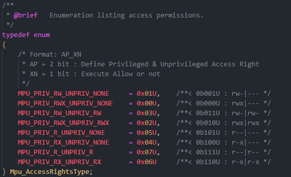

    For one memory section, I want to grant read-write access for privileged mode and read-only access for unprivileged mode (rw-|r--).
    However, I don’t see any permission option like this in the source code generated by the YTConfig Tool.496d9aea-f9e4-4d33-a28e-d30ea595d4f1-image.png

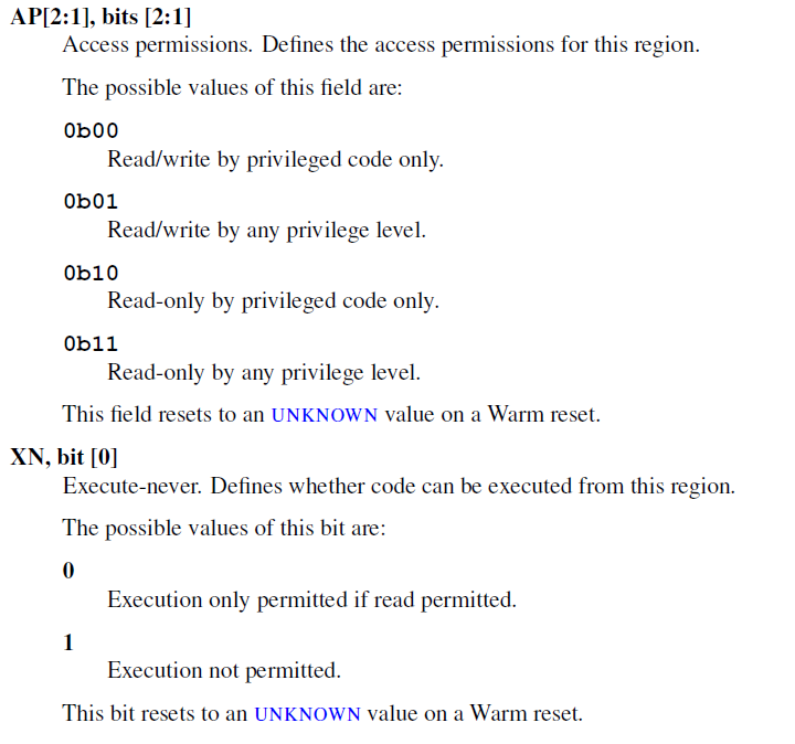

    I also checked the ARMv8-M documentation, and it seems that this kind of permission is not directly supported.22a54749-f50a-4e8d-859b-7eeeb5fbf8b8-image.png

      ARMv8 can't support your case.
      If set AP = 0b00, only privaleged code can read/write memory, user mode can't read or write;
      If set AP = 0b01, any privaleged code can read/write memory, user mode also;

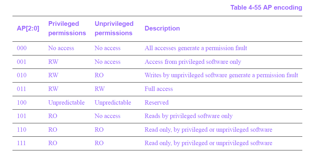

          ARMv7 can support your case. YTM32B1HA01's core is CORTEX-M7 with ARMv7.
