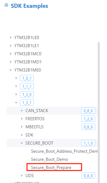

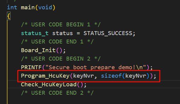

      • ganyongchaoG 离线
        ganyongchaoG 离线
        ganyongchao YunTu
        Secure_Boot_Prepare里面有个HCU KEY的灌装参考下
