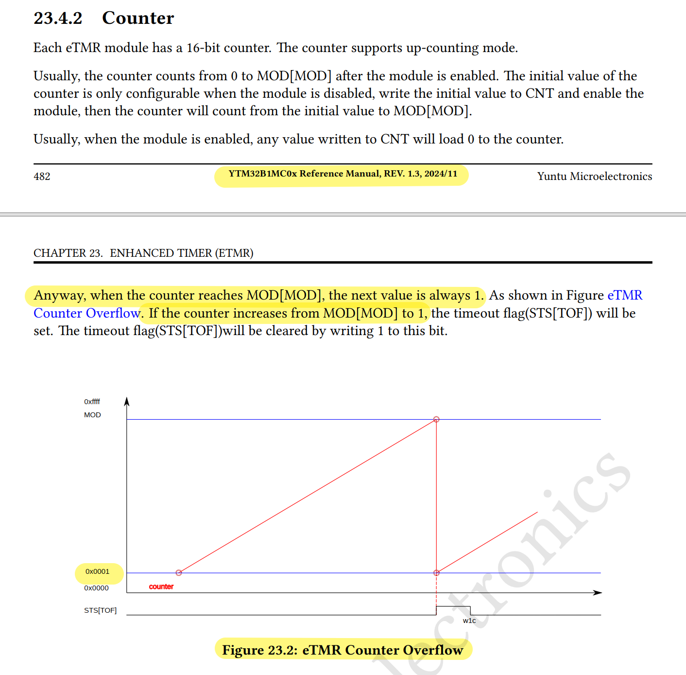

      MC0的eTMR模块的计数器是从1或者INIT+1开始计数的,而不是从0开始计数,
      因此,在左对齐模式下,要其输出0%的占空比,需要配置VAL0= MOD + 1,VAL1=MOD, 示例代码如下:
             if (0U == DutyCycleTick)
                  Base->CH[Channel].VAL0 = Base->MOD + 1U;
                  Base->CH[Channel].VAL1 = Base->MOD;
              else
                  Base->CH[Channel].VAL0 = eTMR_INIT_VALUE;
                  Base->CH[Channel].VAL1 = DutyCycleTick;
                          else
