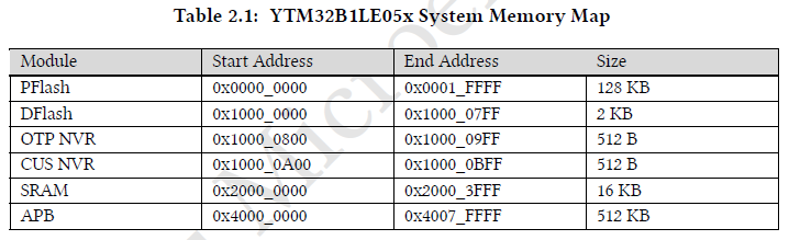

    As reference on RM, we have Dflash

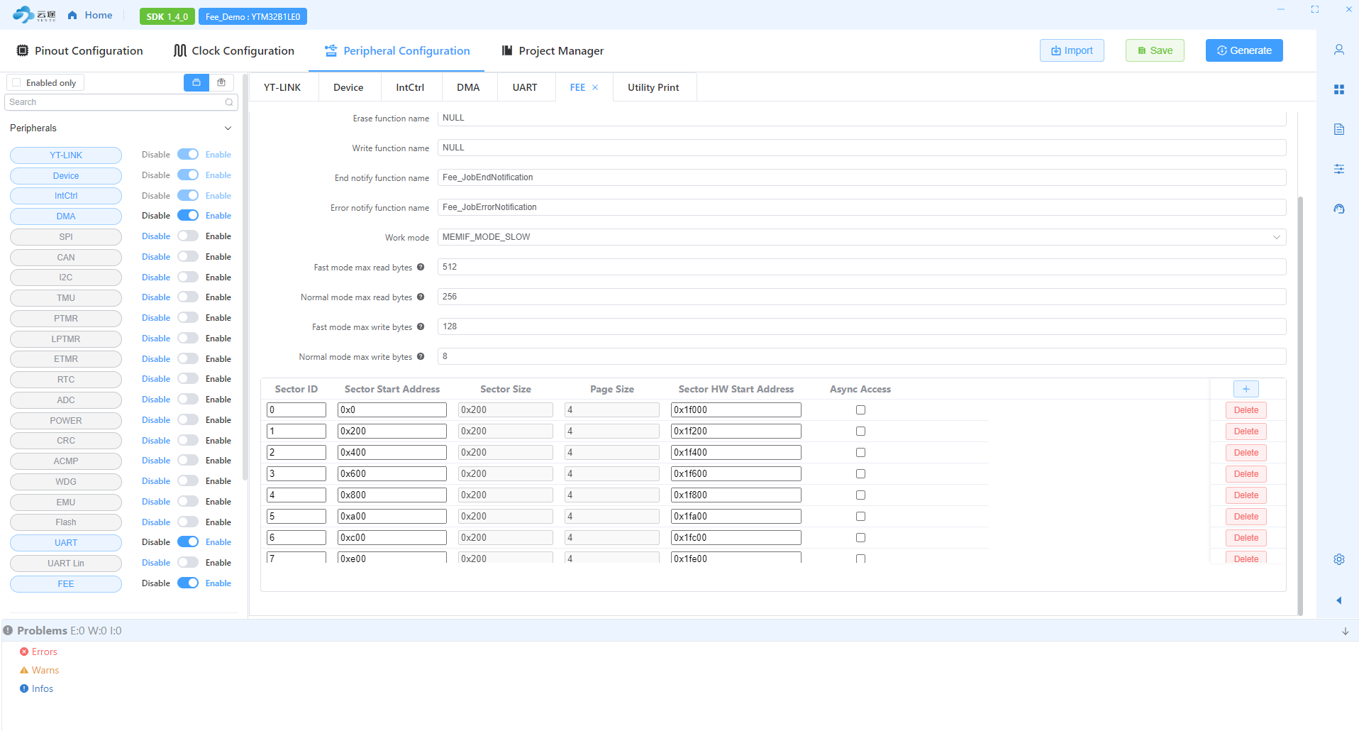

    As Fee demo SW is created for the end of PFlash memory
    Could we adapted it for DFlash memory?

      nguyph18 Yes, if 2K is enough.
