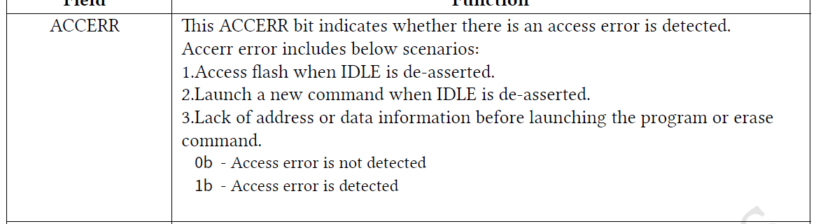

    读取NVR中的温度C值出现了ACCERR,这个可能啥原因导致的?
    static uint32_t SafMgrUser_ReadOptNvr(uint32_t Address)
        uint32_t u32Data = 0U;
        /* Step 0: Wait for IDLE flag to be set */
        while (0U == (EFM->STS & (EFM_STS_IDLE_MASK)))
            /* wait */
        /* Enter Fls critical section to prevent concurrent EFM access */
        SchM_Enter_Fls_FLS_EXCLUSIVE_AREA_07();
        /* Add NOP command to clear write buffer */
        EFM->CMD = 0;
        /* Step 1: Clear error status of EFM STS register */
        EFM->STS = EFM_STS_FAIL_MASK |
                    EFM_STS_ACCERR_MASK |
                    EFM_STS_UNRECOVERR_MASK |
                    EFM_STS_RECOVERR_MASK |
                    EFM_STS_DONE_MASK;
    #if (PLATFORM_MPU_CFG == STD_ON)
        ARM_MPU_Disable();
    #endif
        /* Step 2: Set the address that needs to be read in the NVR_ADDR register */
        EFM->NVR_ADDR = Address;
        ARM_MPU_Enable(MPU_CTRL_PRIVDEFENA_Msk);
    #endif
        /* Step 3: Write 0xFD9573F5 to CMD_UNLOCK to unlock the command */
        EFM->CMD_UNLOCK = 0xFD9573F5U;
        /* Step 4: Set Read NVR command (0x42) in CMD register */
        EFM->CMD = 0x42U;
        /* Exit Fls critical section */
        SchM_Exit_Fls_FLS_EXCLUSIVE_AREA_07();
        /* Step 5: Wait for DONE flag to be set */
        while (0U == (EFM->STS & (EFM_STS_DONE_MASK)))
            /* wait */
        /* Step 6: Read NVR_DATA0 and NVR_DATA1 */
        if (0U == (EFM->STS & EFM_STS_ACCERR_MASK))
            u32Data = EFM->NVR_DATA[0];
            /* NVR_DATA[1] also available if needed */
        return u32Data;
      读的哪个地址时候出错的

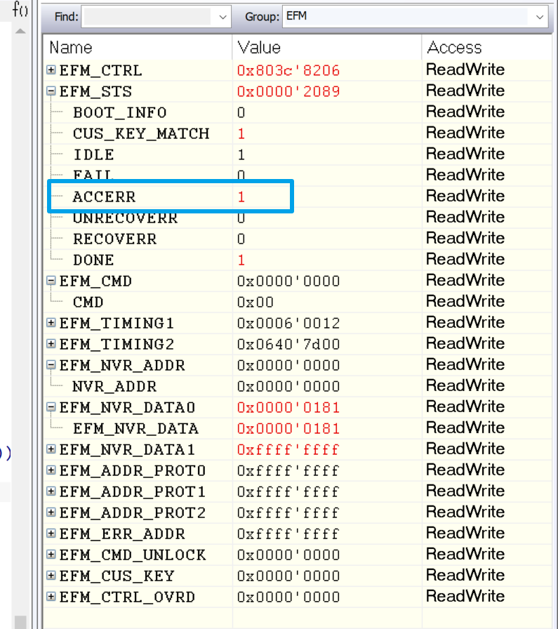

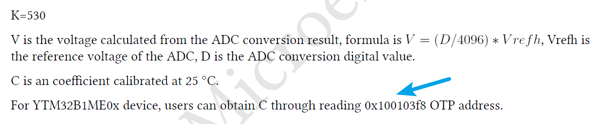

        Diga 0x100103f8UL

              从你的NVR_addr来看是0地址,可能传参出问题了,你这里改成绝对地址或者把传参的变量搞成全局看看

                tx007007 这个估计是因为断点打的位置在Step6。实际上DATA0是能读到C值的,但是就是会出这个错误。我是直接使用的SafMgrUser_ReadOptNvr(0x100103f8UL)读取的。
