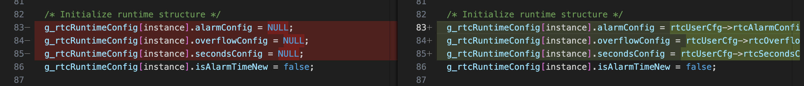

    在SDK的RTC驱动存在一个BUG,公司生产项目有遇到,最近发现新版本SDK还没修复。
    主要问题是RTC_DRV_IRQHandler中没有对alarm触发且alarmConfig为NULL的情况做处理,然后会一直触发RTC中断,最终导致MCU看门狗复位(复位也不会恢复,会一直持续复位)。
    复现流程:
    • 正常上电
    • 设置RTC闹钟
    • 在RTC闹钟触发前软复位MCU(会导致alarmConfig变为NULL)
    • 到RTC闹钟时间时会一直进RTC中断
    • 看门狗复位
    代码位置:
    void RTC_DRV_IRQHandler(uint32_t instance)
        DEV_ASSERT(instance < RTC_INSTANCE_COUNT);
        uint32_t tempSeconds;
        /* Get the alarm configuration */
        rtc_alarm_config_t *alarmConfig = g_rtcRuntimeConfig[instance].alarmConfig;
        /* Get the fault interrupt configuration */
        const rtc_overflow_config_t *const overflowConfig = g_rtcRuntimeConfig[instance].overflowConfig;
        /* Check if an alarm has occurred */
        if (RTC_GetTimeAlarmFlag(g_rtcBase[instance]) == true)
            /* If the alarm interrupt configuration has been defined process the
             * alarm IRQ
            if ((alarmConfig != NULL))
                /* If recurrence is enabled modify the alarm register to the next
                 * alarm.
                if ((alarmConfig->numberOfRepeats > 0UL) || (alarmConfig->repeatForever == true))
                    /* Get current time */
                    tempSeconds = RTC_GetTimeSecondsRegister(g_rtcBase[instance]);
                    /* Current time is incremented with the repetition value */
                    tempSeconds += alarmConfig->repetitionInterval - 1UL;
                    /* Set new value to trigger the alarm */
                    RTC_SetTimeAlarmRegister(g_rtcBase[instance], tempSeconds);
                    g_rtcRuntimeConfig[instance].isAlarmTimeNew = true;
                    /* If the alarm repeats forever, set number of repeats to 0
                     * to avoid an accidental trigger of the core overflow flag
                    alarmConfig->numberOfRepeats = (alarmConfig->repeatForever == false) ? (alarmConfig->numberOfRepeats -
                                                                                            1UL) : 0UL;
                } else
                    /* If the alarm does not repeat, write 0 to ALM to clear the
                     * alarm flag.
                    RTC_SetTimeAlarmRegister(g_rtcBase[instance], 0UL);
                    /* Set the internal variable which indicates that a new alarm is enabled to false */
                    g_rtcRuntimeConfig[instance].isAlarmTimeNew = false;
                /* If the user has defined a callback, call it */
                if (alarmConfig->rtcAlarmCallback != NULL)
                    alarmConfig->rtcAlarmCallback(alarmConfig->callbackParams);
            // 这里else 分支没有处理
            /* If the IRQ is not caused by the alarm then call the user callback if
             * defined.
        else if (overflowConfig != NULL)
            if (overflowConfig->rtcOverflowCallback != NULL)
                /* Call the RTC interrupt callback function with callback parameter */
                overflowConfig->rtcOverflowCallback(overflowConfig->callbackParams);
        } else
            /* Do nothing*/
    修复方案:
    补充else分支,清除RTC闹钟
    diff --git a/platform/drivers/src/rtc/rtc_driver.c b/platform/drivers/src/rtc/rtc_driver.c
    index 439a400..512f49a 100644
    --- a/platform/drivers/src/rtc/rtc_driver.c
    +++ b/platform/drivers/src/rtc/rtc_driver.c
    @@ -736,6 +736,14 @@ void RTC_DRV_IRQHandler(uint32_t instance)
    +        } else
    +            /* If the alarm interrupt configuration is NULL (it may happen if the
    +             * alarm is not arrived but the chip has been reset by any reason),
    +             * So we should write 0 to ALM to clear the alarm flag */
    +            RTC_SetTimeAlarmRegister(g_rtcBase[instance], 0UL);
    +            /* Set the internal variable which indicates that a new alarm is enabled to false */
    +            g_rtcRuntimeConfig[instance].isAlarmTimeNew = false;

      这个问题出现的原因是RTC不同中断共用相同向量号导致函数未注册时候被异常触发,可以通过如下方式进行修复:
      改问题在新版本中修复(新版本尚在发布流程中)

        RTC的寄存器在不断电复位是会保持的,也就是说会继续之前的配置工作,demo的使用方法是先deinit,再init
        oneiotworldO 1 条回复 最后回复
        • oneiotworldO 离线
          oneiotworldO 离线
          四海万联
          在 回复了 qinzhao 最后由 编辑
          qinzhao 您说的deinit再init是在MCU启动时初始化吧,但是如果中断是在那之前触发(应该有概率出现?),是否也一样会一直进中断,之前也和FAE讨论过这个问题。所以我们的最终方案就是加了else分支,在alarmConfig 为NULL时直接清除寄存器的alarm配置
