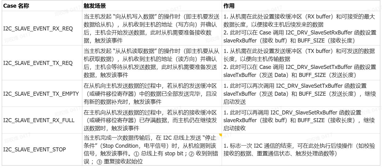

    2. Case 说明
    1. I2C0_SlaveRxCpltCallback 函数
        伪 C 语言代码,直接编译会报错
    void I2C0_SlaveRxCpltCallback(i2c_slave_event_t event, void *userData)
        /* Get the instance number from userData */
        uint32_t instance = 0;
        (void)userData;
        /* Depending on the event received, set the buffers or abort the transfer */
        switch (event)
            case I2C_SLAVE_EVENT_RX_REQ:
                 * If the bus master requests data, then set the destination RX buffer
                 * and accepted transfer size
                  I2C_DRV_SlaveSetRxBuffer(instance, slaveRxBuffer, BUFF_SIZE);
                break;
            case I2C_SLAVE_EVENT_TX_REQ:
                 * If the bus master sends data, then set the source TX buffer
                  I2C_DRV_SlaveSetTxBuffer(instance, slaveTxBuffer, BUFF_SIZE);
                break;
            case I2C_SLAVE_EVENT_TX_EMPTY:
                 * If the TX buffer is empty. Because the example does not handle
                 * this case there is no action taken.
            case I2C_SLAVE_EVENT_RX_FULL:
                 * If the RX buffer is full, check the slave receive buffer is correct
                break;
            case I2C_SLAVE_EVENT_STOP:
                 * This case is used when a stop condition is on the bus. Because
                 * the example does not handle this case there is no action taken.
                break;

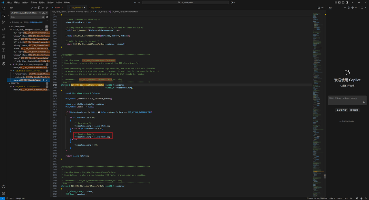

    3. 获取接收 Data 的个数
    1. 使用 I2C_DRV_SlaveGetTransferStatus 函数可以获取 Data 接收的个数,I2C_DRV_SlaveSetTxBuffer 函数的第三个参数是当前 rxSize 的剩余长度,接收长度(已知) - bytesRemaining 得到当前接收了多少字节
