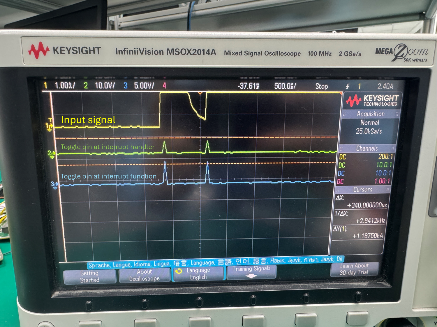

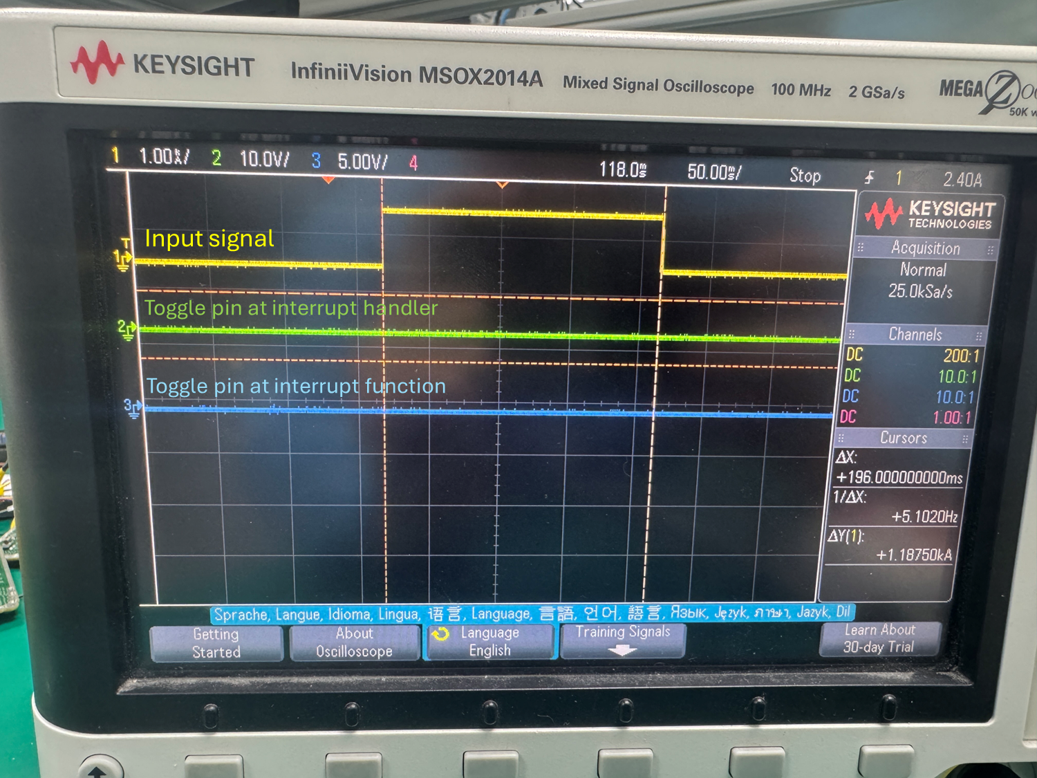

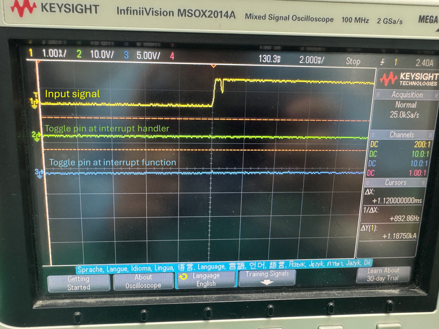

    Hello all,
    I’ve recently observed an issue related to the eTMR interrupt.
    When the MCU is running and I provide a PWM input, sometimes the interrupt does not occur at the edge transition as expected.
    Below are pictures illustrating both the normal and abnormal cases for reference.
    Normal case:

    Abnormal case 2:
    Could you please provide some advice on this issue?
