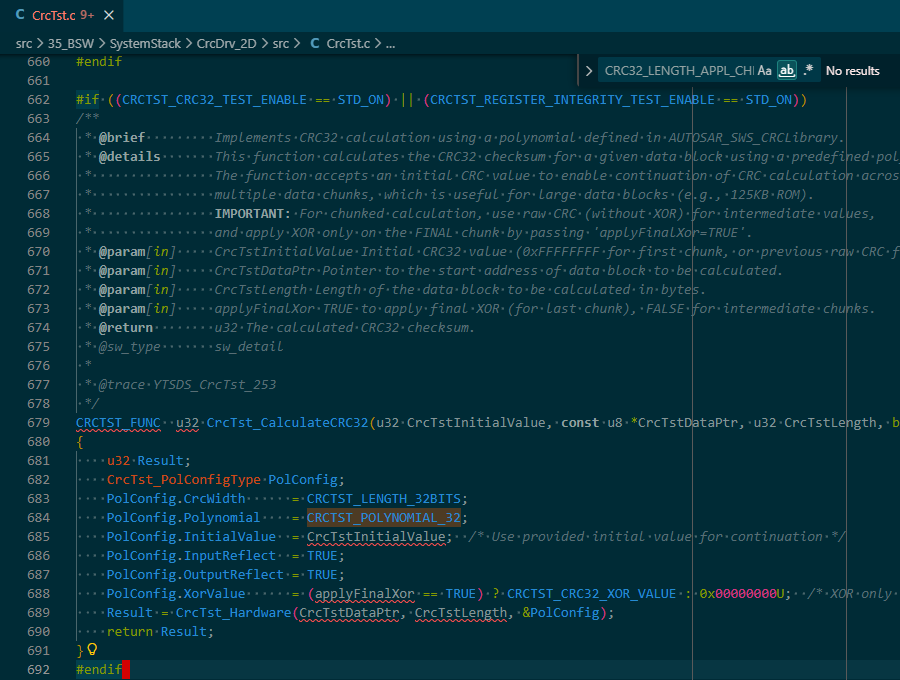

    • D 离线
      D 离线
      Our hardware CRC32 may require a ByteSwap of uint32 values when passing arrays as arguments. The hardware CRC should be big-endian aligned.
