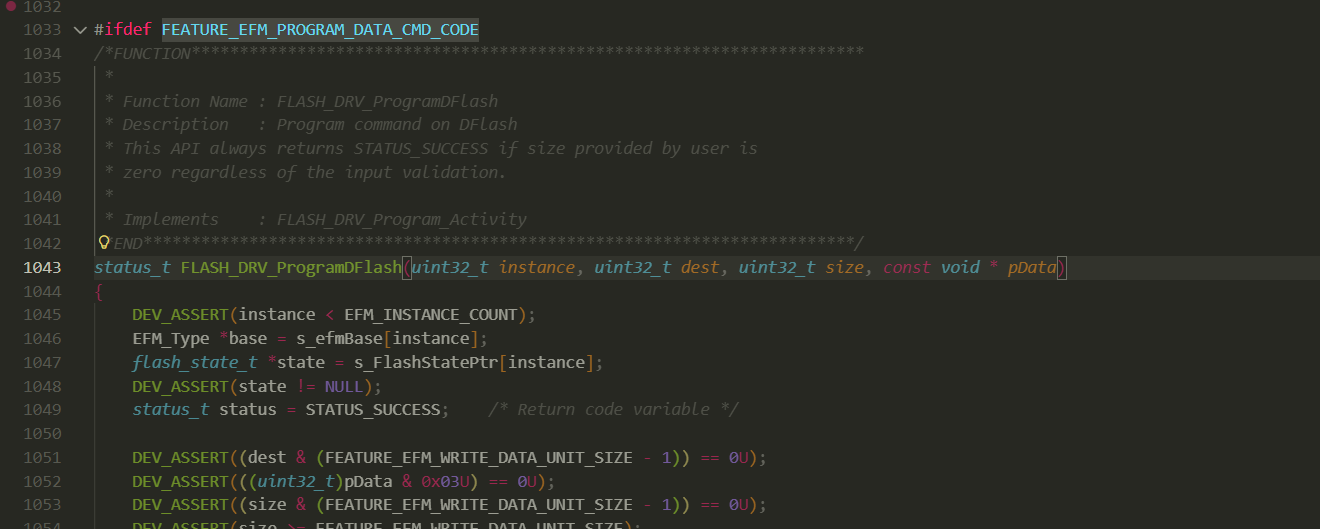

    As I using the example code for FLASH
    The geranated code only has the PFLASH API. for APIs for DFLASH was marked with a macro "FEATURE_EFM_PROGRAM_DATA_CMD_CODE"
    to use these API for DFLASH, do I have to do any configuration in the YT Config Tool? or just simply enable the macro to turn on the APIs?
    Thank you

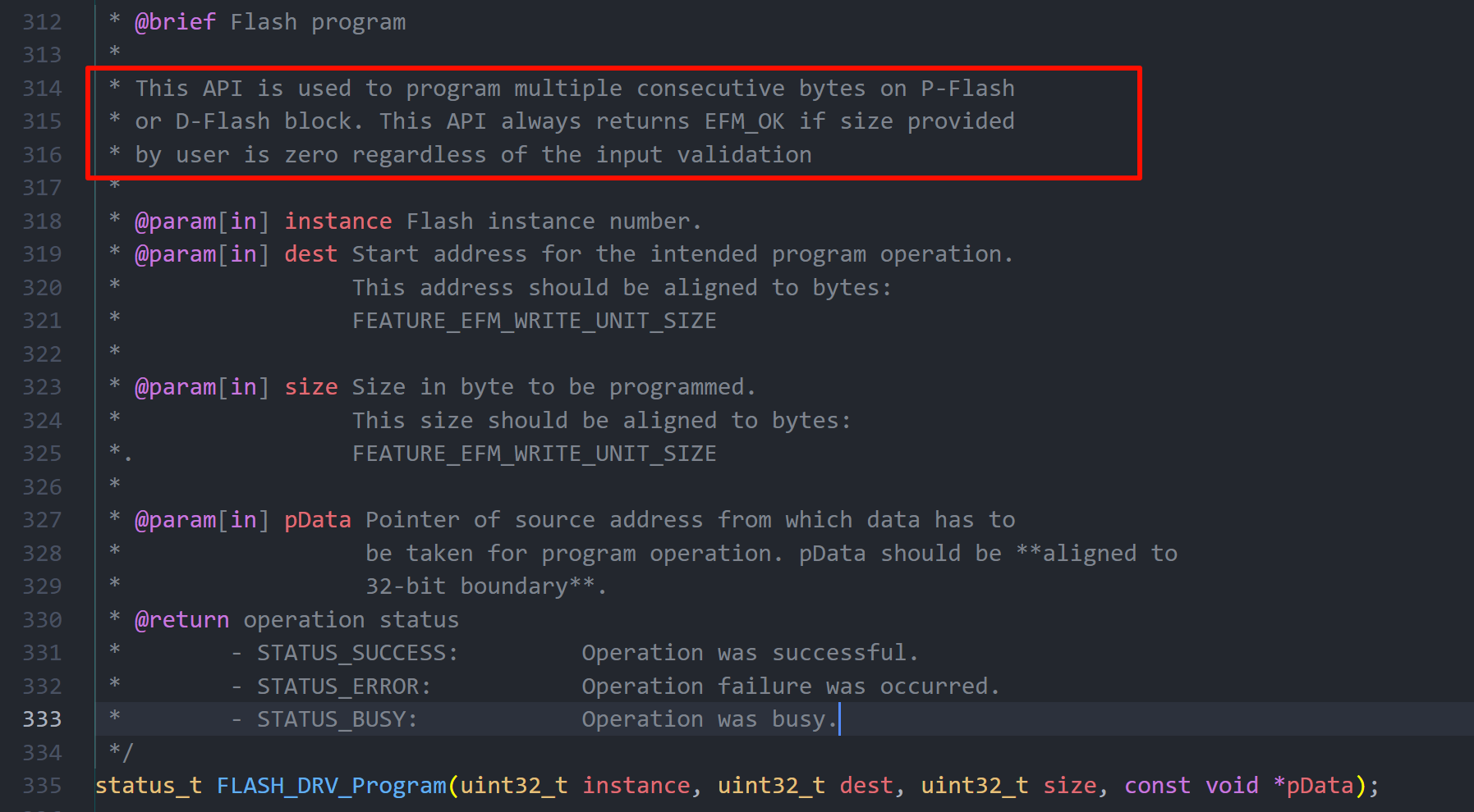

      You can use the FLASH_DRV_Program interface to operate the D-Flash.
