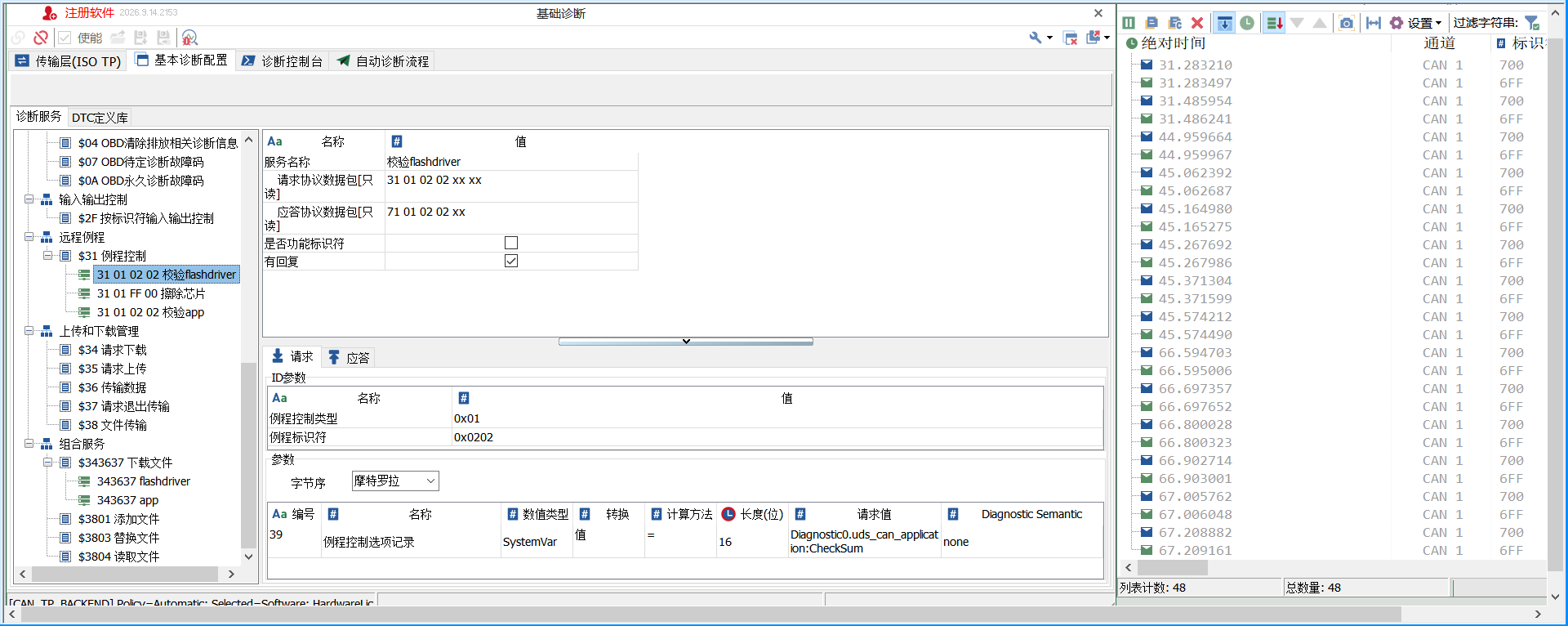

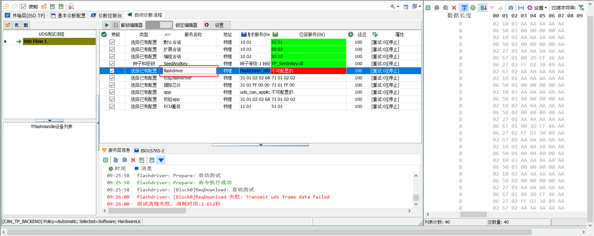

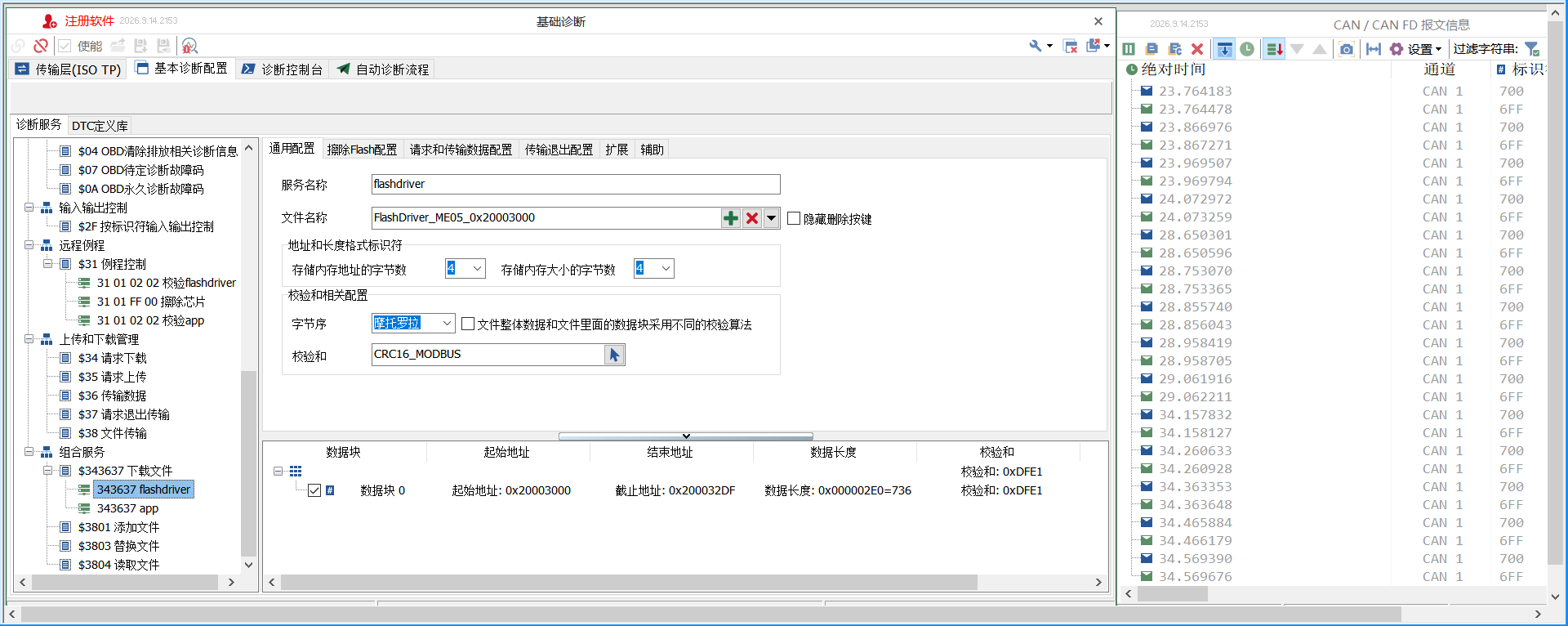

<?xml version="1.0" encoding="UTF-8"?><rss xmlns:dc="http://purl.org/dc/elements/1.1/" xmlns:content="http://purl.org/rss/1.0/modules/content/" xmlns:atom="http://www.w3.org/2005/Atom" version="2.0"><channel><title><![CDATA[UDS下载例程跑不通，一直卡在flashdriver]]></title><description><![CDATA[<p dir="auto"><img src="https://yt-static-main.oss-cn-shanghai.aliyuncs.com/nodebb/1067/1da39fc7-b9f1-47a4-8add-c6650e9c8ba6.png" alt="113d88b482fcde05ce846b6edf73eece.png" class=" img-fluid img-markdown" /> <img src="https://yt-static-main.oss-cn-shanghai.aliyuncs.com/nodebb/1067/942e21a7-2240-4c67-a356-0f815c9bbb31.png" alt="815e55048d39ae6cb51a1ff9845273c8.png" class=" img-fluid img-markdown" /> <img src="https://yt-static-main.oss-cn-shanghai.aliyuncs.com/nodebb/1067/b44ebe08-161a-4e98-b2a2-1a65475adf86.png" alt="df95a6c06a90374515f95cbca02aa174.png" class=" img-fluid img-markdown" /> <img src="https://yt-static-main.oss-cn-shanghai.aliyuncs.com/nodebb/1067/bf080191-5d4f-405e-9dd0-30e59fef10a6.jpg" alt="f4681cf4fd63df666eaaf1a4c28b25cd.jpg" class=" img-fluid img-markdown" /> <img src="https://yt-static-main.oss-cn-shanghai.aliyuncs.com/nodebb/1067/c5affa0d-eff8-46b4-a716-6b27d1260bf3.jpg" alt="aa50ad943f7c763898324324a8516794.jpg" class=" img-fluid img-markdown" /></p>

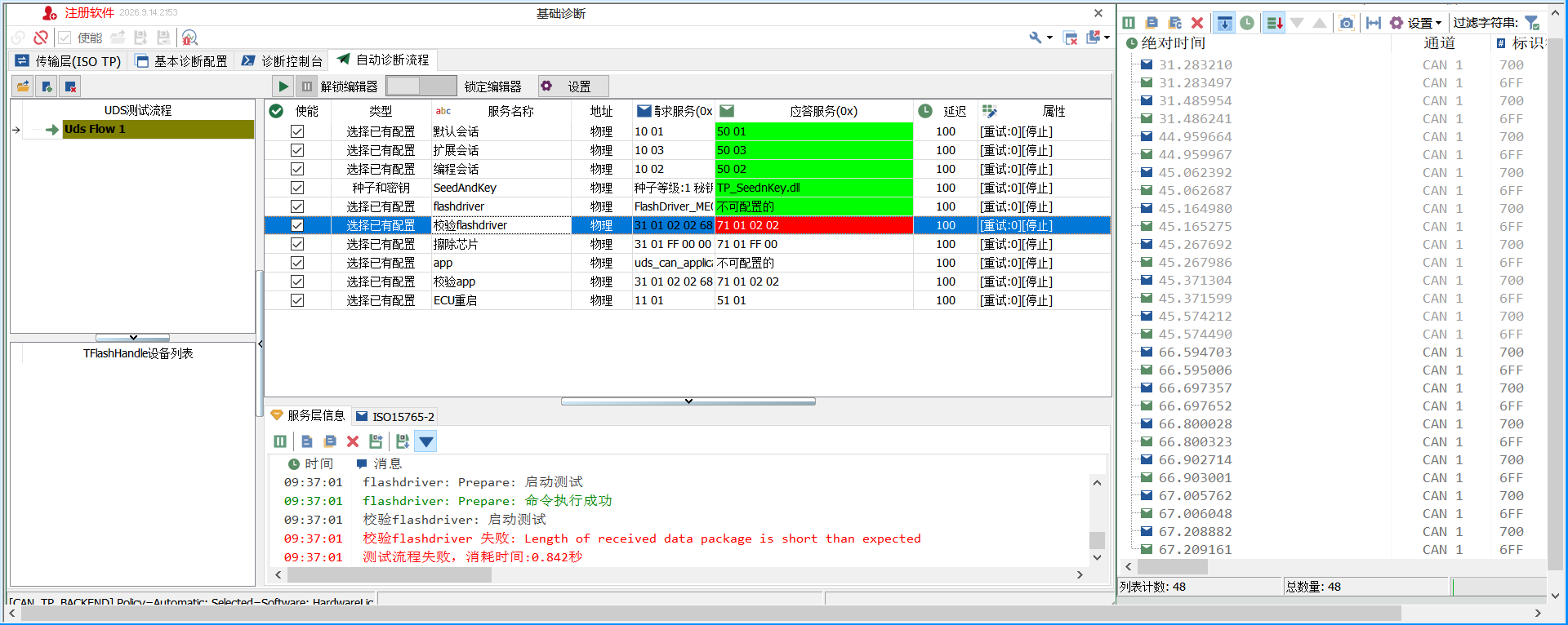

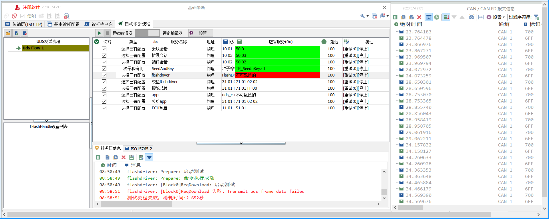

]]></description><link>https://forum.ytmicro.com/topic/2330/uds下载例程跑不通-一直卡在flashdriver</link><generator>RSS for Node</generator><lastBuildDate>Fri, 30 Oct 2026 10:03:20 GMT</lastBuildDate><atom:link href="https://forum.ytmicro.com/topic/2330.rss" rel="self" type="application/rss+xml"/><pubDate>Fri, 30 Oct 2026 01:15:05 GMT</pubDate><ttl>60</ttl><item><title><![CDATA[Reply to UDS下载例程跑不通，一直卡在flashdriver on Fri, 30 Oct 2026 01:37:54 GMT]]></title><description><![CDATA[<p dir="auto"><a class="plugin-mentions-user plugin-mentions-a" href="https://forum.ytmicro.com/uid/1026">yangke</a> <img src="https://yt-static-main.oss-cn-shanghai.aliyuncs.com/nodebb/1067/8b34ccc4-bc2d-4490-93f5-b4e966458d9c.png" alt="68cc60cf-9061-4fe1-a902-01787d584523-image.png" class=" img-fluid img-markdown" /> 可以了，但是又卡在校验，校验也重新选了<img src="https://yt-static-main.oss-cn-shanghai.aliyuncs.com/nodebb/1067/51443854-1f52-4375-a81a-5b72f42b3713.png" alt="d4db126d-9da0-4672-9613-e4bfc0f5df80-image.png" class=" img-fluid img-markdown" /></p>
]]></description><link>https://forum.ytmicro.com/post/10009</link><guid isPermaLink="true">https://forum.ytmicro.com/post/10009</guid><dc:creator><![CDATA[Odin]]></dc:creator><pubDate>Fri, 30 Oct 2026 01:37:54 GMT</pubDate></item><item><title><![CDATA[Reply to UDS下载例程跑不通，一直卡在flashdriver on Fri, 30 Oct 2026 01:32:07 GMT]]></title><description><![CDATA[<p dir="auto">界面上解锁编辑器试试</p>
]]></description><link>https://forum.ytmicro.com/post/10008</link><guid isPermaLink="true">https://forum.ytmicro.com/post/10008</guid><dc:creator><![CDATA[yangke]]></dc:creator><pubDate>Fri, 30 Oct 2026 01:32:07 GMT</pubDate></item><item><title><![CDATA[Reply to UDS下载例程跑不通，一直卡在flashdriver on Fri, 30 Oct 2026 01:28:26 GMT]]></title><description><![CDATA[<p dir="auto"><a class="plugin-mentions-user plugin-mentions-a" href="https://forum.ytmicro.com/uid/1026">yangke</a> <img src="https://yt-static-main.oss-cn-shanghai.aliyuncs.com/nodebb/1067/e027351b-fa8c-4472-9a42-f5cb6c03f1e2.png" alt="1f7c7e99-b996-432d-adc3-93027f451768-image.png" class=" img-fluid img-markdown" /> 双击没反应</p>
]]></description><link>https://forum.ytmicro.com/post/10007</link><guid isPermaLink="true">https://forum.ytmicro.com/post/10007</guid><dc:creator><![CDATA[Odin]]></dc:creator><pubDate>Fri, 30 Oct 2026 01:28:26 GMT</pubDate></item><item><title><![CDATA[Reply to UDS下载例程跑不通，一直卡在flashdriver on Fri, 30 Oct 2026 01:24:35 GMT]]></title><description><![CDATA[<p dir="auto">TSmaster自动诊断流程的编辑打开，在服务名称那一列双击flashdriver添加上去</p>
]]></description><link>https://forum.ytmicro.com/post/10006</link><guid isPermaLink="true">https://forum.ytmicro.com/post/10006</guid><dc:creator><![CDATA[yangke]]></dc:creator><pubDate>Fri, 30 Oct 2026 01:24:35 GMT</pubDate></item></channel></rss>
