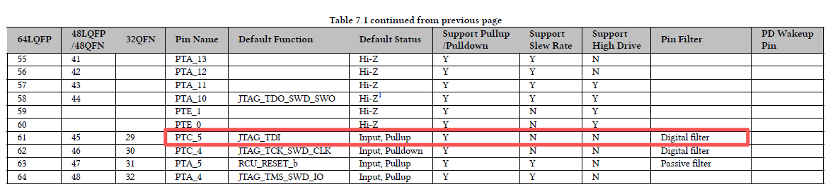

<img src="https://yt-static-main.oss-cn-shanghai.aliyuncs.com/nodebb/1026/7a8c0df4-00ce-4bdd-86b9-c9ad09c532e7.png" alt="image.png" class=" img-fluid img-markdown" /></p>

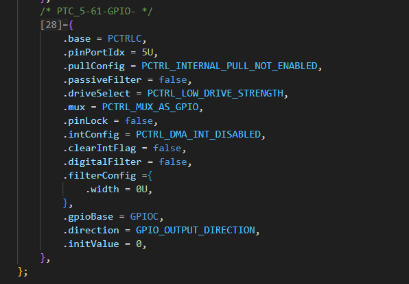

]]></description><link>https://forum.ytmicro.com/post/9994</link><guid isPermaLink="true">https://forum.ytmicro.com/post/9994</guid><dc:creator><![CDATA[yangke]]></dc:creator><pubDate>Mon, 26 Oct 2026 07:29:02 GMT</pubDate></item><item><title><![CDATA[Reply to MC03芯片的PTC5引脚初始化配置输出低电平，在上电后出现一段高电平是怎么回事？ on Mon, 26 Oct 2026 07:27:30 GMT]]></title><description><![CDATA[<p dir="auto"><img src="https://yt-static-main.oss-cn-shanghai.aliyuncs.com/nodebb/1438/969a959d-24f5-410f-bb60-93b82a39a6de.png" alt="65ea695b536f0f6eafd0d3bc1e9b8b57.png" class=" img-fluid img-markdown" /></p>

]]></description><link>https://forum.ytmicro.com/post/9991</link><guid isPermaLink="true">https://forum.ytmicro.com/post/9991</guid><dc:creator><![CDATA[yangke]]></dc:creator><pubDate>Mon, 26 Oct 2026 07:24:43 GMT</pubDate></item></channel></rss>
