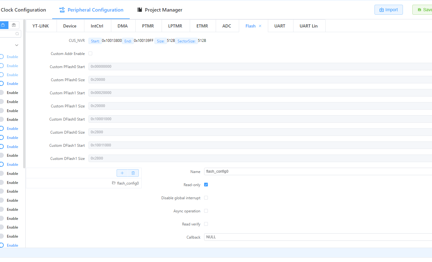

<?xml version="1.0" encoding="UTF-8"?><rss xmlns:dc="http://purl.org/dc/elements/1.1/" xmlns:content="http://purl.org/rss/1.0/modules/content/" xmlns:atom="http://www.w3.org/2005/Atom" version="2.0"><channel><title><![CDATA[增加Flash模块编译错误]]></title><description><![CDATA[<p dir="auto"><img src="https://yt-static-main.oss-cn-shanghai.aliyuncs.com/nodebb/62/8bf958ef-053c-4ef8-b951-b0cd590e9aa6.png" alt="bd60fd0b-14d9-45f8-a9a6-6534beaa827d-image.png" class=" img-fluid img-markdown" /> 打开该模块之后出现编报错</p>
<p dir="auto"><img src="https://yt-static-main.oss-cn-shanghai.aliyuncs.com/nodebb/62/f4ead98f-32da-45c4-94e1-4a5199597100.png" alt="96c19e26-b53c-48d6-b455-a98e41e77560-image.png" class=" img-fluid img-markdown" /> 帮忙看下是为啥<a href="https://yt-static-main.oss-cn-shanghai.aliyuncs.com/nodebb/62/5ec8d088-aac8-4dea-8995-c4c188ea13d4.yct" rel="nofollow ugc">project.yct</a></p>

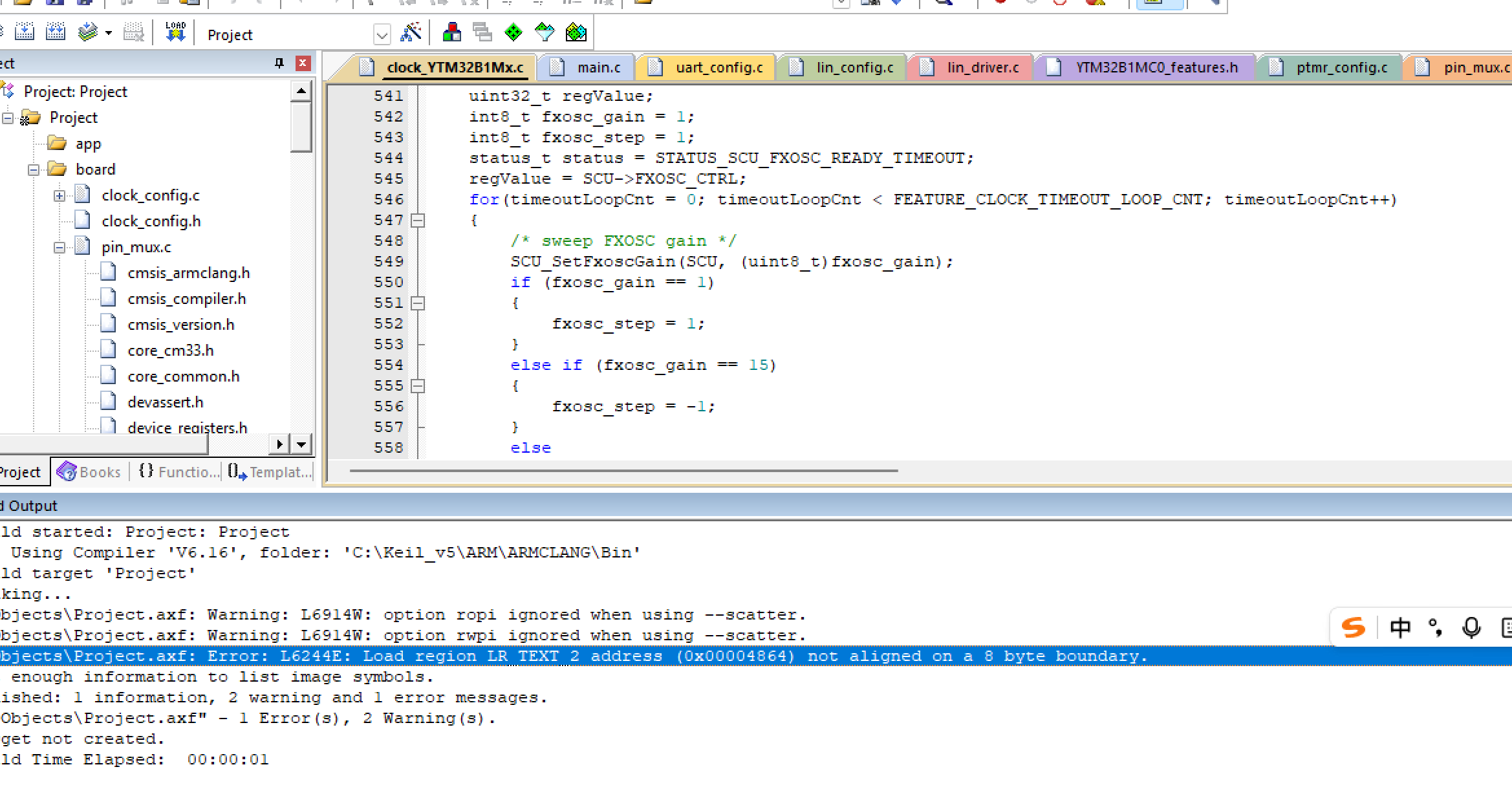

]]></description><link>https://forum.ytmicro.com/topic/2324/增加flash模块编译错误</link><generator>RSS for Node</generator><lastBuildDate>Mon, 26 Oct 2026 09:29:51 GMT</lastBuildDate><atom:link href="https://forum.ytmicro.com/topic/2324.rss" rel="self" type="application/rss+xml"/><pubDate>Mon, 26 Oct 2026 03:36:24 GMT</pubDate><ttl>60</ttl><item><title><![CDATA[Reply to 增加Flash模块编译错误 on Mon, 26 Oct 2026 05:57:02 GMT]]></title><description><![CDATA[<p dir="auto">把linker里面的LR_TEXT_2 0x400 + ImageLength(LR_TEXT_0) + ImageLength(LR_TEXT_1)改成LR_TEXT_2 AlignExpr(0x400 + ImageLength(LR_TEXT_0) + ImageLength(LR_TEXT_1), 8)试试</p>

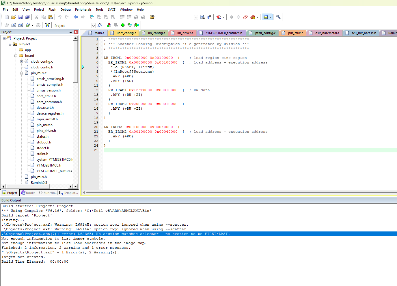

]]></description><link>https://forum.ytmicro.com/post/9985</link><guid isPermaLink="true">https://forum.ytmicro.com/post/9985</guid><dc:creator><![CDATA[车友车行]]></dc:creator><pubDate>Mon, 26 Oct 2026 05:57:02 GMT</pubDate></item><item><title><![CDATA[Reply to 增加Flash模块编译错误 on Mon, 26 Oct 2026 05:50:42 GMT]]></title><description><![CDATA[<p dir="auto"><img src="https://yt-static-main.oss-cn-shanghai.aliyuncs.com/nodebb/62/435d7fa8-a5eb-48a9-8672-b35e4522bcef.png" alt="image.png" class=" img-fluid img-markdown" />之前试过，但是会报这个错误，然后我把yt_linker给改了，现在好了，但是不知道会不会有隐患</p>

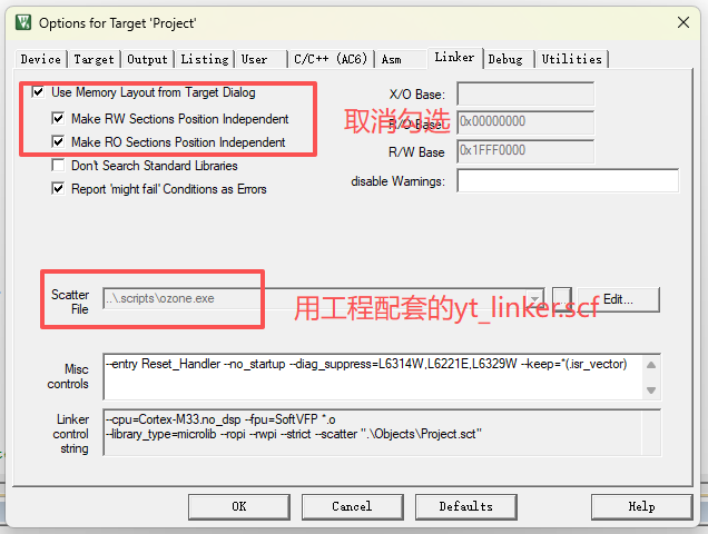

]]></description><link>https://forum.ytmicro.com/post/9983</link><guid isPermaLink="true">https://forum.ytmicro.com/post/9983</guid><dc:creator><![CDATA[车友车行]]></dc:creator><pubDate>Mon, 26 Oct 2026 05:45:00 GMT</pubDate></item><item><title><![CDATA[Reply to 增加Flash模块编译错误 on Mon, 26 Oct 2026 05:35:37 GMT]]></title><description><![CDATA[<p dir="auto"><img src="https://yt-static-main.oss-cn-shanghai.aliyuncs.com/nodebb/62/b6c04b1f-8ec7-45cc-aba8-72c539f5e7de.png" alt="image.png" class=" img-fluid img-markdown" /></p>

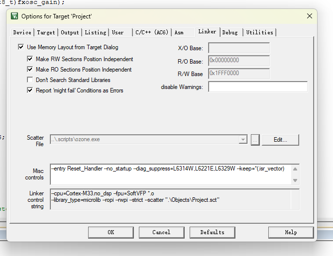

]]></description><link>https://forum.ytmicro.com/post/9982</link><guid isPermaLink="true">https://forum.ytmicro.com/post/9982</guid><dc:creator><![CDATA[kassel]]></dc:creator><pubDate>Mon, 26 Oct 2026 05:35:37 GMT</pubDate></item><item><title><![CDATA[Reply to 增加Flash模块编译错误 on Mon, 26 Oct 2026 05:25:54 GMT]]></title><description><![CDATA[<p dir="auto">我这边编译没有报错，你的Options for Target → Linker配置截图看看呢</p>
]]></description><link>https://forum.ytmicro.com/post/9981</link><guid isPermaLink="true">https://forum.ytmicro.com/post/9981</guid><dc:creator><![CDATA[车友车行]]></dc:creator><pubDate>Mon, 26 Oct 2026 05:25:54 GMT</pubDate></item></channel></rss>
