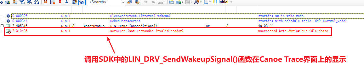

<?xml version="1.0" encoding="UTF-8"?><rss xmlns:dc="http://purl.org/dc/elements/1.1/" xmlns:content="http://purl.org/rss/1.0/modules/content/" xmlns:atom="http://www.w3.org/2005/Atom" version="2.0"><channel><title><![CDATA[发送Lin唤醒脉冲]]></title><description><![CDATA[<p dir="auto"><img src="https://yt-static-main.oss-cn-shanghai.aliyuncs.com/nodebb/1781/c1dc1b7e-a1d1-43f5-a400-d9297878dbd5.png" alt="6b0d1462-ed44-453f-b874-90fe74660d0e-image.png" class=" img-fluid img-markdown" /></p>
<p dir="auto">上图是我每隔2s调用SDK中的LIN_DRV_SendWakeupSignal()在Canoe界面上显示，为什么canoe显示不是“wakeup Signal”而是"RcvError"，我需要再调用什么SDK函数吗？</p>
<p dir="auto">使用的SDK名称：YTM32B1MC0_1_4_1</p>

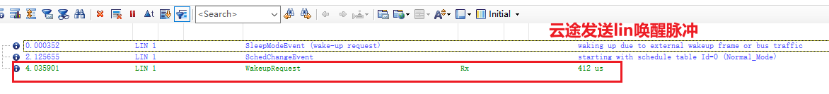

感谢，按您的意思操作后，就解决了</p>
]]></description><link>https://forum.ytmicro.com/post/9976</link><guid isPermaLink="true">https://forum.ytmicro.com/post/9976</guid><dc:creator><![CDATA[HMF]]></dc:creator><pubDate>Sat, 24 Oct 2026 07:28:16 GMT</pubDate></item><item><title><![CDATA[Reply to 发送Lin唤醒脉冲 on Sat, 24 Oct 2026 07:09:32 GMT]]></title><description><![CDATA[<p dir="auto">在调用LIN_DRV_SendWakeupSignal发送唤醒信号时CANoe处于正常通讯的状态，可能将发送的唤醒脉冲按普通通信数据进行了解析，导致报错RcvError</p>
]]></description><link>https://forum.ytmicro.com/post/9975</link><guid isPermaLink="true">https://forum.ytmicro.com/post/9975</guid><dc:creator><![CDATA[yangke]]></dc:creator><pubDate>Sat, 24 Oct 2026 07:09:32 GMT</pubDate></item><item><title><![CDATA[Reply to 发送Lin唤醒脉冲 on Sat, 24 Oct 2026 06:57:53 GMT]]></title><description><![CDATA[<p dir="auto">“每隔2s调用”的原因是我想测试该SDK函数能否发出唤醒信号(“wakeup Signal”)</p>
