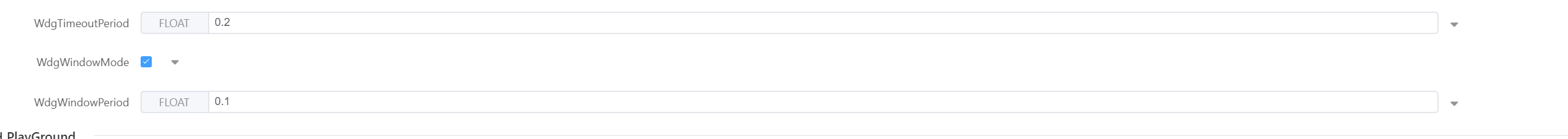

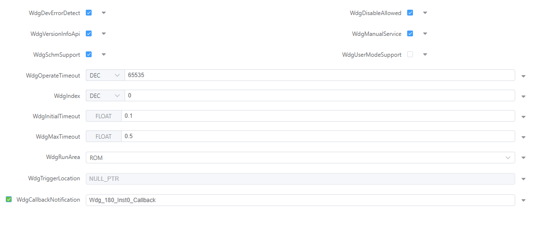

<?xml version="1.0" encoding="UTF-8"?><rss xmlns:dc="http://purl.org/dc/elements/1.1/" xmlns:content="http://purl.org/rss/1.0/modules/content/" xmlns:atom="http://www.w3.org/2005/Atom" version="2.0"><channel><title><![CDATA[YTM32B1ME05窗口看门狗配置]]></title><description><![CDATA[<p dir="auto">我需要配置一个窗口看门狗，时钟需要不同于MCU的参考时钟，窗口时间可调，能选择启用软件锁或硬件锁，开启看门狗中断。<br />
在B1ME05的MCAL环境下，以上需求是否可以通过YCT配置调整生成。<br />
<img src="https://yt-static-main.oss-cn-shanghai.aliyuncs.com/nodebb/1505/f5ddd5b0-65a6-47ac-81ac-a52b285d4ebc.png" alt="70670e3c-056b-4e08-8b3d-7a33845bf5ac-image.png" class=" img-fluid img-markdown" /></p>

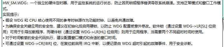

]]></description><link>https://forum.ytmicro.com/post/9924</link><guid isPermaLink="true">https://forum.ytmicro.com/post/9924</guid><dc:creator><![CDATA[步邡]]></dc:creator><pubDate>Fri, 16 Oct 2026 10:05:19 GMT</pubDate></item><item><title><![CDATA[Reply to YTM32B1ME05窗口看门狗配置 on Fri, 16 Oct 2026 08:51:34 GMT]]></title><description><![CDATA[<p dir="auto">参数注释里面有哦，窗口时间是只能在那个时候这个周期喂狗，其他时候喂狗不成功。看门狗超时就是复位时间。看门狗超时包含窗口时间</p>
]]></description><link>https://forum.ytmicro.com/post/9923</link><guid isPermaLink="true">https://forum.ytmicro.com/post/9923</guid><dc:creator><![CDATA[RuiXu]]></dc:creator><pubDate>Fri, 16 Oct 2026 08:51:34 GMT</pubDate></item><item><title><![CDATA[Reply to YTM32B1ME05窗口看门狗配置 on Fri, 16 Oct 2026 08:49:21 GMT]]></title><description><![CDATA[<p dir="auto">那窗口时间和看门狗超时时间有什么关系啊<br />

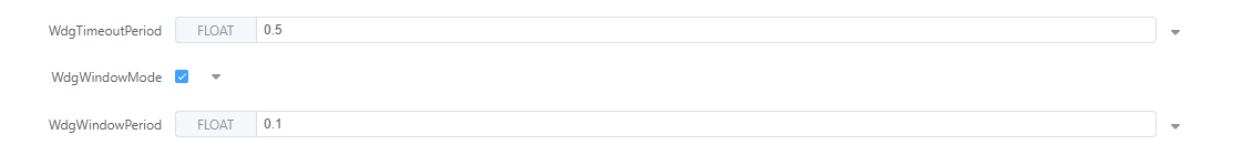

<img src="https://yt-static-main.oss-cn-shanghai.aliyuncs.com/nodebb/1505/658799c0-2027-40bb-91c9-90118f9952f0.png" alt="13069d77-b767-45b3-986b-c77d5f6df9c2-image.png" class=" img-fluid img-markdown" /></p>
]]></description><link>https://forum.ytmicro.com/post/9922</link><guid isPermaLink="true">https://forum.ytmicro.com/post/9922</guid><dc:creator><![CDATA[步邡]]></dc:creator><pubDate>Fri, 16 Oct 2026 08:49:21 GMT</pubDate></item><item><title><![CDATA[Reply to YTM32B1ME05窗口看门狗配置 on Fri, 16 Oct 2026 07:15:45 GMT]]></title><description><![CDATA[<p dir="auto">是的，用的一个中断向量号</p>

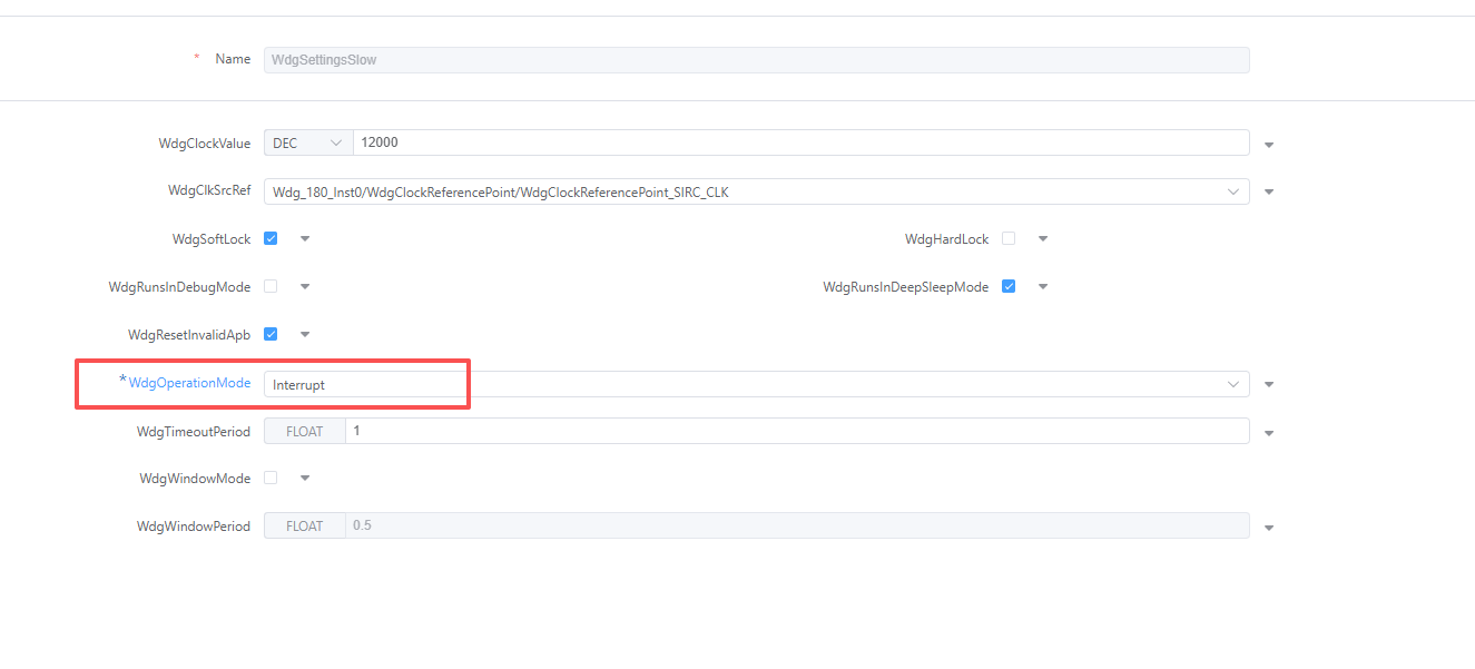

]]></description><link>https://forum.ytmicro.com/post/9921</link><guid isPermaLink="true">https://forum.ytmicro.com/post/9921</guid><dc:creator><![CDATA[RuiXu]]></dc:creator><pubDate>Fri, 16 Oct 2026 07:15:45 GMT</pubDate></item><item><title><![CDATA[Reply to YTM32B1ME05窗口看门狗配置 on Fri, 16 Oct 2026 07:14:59 GMT]]></title><description><![CDATA[<p dir="auto"><img src="https://yt-static-main.oss-cn-shanghai.aliyuncs.com/nodebb/1505/efca9cfe-f068-4afe-89fa-2d1b4253938a.png" alt="image.png" class=" img-fluid img-markdown" /><br />
窗口看门狗和外部看门狗的中断都是这个地方开启吗</p>
]]></description><link>https://forum.ytmicro.com/post/9920</link><guid isPermaLink="true">https://forum.ytmicro.com/post/9920</guid><dc:creator><![CDATA[步邡]]></dc:creator><pubDate>Fri, 16 Oct 2026 07:14:59 GMT</pubDate></item><item><title><![CDATA[Reply to YTM32B1ME05窗口看门狗配置 on Fri, 16 Oct 2026 06:00:35 GMT]]></title><description><![CDATA[<p dir="auto"><img src="https://yt-static-main.oss-cn-shanghai.aliyuncs.com/nodebb/242/6c41a4a2-286d-4d33-afb9-6ef789a96fdd.png" alt="image.png" class=" img-fluid img-markdown" /></p>
]]></description><link>https://forum.ytmicro.com/post/9919</link><guid isPermaLink="true">https://forum.ytmicro.com/post/9919</guid><dc:creator><![CDATA[RuiXu]]></dc:creator><pubDate>Fri, 16 Oct 2026 06:00:35 GMT</pubDate></item><item><title><![CDATA[Reply to YTM32B1ME05窗口看门狗配置 on Fri, 16 Oct 2026 05:59:08 GMT]]></title><description><![CDATA[<p dir="auto"><a class="plugin-mentions-user plugin-mentions-a" href="https://forum.ytmicro.com/uid/242">RuiXu</a> 在 <a href="/post/9917">YTM32B1ME05窗口看门狗配置</a> 中说：</p>

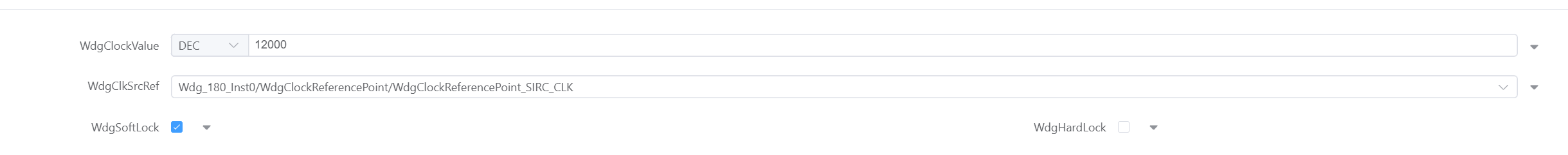

<p dir="auto">好的，配置中断是这里吗，窗口狗的配置选项及窗口的大小应该在哪儿调整呢? 还是说在生成之后的代码里调整?<br />
<img src="https://yt-static-main.oss-cn-shanghai.aliyuncs.com/nodebb/1505/33cbdcd1-33d0-4ed6-a9f3-55e16dae1734.png" alt="843cb0f7-1ac9-4dd1-b655-8b67fc213b1c-image.png" class=" img-fluid img-markdown" /></p>
