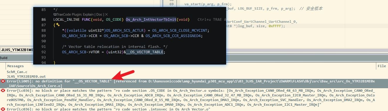

<?xml version="1.0" encoding="UTF-8"?><rss xmlns:dc="http://purl.org/dc/elements/1.1/" xmlns:content="http://purl.org/rss/1.0/modules/content/" xmlns:atom="http://www.w3.org/2005/Atom" version="2.0"><channel><title><![CDATA[ME05 添加autosar os中断向量缺少导致编译不过问题]]></title><description><![CDATA[<p dir="auto">请问 切autosar os 链接文件怎么改！如下图：报错<img src="https://yt-static-main.oss-cn-shanghai.aliyuncs.com/nodebb/1743/fc3b17f0-2ea1-4258-9aa4-3c233171274c.jpg" alt="ad0f06b7-6feb-4acc-a93d-af0a86351a41-26da10c84ef208744b78727e83b2143d.jpg" class=" img-fluid img-markdown" /></p>

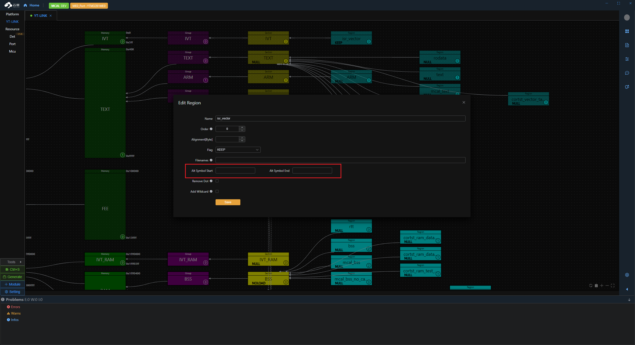

<img src="https://yt-static-main.oss-cn-shanghai.aliyuncs.com/nodebb/1/ba700b21-5404-44af-85b9-f7c32714bde3.png" alt="image.png" class=" img-fluid img-markdown" /></p>
