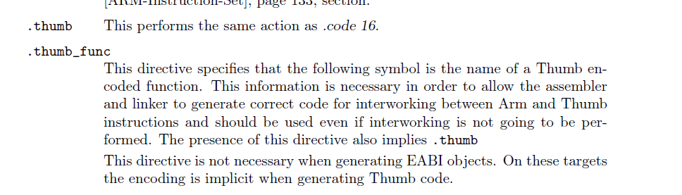

]]></description><link>https://forum.ytmicro.com/post/9794</link><guid isPermaLink="true">https://forum.ytmicro.com/post/9794</guid><dc:creator><![CDATA[番茄+两个蛋]]></dc:creator><pubDate>Wed, 30 Sep 2026 06:37:48 GMT</pubDate></item><item><title><![CDATA[Reply to GCC 15的版本报错 on Wed, 30 Sep 2026 06:30:07 GMT]]></title><description><![CDATA[<p dir="auto"><img src="https://yt-static-main.oss-cn-shanghai.aliyuncs.com/nodebb/1026/8c33f963-abfb-4bb0-90f0-4feb9f2dd9a5.png" alt="image.png" class=" img-fluid img-markdown" /><br />
从GUN资料上看.thumb_func 也隐含了 .thumb</p>
