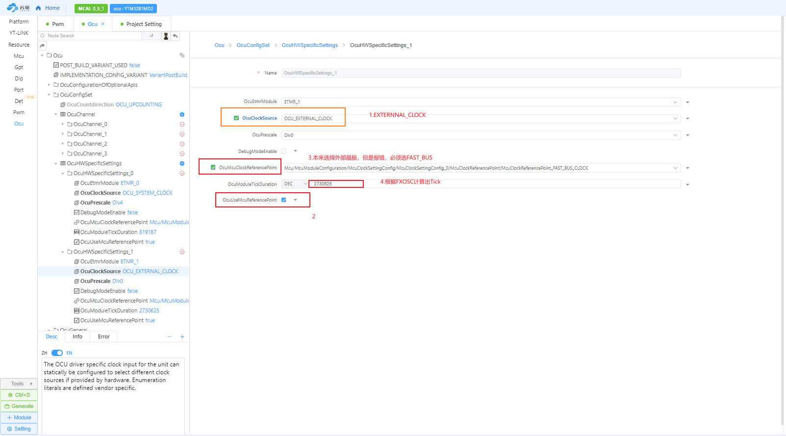

]]></description><link>https://forum.ytmicro.com/topic/2270/calculate报错</link><generator>RSS for Node</generator><lastBuildDate>Tue, 29 Sep 2026 22:45:04 GMT</lastBuildDate><atom:link href="https://forum.ytmicro.com/topic/2270.rss" rel="self" type="application/rss+xml"/><pubDate>Tue, 29 Sep 2026 08:53:37 GMT</pubDate><ttl>60</ttl><item><title><![CDATA[Reply to Calculate报错 on Tue, 29 Sep 2026 09:43:41 GMT]]></title><description><![CDATA[<p dir="auto"><a class="plugin-mentions-user plugin-mentions-a" href="https://forum.ytmicro.com/uid/1652">JETT</a> 在 <a href="/post/9779">Calculate报错</a> 中说：</p>

]]></description><link>https://forum.ytmicro.com/post/9780</link><guid isPermaLink="true">https://forum.ytmicro.com/post/9780</guid><dc:creator><![CDATA[RuiXu]]></dc:creator><pubDate>Tue, 29 Sep 2026 09:43:41 GMT</pubDate></item><item><title><![CDATA[Reply to Calculate报错 on Tue, 29 Sep 2026 09:31:14 GMT]]></title><description><![CDATA[<p dir="auto"><a class="plugin-mentions-user plugin-mentions-a" href="https://forum.ytmicro.com/uid/242">RuiXu</a> 好的，解决了，再问下，如果我OcuHw的eTMR配置选择外部晶振时钟是选择OCU_EXTERNLAL_CLOCK，但是参考时钟必须是FAST_BUS,不然报错，那我是先选择FXOSC，然后calculate出Tick，再改回FAST_BUS消除错误？这样理解吗？<img src="https://yt-static-main.oss-cn-shanghai.aliyuncs.com/nodebb/1652/edae9a01-9eea-43de-8c1a-bf13ca478a67.png" alt="97edfe85-40ed-4029-b089-9366e38ea763-image.png" class=" img-fluid img-markdown" /></p>

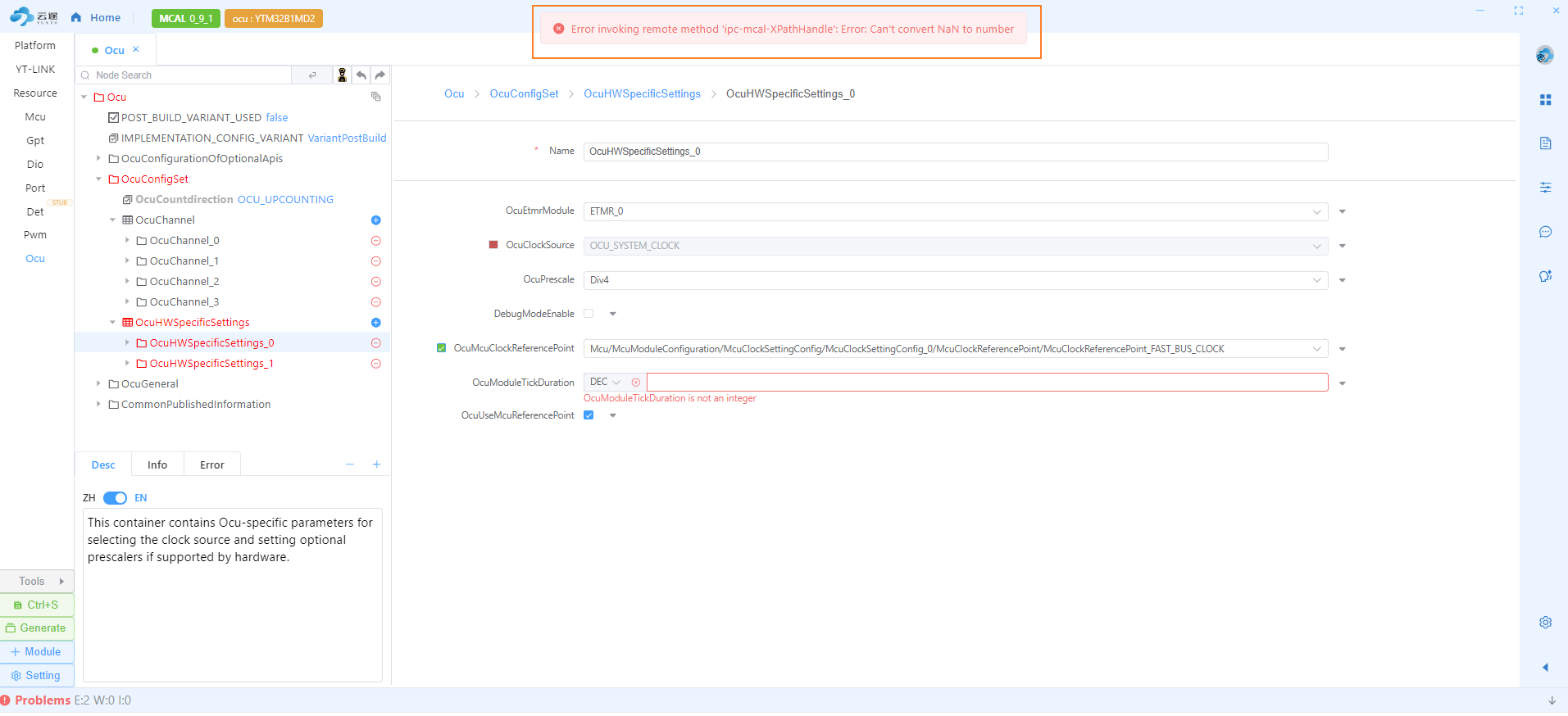

<blockquote>
<p dir="auto"><a class="plugin-mentions-user plugin-mentions-a" href="https://forum.ytmicro.com/uid/242">RuiXu</a> <a href="https://yt-static-main.oss-cn-shanghai.aliyuncs.com/nodebb/1652/458cf930-8788-436e-b881-04491d18ba98.yct" rel="nofollow ugc">project.yct</a></p>
</blockquote>
<p dir="auto">此参数计算方式有问题，但是并不影响生成的配置代码，可以手动更改一个整数值来解决此报错。后续发布的新版本会修正计算方式</p>
