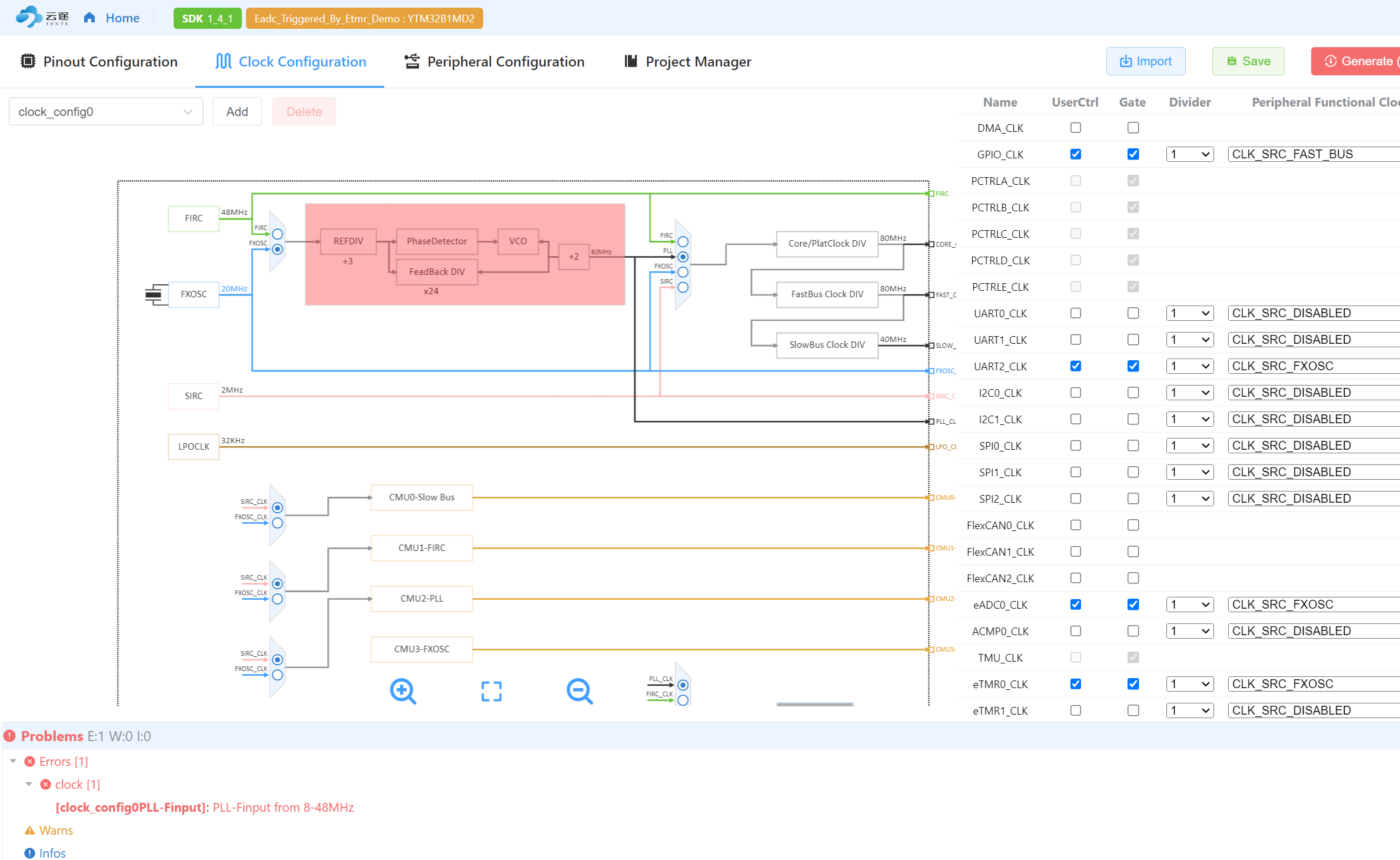

<?xml version="1.0" encoding="UTF-8"?><rss xmlns:dc="http://purl.org/dc/elements/1.1/" xmlns:content="http://purl.org/rss/1.0/modules/content/" xmlns:atom="http://www.w3.org/2005/Atom" version="2.0"><channel><title><![CDATA[MD24晶振20M给PLL，不管怎么配置都报错误，PLL输出80M]]></title><description><![CDATA[<p dir="auto"><img src="https://yt-static-main.oss-cn-shanghai.aliyuncs.com/nodebb/1622/3e8fa143-1d09-42c8-b4b9-b0239eae3daf.png" alt="84538089-4b4d-4d12-acc1-f3ad8491edec-image.png" class=" img-fluid img-markdown" /></p>

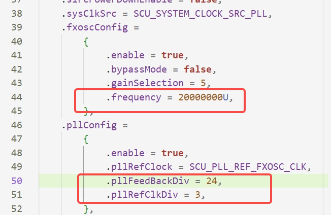

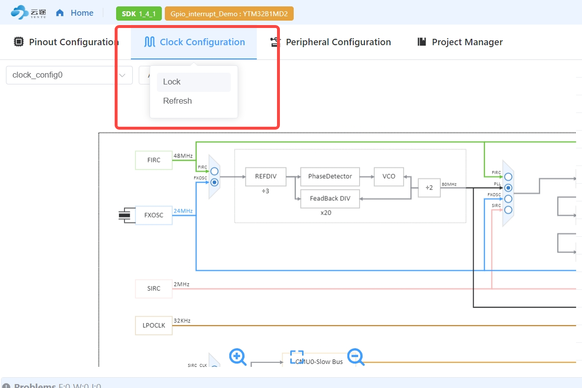

]]></description><link>https://forum.ytmicro.com/post/9752</link><guid isPermaLink="true">https://forum.ytmicro.com/post/9752</guid><dc:creator><![CDATA[吴成功]]></dc:creator><pubDate>Tue, 22 Sep 2026 07:11:11 GMT</pubDate></item><item><title><![CDATA[Reply to MD24晶振20M给PLL，不管怎么配置都报错误，PLL输出80M on Tue, 22 Sep 2026 07:06:05 GMT]]></title><description><![CDATA[<p dir="auto"><a class="plugin-mentions-user plugin-mentions-a" href="https://forum.ytmicro.com/uid/29">HAIYANG</a> 工具配成24M，生产代码后手动修改clock_config.c，然后把clock配置锁住，不影响后续再生成代码；<img src="https://yt-static-main.oss-cn-shanghai.aliyuncs.com/nodebb/29/2ac456cb-6d5b-44c7-9076-150f1e83c853.png" alt="f0748576-7edd-4c02-bf7d-ff3619a565b5-image.png" class=" img-fluid img-markdown" /></p>

]]></description><link>https://forum.ytmicro.com/post/9741</link><guid isPermaLink="true">https://forum.ytmicro.com/post/9741</guid><dc:creator><![CDATA[yangke]]></dc:creator><pubDate>Tue, 22 Sep 2026 04:43:03 GMT</pubDate></item></channel></rss>
