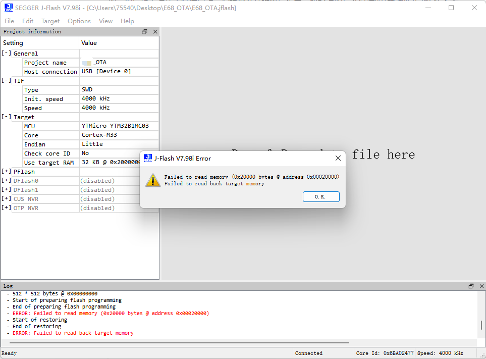

<?xml version="1.0" encoding="UTF-8"?><rss xmlns:dc="http://purl.org/dc/elements/1.1/" xmlns:content="http://purl.org/rss/1.0/modules/content/" xmlns:atom="http://www.w3.org/2005/Atom" version="2.0"><channel><title><![CDATA[YTM32B1MC03使用JFlash烧录软件后异常]]></title><description><![CDATA[<p dir="auto">用Jflash烧录代码过程不断电，烧录成功后运行正常，断电放了一段时间上电，代码没有运行，并且用JFLASH读取flash的数据，出现如图片提示<img src="https://yt-static-main.oss-cn-shanghai.aliyuncs.com/nodebb/149/8f1fded6-628f-4a7a-a81f-cd49519078c7.png" alt="微信图片_2026-09-18_165853_258.png" class=" img-fluid img-markdown" /> 麻烦帮忙分析一下是什么原因导致</p>

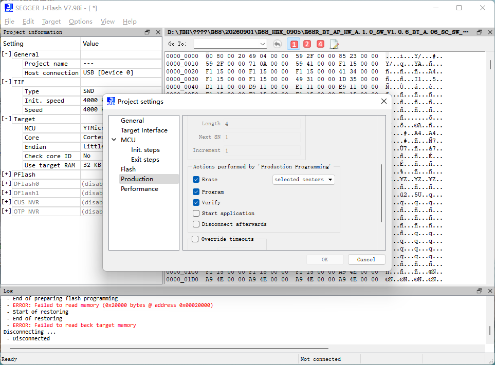

]]></description><link>https://forum.ytmicro.com/post/9712</link><guid isPermaLink="true">https://forum.ytmicro.com/post/9712</guid><dc:creator><![CDATA[primaryleaf]]></dc:creator><pubDate>Fri, 18 Sep 2026 09:57:33 GMT</pubDate></item><item><title><![CDATA[Reply to YTM32B1MC03使用JFlash烧录软件后异常 on Fri, 18 Sep 2026 09:40:56 GMT]]></title><description><![CDATA[<p dir="auto">可以看下寄存器是不是有ecc 错误</p>

]]></description><link>https://forum.ytmicro.com/post/9710</link><guid isPermaLink="true">https://forum.ytmicro.com/post/9710</guid><dc:creator><![CDATA[swust]]></dc:creator><pubDate>Fri, 18 Sep 2026 09:40:00 GMT</pubDate></item><item><title><![CDATA[Reply to YTM32B1MC03使用JFlash烧录软件后异常 on Fri, 18 Sep 2026 09:38:43 GMT]]></title><description><![CDATA[<p dir="auto"><img src="https://yt-static-main.oss-cn-shanghai.aliyuncs.com/nodebb/149/634d743c-52da-40a4-92c5-32bd94373dd5.png" alt="image.png" class=" img-fluid img-markdown" /><br />

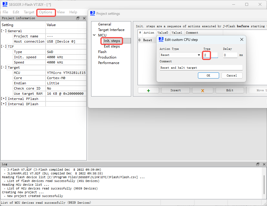

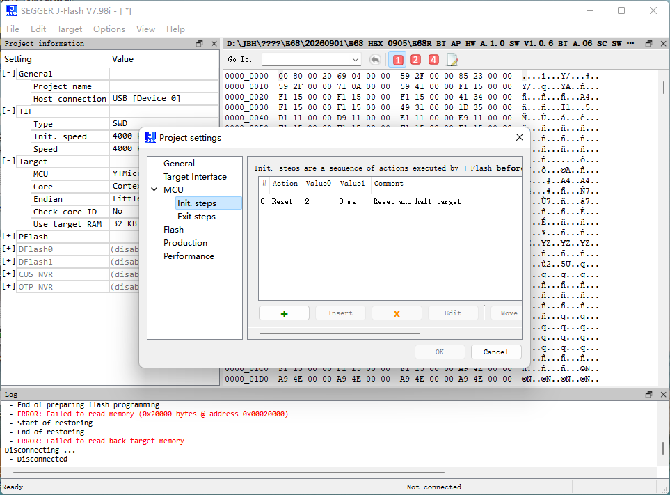

]]></description><link>https://forum.ytmicro.com/post/9709</link><guid isPermaLink="true">https://forum.ytmicro.com/post/9709</guid><dc:creator><![CDATA[primaryleaf]]></dc:creator><pubDate>Fri, 18 Sep 2026 09:38:43 GMT</pubDate></item><item><title><![CDATA[Reply to YTM32B1MC03使用JFlash烧录软件后异常 on Fri, 18 Sep 2026 09:14:58 GMT]]></title><description><![CDATA[<p dir="auto"><img src="https://yt-static-main.oss-cn-shanghai.aliyuncs.com/nodebb/1298/5d64b05a-9477-4162-ae0b-a0aea47b475e.png" alt="image.png" class=" img-fluid img-markdown" />试一下</p>
]]></description><link>https://forum.ytmicro.com/post/9706</link><guid isPermaLink="true">https://forum.ytmicro.com/post/9706</guid><dc:creator><![CDATA[swust]]></dc:creator><pubDate>Fri, 18 Sep 2026 09:14:58 GMT</pubDate></item><item><title><![CDATA[Reply to YTM32B1MC03使用JFlash烧录软件后异常 on Fri, 18 Sep 2026 09:13:59 GMT]]></title><description><![CDATA[<p dir="auto">程序没有设置AB分区</p>
