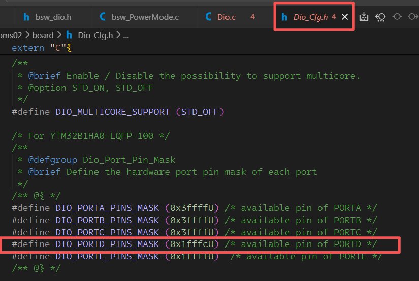

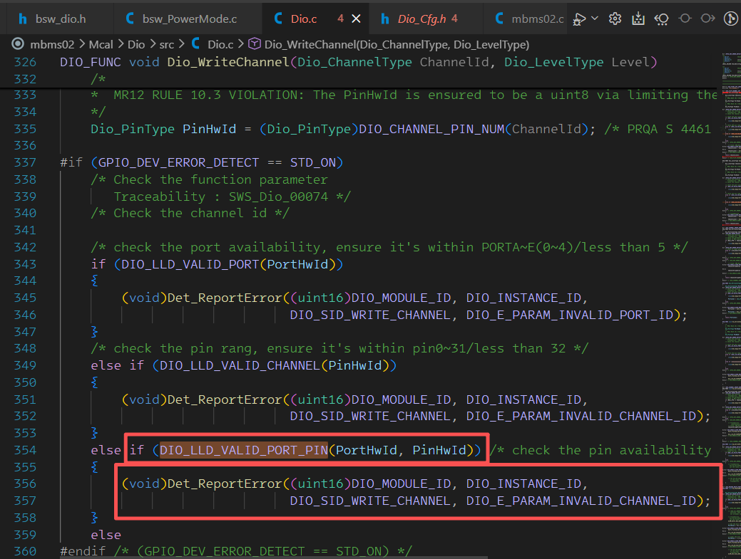

<p dir="auto">仿真调试发现在写DIO时，执行到DIO_LLD_VALID_PORT_PIN判断时会出现错误。生成的Dio_Cfg.h文件中的宏定义DIO_PORTD_PINS_MASK默认为0x1FFFC，第17位为0，导致Det报错。<br />
<img src="https://yt-static-main.oss-cn-shanghai.aliyuncs.com/nodebb/1298/9319d35c-04b5-4ef5-b958-e2bfeccf8a7e.png" alt="a0f25fb9-c1da-41cc-8a33-c6fe20b129c8-image.png" class=" img-fluid img-markdown" /></p>
<p dir="auto"><img src="https://yt-static-main.oss-cn-shanghai.aliyuncs.com/nodebb/1298/7dc7f1cc-9647-4c6f-bead-bb83ef83988c.png" alt="21ad88c5-7034-47cb-a273-88b914991c49-image.png" class=" img-fluid img-markdown" /></p>

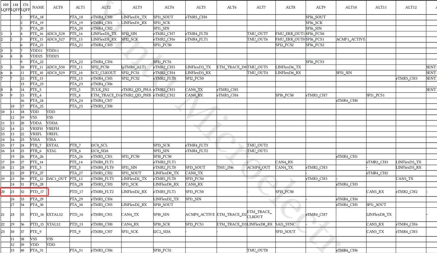

<p dir="auto">实际YTM32B1HA0 100pin存在PTD17。</p>
<p dir="auto"><img src="https://yt-static-main.oss-cn-shanghai.aliyuncs.com/nodebb/1298/6edd4a8d-6f11-4484-b634-e7a54a0a4f1c.png" alt="d4ee0eb3-ab18-40a3-924b-1ba2a1ad8295-image.png" class=" img-fluid img-markdown" /></p>

<p dir="auto">DIO_PORTD_PINS_MASK修改为0x3FFFC。</p>
