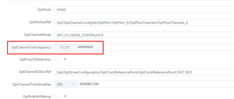

<?xml version="1.0" encoding="UTF-8"?><rss xmlns:dc="http://purl.org/dc/elements/1.1/" xmlns:content="http://purl.org/rss/1.0/modules/content/" xmlns:atom="http://www.w3.org/2005/Atom" version="2.0"><channel><title><![CDATA[MD24 mcal gpt]]></title><description><![CDATA[<p dir="auto">MD24 MCAL的 Gpt_Lptmr_Wakeup_demo 里面的ptmr定时中断周期为啥是1ms啊，没看见时钟有分频</p>

]]></description><link>https://forum.ytmicro.com/post/9695</link><guid isPermaLink="true">https://forum.ytmicro.com/post/9695</guid><dc:creator><![CDATA[jan]]></dc:creator><pubDate>Fri, 18 Sep 2026 03:27:42 GMT</pubDate></item><item><title><![CDATA[Reply to MD24 mcal gpt on Fri, 18 Sep 2026 03:23:55 GMT]]></title><description><![CDATA[<p dir="auto">所以为啥重装载值要写成40000，不直接写成48000</p>
]]></description><link>https://forum.ytmicro.com/post/9694</link><guid isPermaLink="true">https://forum.ytmicro.com/post/9694</guid><dc:creator><![CDATA[JETT]]></dc:creator><pubDate>Fri, 18 Sep 2026 03:23:55 GMT</pubDate></item><item><title><![CDATA[Reply to MD24 mcal gpt on Fri, 18 Sep 2026 03:16:03 GMT]]></title><description><![CDATA[<p dir="auto">Ptmr时钟源是48000000，严格来说 40000/48MHz = 833.3 µs，是"约 1ms"的整数近似值。若要精确 1ms，装载值应为 48000。</p>
<p dir="auto"><img src="https://yt-static-main.oss-cn-shanghai.aliyuncs.com/nodebb/22/7dce2917-8689-479e-ad5d-ab78ee1823b0.png" alt="image.png" class=" img-fluid img-markdown" /><br />
