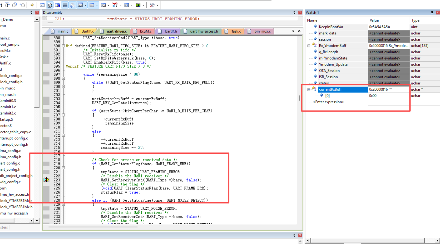

<p dir="auto"><img src="https://yt-static-main.oss-cn-shanghai.aliyuncs.com/nodebb/1053/c84fc47d-c189-4ea0-a4e9-32718b0265a9.png" alt="image.png" class=" img-fluid img-markdown" /><br />
while轮询UART_DRV_ReceiveDataPolling（）这个函数，会进这个if判断，导致一直没数据</p>

<p dir="auto">开启空闲中断就可以正常接收数据</p>
