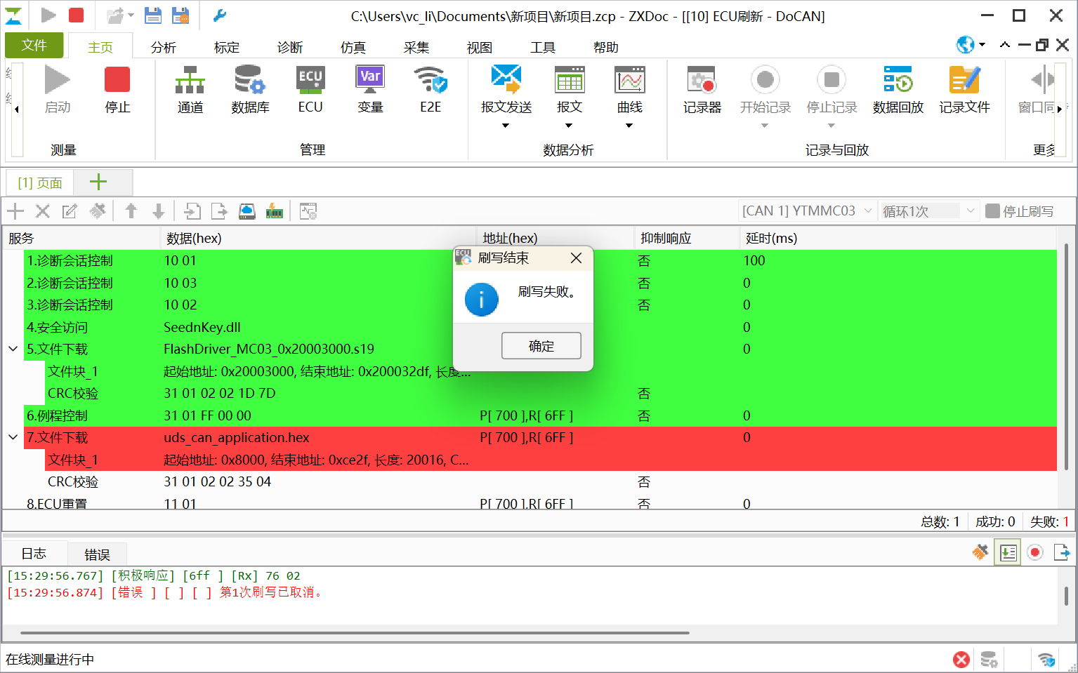

]]></description><link>https://forum.ytmicro.com/post/9425</link><guid isPermaLink="true">https://forum.ytmicro.com/post/9425</guid><dc:creator><![CDATA[ganyongchao]]></dc:creator><pubDate>Wed, 12 Aug 2026 07:37:44 GMT</pubDate></item><item><title><![CDATA[Reply to UDS刷写问题 on Wed, 12 Aug 2026 07:31:06 GMT]]></title><description><![CDATA[<p dir="auto"><a class="plugin-mentions-user plugin-mentions-a" href="https://forum.ytmicro.com/uid/15">ganyongchao</a> <img src="https://yt-static-main.oss-cn-shanghai.aliyuncs.com/nodebb/1532/32e4dae1-5c6e-49b6-ac16-8936e39450d9.png" alt="29d7f285-cbd2-4659-9891-6e707ad78ab2-image.png" class=" img-fluid img-markdown" /> 手动去停止刷写，然后我在次点击刷写的时候。就出现发10 01服务都不回啦  报文实际是收到的。</p>
