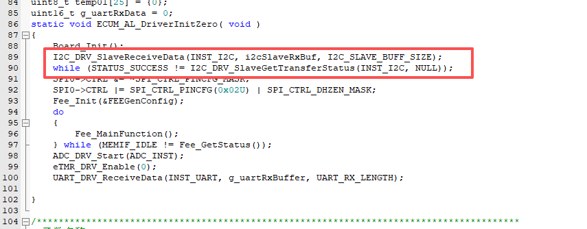

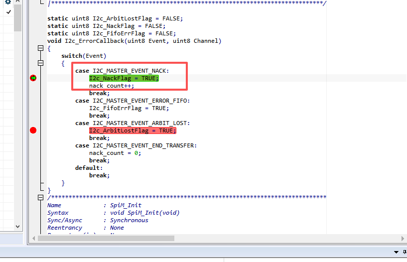

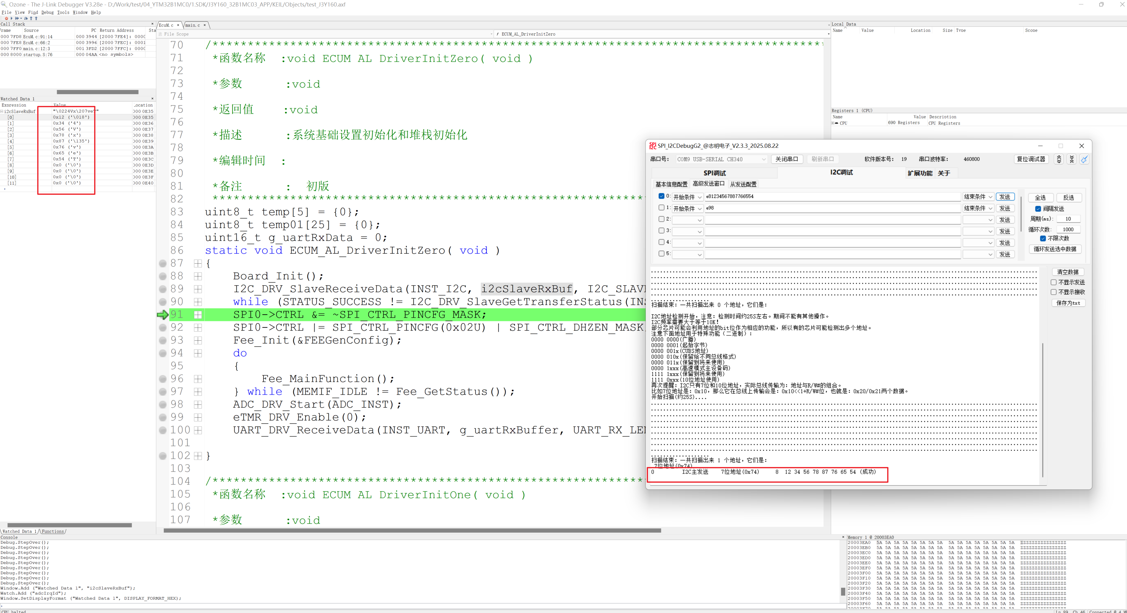

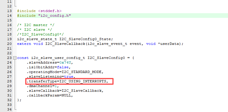

<?xml version="1.0" encoding="UTF-8"?><rss xmlns:dc="http://purl.org/dc/elements/1.1/" xmlns:content="http://purl.org/rss/1.0/modules/content/" xmlns:atom="http://www.w3.org/2005/Atom" version="2.0"><channel><title><![CDATA[从机SDK的IIC，开启DMA后，主机发送会显示没有应答]]></title><description><![CDATA[<p dir="auto">如图，从机IIC当我选择中断模式，主从IIC正常交互<img src="https://yt-static-main.oss-cn-shanghai.aliyuncs.com/nodebb/1053/7c87c8b6-47c7-42a2-a7e0-9a850d13f6bf.png" alt="325fc46b-47c1-4935-b6fa-e859eafffd04-image.png" class=" img-fluid img-markdown" /><br />
但是我选择DMA后，主机就会进错误回调函数，提示从机未应答<br />
<img src="https://yt-static-main.oss-cn-shanghai.aliyuncs.com/nodebb/1053/b957ce82-c893-433b-b7ee-06ae4ea4e813.png" alt="064994db-e19b-4cc2-bcb2-ca04ba100491-image.png" class=" img-fluid img-markdown" /> <img src="https://yt-static-main.oss-cn-shanghai.aliyuncs.com/nodebb/1053/4e15588b-5197-4703-8808-b9a5591a817e.png" alt="5f778bb9-0c3b-40c6-95ed-a00582ed7330-image.png" class=" img-fluid img-markdown" /> <img src="https://yt-static-main.oss-cn-shanghai.aliyuncs.com/nodebb/1053/b419bf14-d698-448b-a442-b17d7578f146.png" alt="0227452a-683a-4942-bc21-ef2d61354cb6-image.png" class=" img-fluid img-markdown" /><br />
目前主机的iic用的是mcal，从机用的SDK</p>

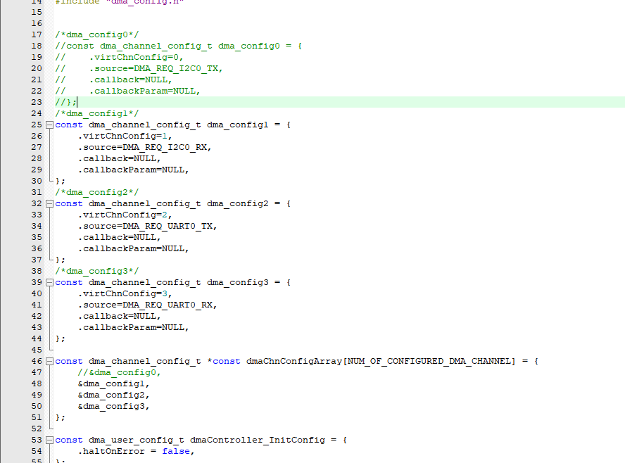

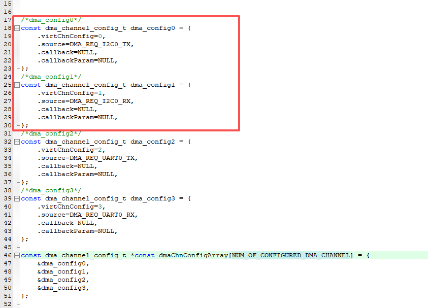

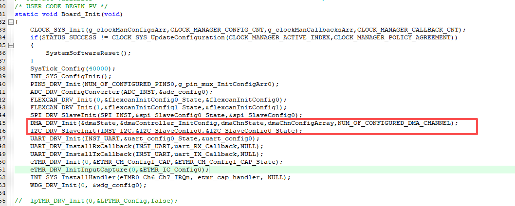

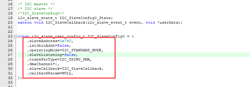

<p dir="auto">您好，我这边使用了Demo的DMA配置，还是不行，通信不上<img src="https://yt-static-main.oss-cn-shanghai.aliyuncs.com/nodebb/1053/51731f6f-273d-4e72-8582-26f7f26658d5.png" alt="6119b2a8-d85a-4609-8f8d-48380b71bc2f-image.png" class=" img-fluid img-markdown" /><br />
<img src="https://yt-static-main.oss-cn-shanghai.aliyuncs.com/nodebb/1053/8285cb25-ee6b-457e-8a1e-fd85ea570d64.png" alt="c8333fc8-8053-4b3b-924e-d78ffec2f864-image.png" class=" img-fluid img-markdown" /> <img src="https://yt-static-main.oss-cn-shanghai.aliyuncs.com/nodebb/1053/8877aeaf-4fd2-4641-ae13-a284259c929e.png" alt="87f4f498-e8b8-4003-ab45-dc342b819d74-image.png" class=" img-fluid img-markdown" /> <img src="https://yt-static-main.oss-cn-shanghai.aliyuncs.com/nodebb/1053/3603b912-982a-4cae-9fef-61cf2feea2d4.png" alt="30584b5f-227b-4da8-803b-74bb518619d1-image.png" class=" img-fluid img-markdown" /> <img src="https://yt-static-main.oss-cn-shanghai.aliyuncs.com/nodebb/1053/1bb49a00-56df-44c2-b783-922b4354b705.png" alt="f23bce60-c0bb-48f8-bdc7-6a663db352b7-image.png" class=" img-fluid img-markdown" /><br />
目前我的从机芯片是B1MC03,主机芯片是B1ME05</p>

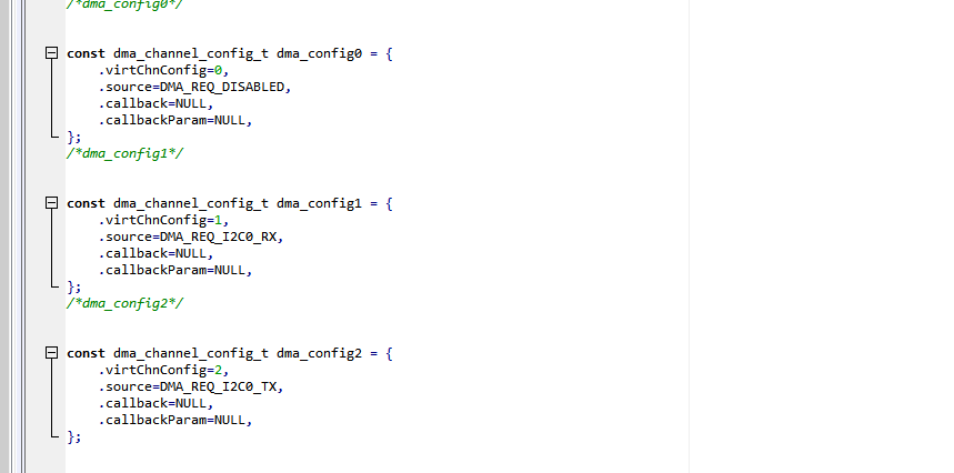

<p dir="auto">您好，我打开了demo工程，发现有三个DMA通道，目前IIC的SDK，DMA只有一路接收的RX吧，TX还有另外一路是不是多余了，还是有其他用途。<br />
<img src="https://yt-static-main.oss-cn-shanghai.aliyuncs.com/nodebb/1053/31d534c7-6ce1-4277-92d5-cae6dd6491df.png" alt="4ab5aa04-fc25-4736-bf92-74e2fd0f9284-image.png" class=" img-fluid img-markdown" /></p>
]]></description><link>https://forum.ytmicro.com/post/9354</link><guid isPermaLink="true">https://forum.ytmicro.com/post/9354</guid><dc:creator><![CDATA[z123456111]]></dc:creator><pubDate>Thu, 06 Aug 2026 01:56:53 GMT</pubDate></item><item><title><![CDATA[Reply to 从机SDK的IIC，开启DMA后，主机发送会显示没有应答 on Thu, 06 Aug 2026 01:54:46 GMT]]></title><description><![CDATA[<p dir="auto"><a href="https://yt-static-main.oss-cn-shanghai.aliyuncs.com/nodebb/710/2edd656e-2b55-48f6-aa9b-0dc2bec83ee5.zip" rel="nofollow ugc">I2c_Slave_Dma_Demo.zip</a><br />
这是基于 MD14 EVB  做的 I2C Slave DMA Demo，可以对比一下</p>
]]></description><link>https://forum.ytmicro.com/post/9353</link><guid isPermaLink="true">https://forum.ytmicro.com/post/9353</guid><dc:creator><![CDATA[Kirk]]></dc:creator><pubDate>Thu, 06 Aug 2026 01:54:46 GMT</pubDate></item></channel></rss>
