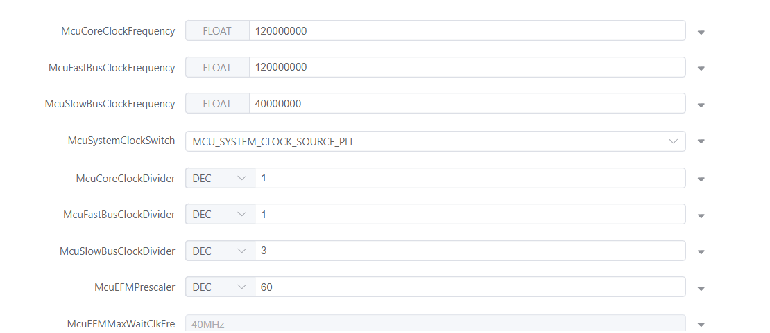

<?xml version="1.0" encoding="UTF-8"?><rss xmlns:dc="http://purl.org/dc/elements/1.1/" xmlns:content="http://purl.org/rss/1.0/modules/content/" xmlns:atom="http://www.w3.org/2005/Atom" version="2.0"><channel><title><![CDATA[MCAL配置MCU模块时，FastBusClock为什么提示不能超过100M，例程里可以到120M]]></title><description><![CDATA[<p dir="auto"><img src="https://yt-static-main.oss-cn-shanghai.aliyuncs.com/nodebb/2079/33c540f8-f9c3-4c8c-88b9-6ef11302e87d.png" alt="aa5c1d45-7cdd-41ac-881f-224fde6e9bd8-image.png" class=" img-fluid img-markdown" /></p>

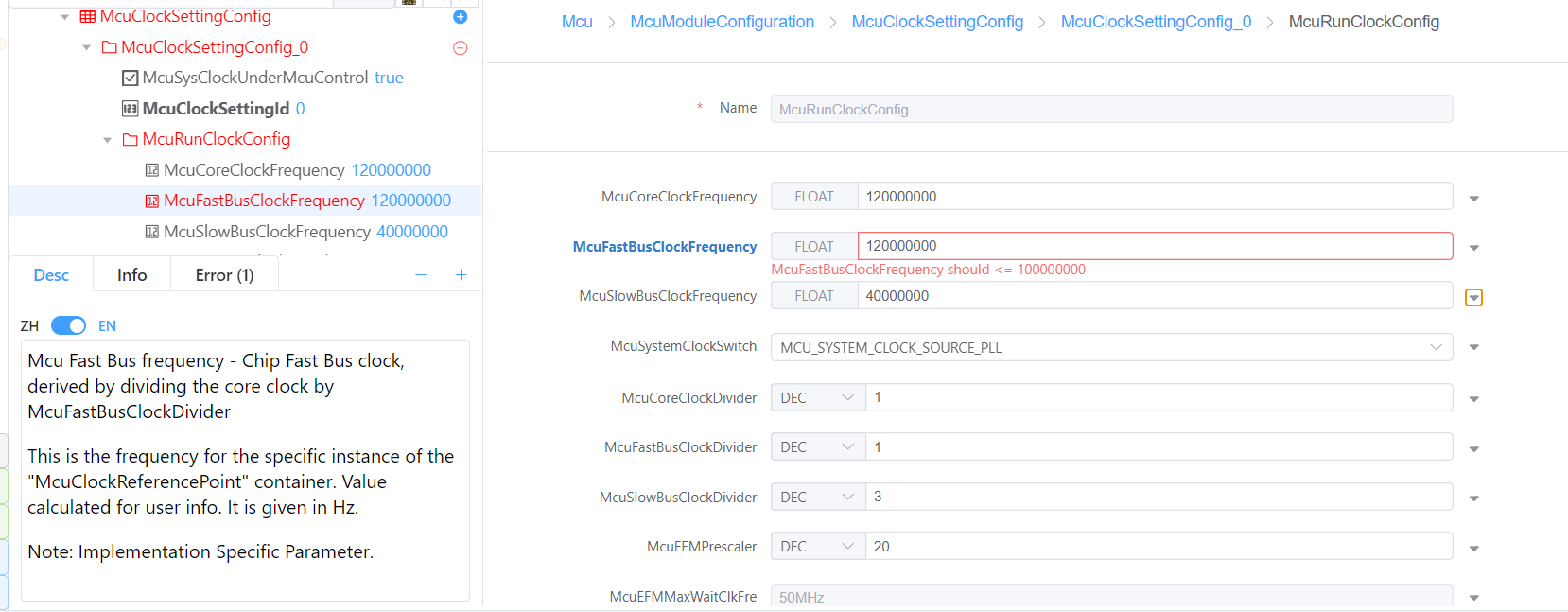

]]></description><link>https://forum.ytmicro.com/post/9336</link><guid isPermaLink="true">https://forum.ytmicro.com/post/9336</guid><dc:creator><![CDATA[shijij]]></dc:creator><pubDate>Tue, 04 Aug 2026 07:55:11 GMT</pubDate></item><item><title><![CDATA[Reply to MCAL配置MCU模块时，FastBusClock为什么提示不能超过100M，例程里可以到120M on Tue, 04 Aug 2026 07:48:21 GMT]]></title><description><![CDATA[<p dir="auto">你这第二张图片应该是截的另一个型号的配置</p>

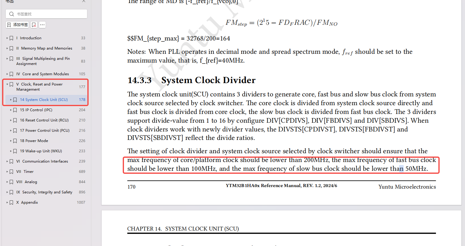

]]></description><link>https://forum.ytmicro.com/post/9335</link><guid isPermaLink="true">https://forum.ytmicro.com/post/9335</guid><dc:creator><![CDATA[swust]]></dc:creator><pubDate>Tue, 04 Aug 2026 07:48:21 GMT</pubDate></item><item><title><![CDATA[Reply to MCAL配置MCU模块时，FastBusClock为什么提示不能超过100M，例程里可以到120M on Tue, 04 Aug 2026 07:47:34 GMT]]></title><description><![CDATA[<p dir="auto"><img src="https://yt-static-main.oss-cn-shanghai.aliyuncs.com/nodebb/1298/81040e59-4fc4-4fe5-9e95-bfd0f9834acc.png" alt="image.png" class=" img-fluid img-markdown" /></p>
]]></description><link>https://forum.ytmicro.com/post/9334</link><guid isPermaLink="true">https://forum.ytmicro.com/post/9334</guid><dc:creator><![CDATA[swust]]></dc:creator><pubDate>Tue, 04 Aug 2026 07:47:34 GMT</pubDate></item><item><title><![CDATA[Reply to MCAL配置MCU模块时，FastBusClock为什么提示不能超过100M，例程里可以到120M on Tue, 04 Aug 2026 07:36:15 GMT]]></title><description><![CDATA[<p dir="auto"><img src="https://yt-static-main.oss-cn-shanghai.aliyuncs.com/nodebb/2079/a24af2ce-a723-4c33-b707-7236056d1c15.png" alt="image.png" class=" img-fluid img-markdown" /></p>
]]></description><link>https://forum.ytmicro.com/post/9333</link><guid isPermaLink="true">https://forum.ytmicro.com/post/9333</guid><dc:creator><![CDATA[shijij]]></dc:creator><pubDate>Tue, 04 Aug 2026 07:36:15 GMT</pubDate></item></channel></rss>
