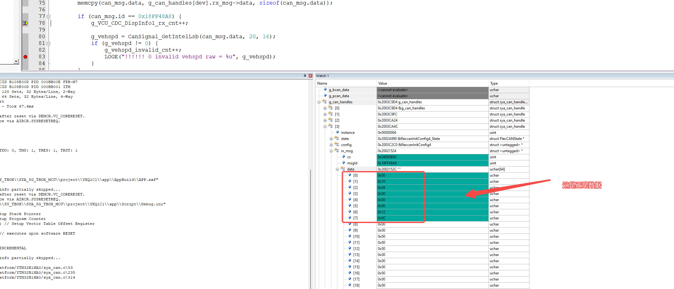

<p dir="auto"><strong>期望数据：<br />
00 11 04 00  00 00 2D 0C</strong><br />

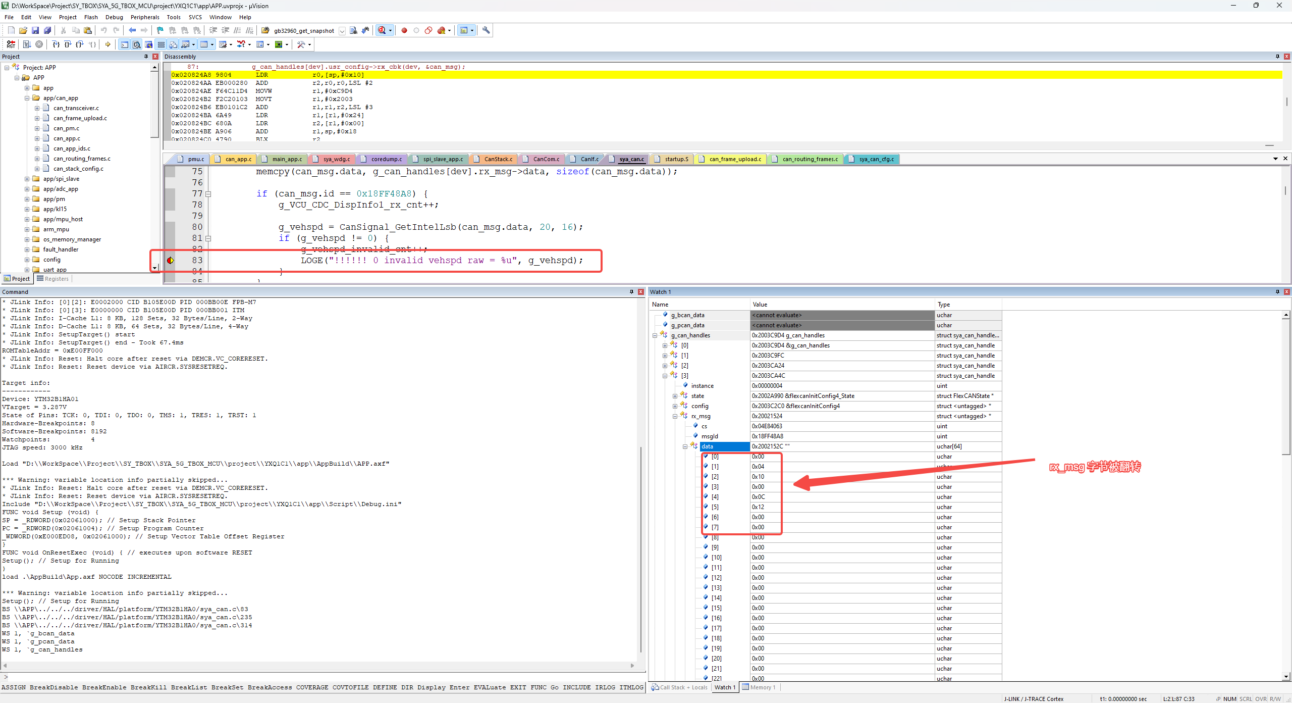

<img src="https://yt-static-main.oss-cn-shanghai.aliyuncs.com/nodebb/54/5809dc8f-ec5b-4d88-a5ce-30cc740a9a59.png" alt="e616e56e-8f8d-4014-a948-7a17c520d2fd-e3a073a3e3e155fa32971b12035bc9f9.png" class=" img-fluid img-markdown" /><br />
<strong>异常数据：<br />
00 04 11 00  0C 2D 00 00</strong><br />

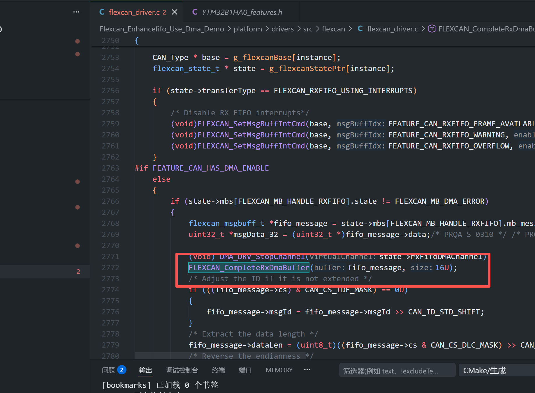

<p dir="auto">计划将Cache维护放到SDK的DMA所有权切换位置，时序如下：</p>
<p dir="auto">CleanInvalidate接收缓冲区<br />
-&gt; 配置并启动DMA<br />
-&gt; DMA完成<br />
-&gt; 停止DMA通道或确认DMA不再访问缓冲区<br />
-&gt; Invalidate接收缓冲区<br />
-&gt; SDK读取CS/ID/Data<br />
-&gt; 解析ID和DLC<br />
-&gt; 执行Data字节序转换<br />
-&gt; 触发用户回调</p>
<pre><code>SCB_CleanInvalidateDCache_by_Addr(rxBuffer, 16U);
DMA_DRV_StartChannel(channel);
/* DMA完成回调 */
DMA_DRV_StopChannel(channel);
SCB_InvalidateDCache_by_Addr(rxBuffer, 16U);
ParseIdAndDlc(rxBuffer);
SwapDataByteOrder(rxBuffer);
UserCallback(rxBuffer);
</code></pre>

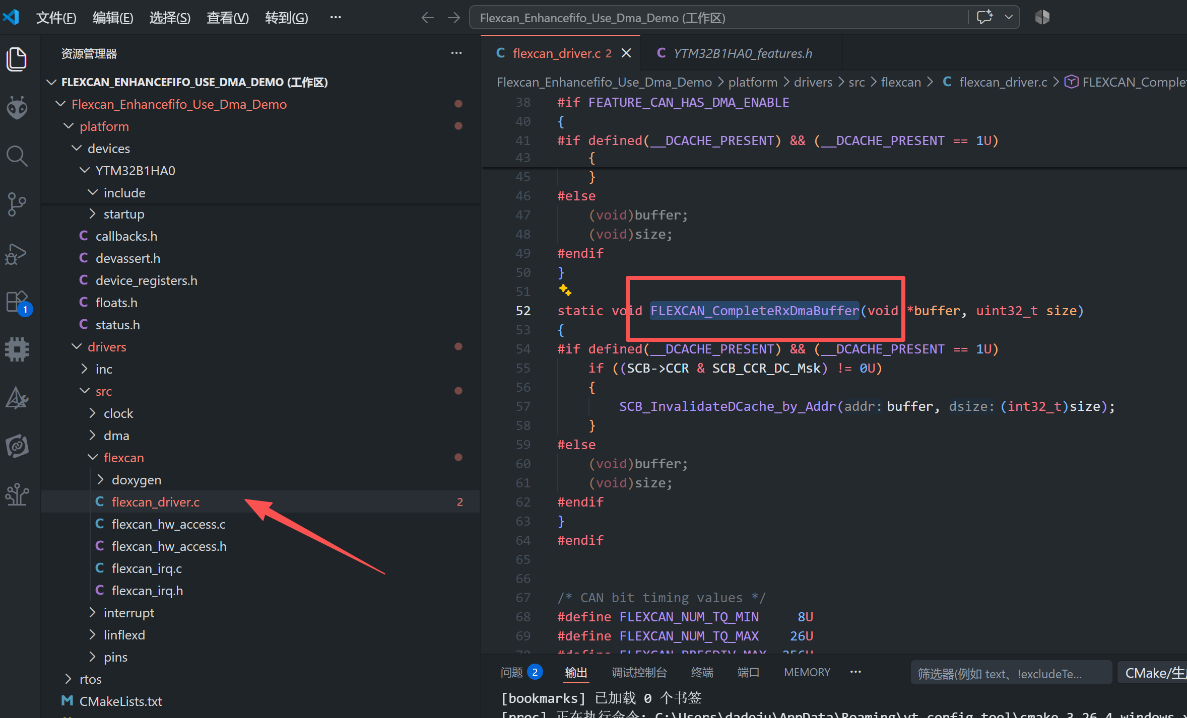

<p dir="auto"><img src="https://yt-static-main.oss-cn-shanghai.aliyuncs.com/nodebb/54/7d5f4a4a-3de2-41f8-bb1e-6d3a731960f1.png" alt="e8688c98-a303-468e-a987-d6874365d8e1-8608560b0aae8a85b5d7bfd6698fa040.png" class=" img-fluid img-markdown" /><br />
<img src="https://yt-static-main.oss-cn-shanghai.aliyuncs.com/nodebb/54/dba9801f-6468-4176-ba39-ba01790e1264.png" alt="96cd757b-c421-4469-85bb-c90eda851fdc-45c66bfe5a60d7718b94b81504c11d3c.png" class=" img-fluid img-markdown" /><br />
应用回调中不再对rxBuffer执行Cache操作，并且先处理或复制当前报文，<br />
最后再重新调用FLEXCAN_DRV_RxFifo()挂接下一次DMA接收。</p>

<li>不确定代码结构，加到CPU第一次访问这个RAM区域前。</li>
<li>没问题。</li>
</ol>

]]></description><link>https://forum.ytmicro.com/post/9327</link><guid isPermaLink="true">https://forum.ytmicro.com/post/9327</guid><dc:creator><![CDATA[gaoSheng]]></dc:creator><pubDate>Tue, 04 Aug 2026 03:33:38 GMT</pubDate></item><item><title><![CDATA[Reply to YTM32B1HA0 FlexCAN Legacy Rx FIFO DMA 开启 D-Cache 时的 Cache 维护时序确认 on Tue, 04 Aug 2026 03:26:50 GMT]]></title><description><![CDATA[<p dir="auto">通常DMA和CPU交互的RAM建议设置为NO-CACHE区域。</p>
<hr />
<p dir="auto">DMA 传输完成，CPU 访问这片区域前，invald cache 一次就够了</p>
]]></description><link>https://forum.ytmicro.com/post/9326</link><guid isPermaLink="true">https://forum.ytmicro.com/post/9326</guid><dc:creator><![CDATA[Frankie]]></dc:creator><pubDate>Tue, 04 Aug 2026 03:26:50 GMT</pubDate></item></channel></rss>
