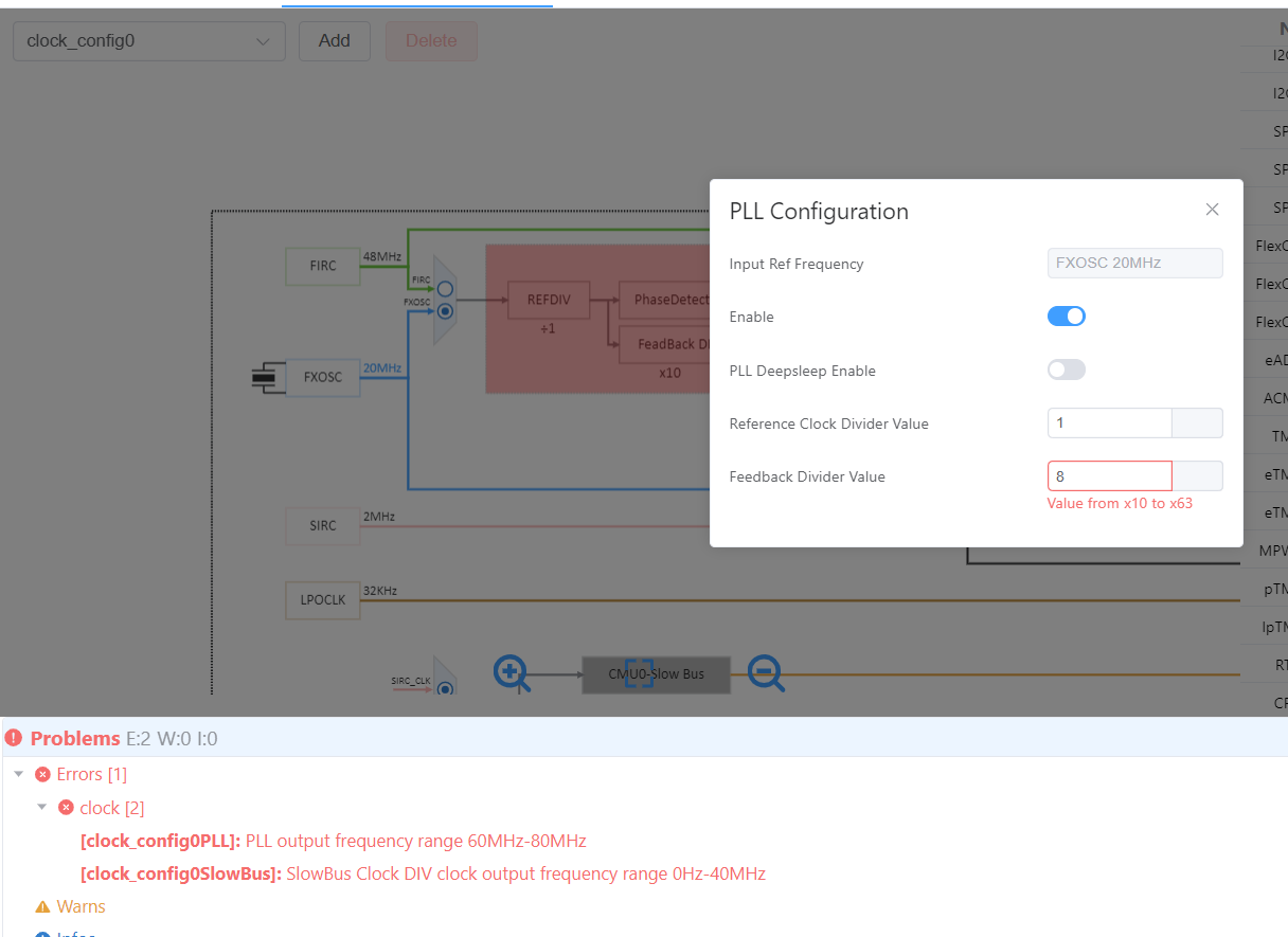

1、分频为1时，报错如下：<br />

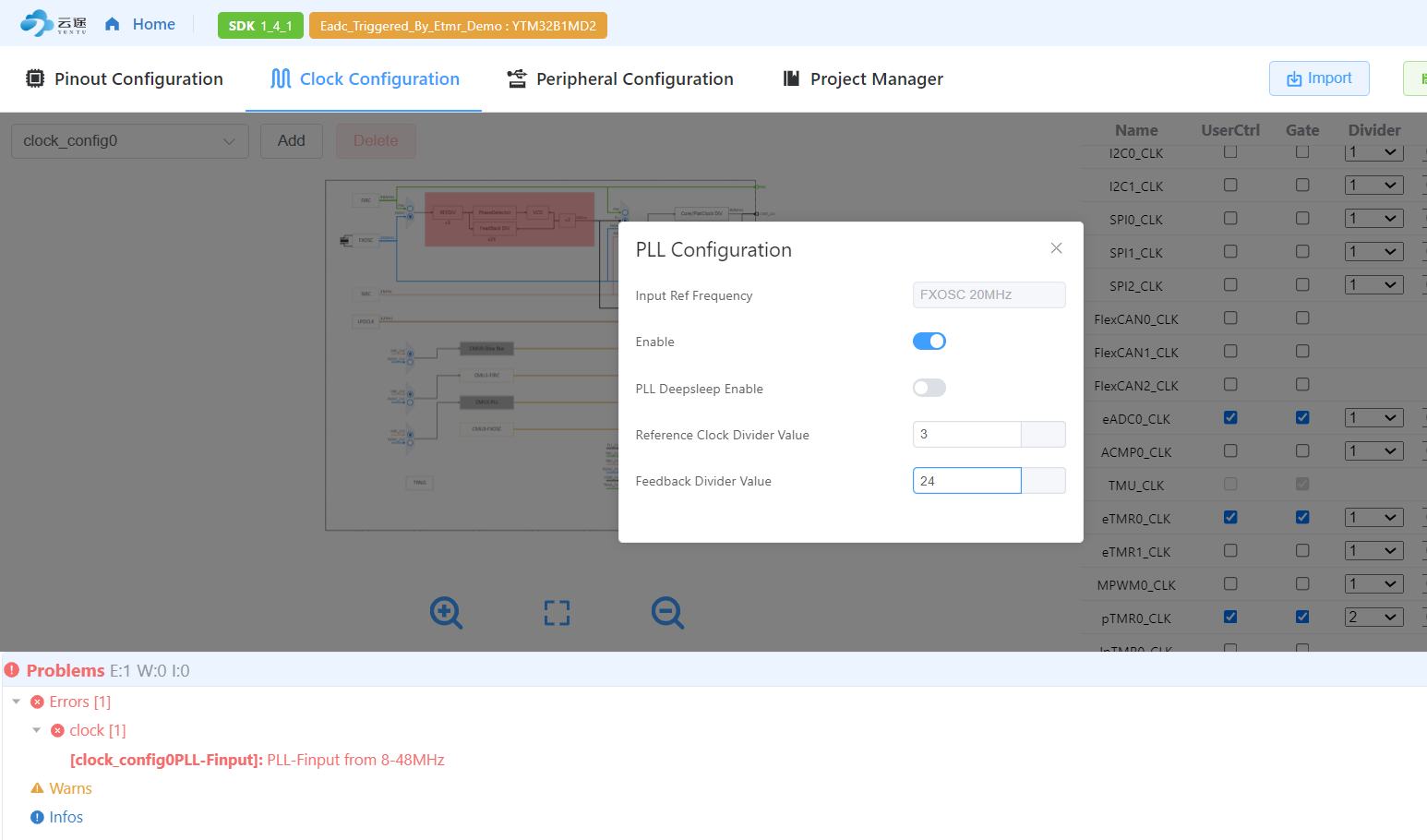

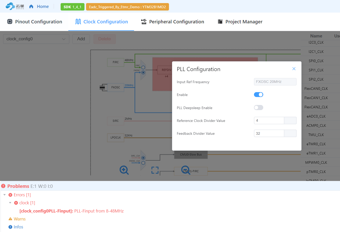

<img src="https://yt-static-main.oss-cn-shanghai.aliyuncs.com/nodebb/29/2ce32e89-572b-4449-9eae-976f66177bfc.png" alt="a5e30b4e-81b1-4d39-a47f-fb4d9b144ac0-image.png" class=" img-fluid img-markdown" /><br />

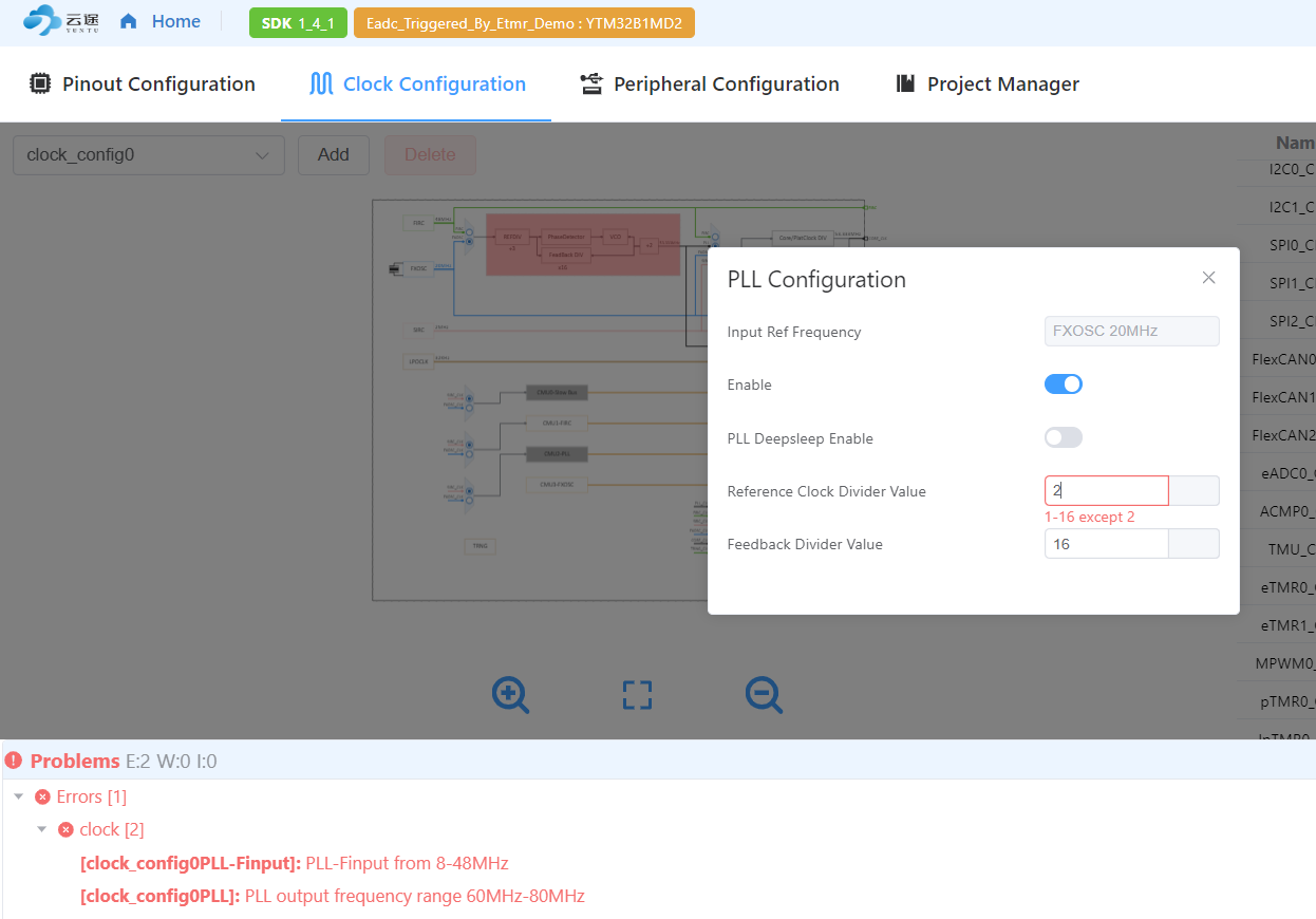

2、分频为2时，报错如下，提示不能分频为2：<br />
<img src="https://yt-static-main.oss-cn-shanghai.aliyuncs.com/nodebb/29/9bd700e1-7929-4948-b32a-e721e45747aa.png" alt="8e2b2d2e-d2f2-4e31-9163-8d9dbd2769ec-image.png" class=" img-fluid img-markdown" /><br />

<img src="https://yt-static-main.oss-cn-shanghai.aliyuncs.com/nodebb/29/88b92952-591a-4a40-ba71-eb94d4c0e33d.png" alt="3c163f10-4299-4ab9-9663-cc875ceb1573-image.png" class=" img-fluid img-markdown" /> <img src="https://yt-static-main.oss-cn-shanghai.aliyuncs.com/nodebb/29/ea213aab-b7aa-4ed1-bb25-ee5a24af81b5.png" alt="741ad1df-f07d-44b1-ab66-291d609c7997-image.png" class=" img-fluid img-markdown" /></p>
