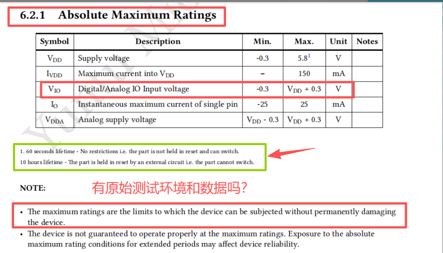

Supply=5.8V 拉住RESET脚，芯片不工作，可以10小时；</p>
<p dir="auto">芯片IO需要限流，否则有可能烧毁芯片</p>

]]></description><link>https://forum.ytmicro.com/post/9130</link><guid isPermaLink="true">https://forum.ytmicro.com/post/9130</guid><dc:creator><![CDATA[kid_li]]></dc:creator><pubDate>Tue, 07 Jul 2026 10:15:13 GMT</pubDate></item><item><title><![CDATA[Reply to ME05 GPIO耐压 on Tue, 07 Jul 2026 10:12:30 GMT]]></title><description><![CDATA[<p dir="auto">绿色框应该是指Supply=5.8V可以工作60秒，超过10小时异常吧？</p>
<p dir="auto">Vio范围是-0.3V到Vdd+0.3V；<br />
在关闭LVD情况下，假如VDD（持续100mS）为4V，那么如果外部给IO口一个5.5V的电压会如何呢？更甚，如果Vdd为3V，外部给一个6V，会不会损坏呢？</p>
]]></description><link>https://forum.ytmicro.com/post/9129</link><guid isPermaLink="true">https://forum.ytmicro.com/post/9129</guid><dc:creator><![CDATA[kid_li]]></dc:creator><pubDate>Tue, 07 Jul 2026 10:12:30 GMT</pubDate></item><item><title><![CDATA[Reply to ME05 GPIO耐压 on Tue, 07 Jul 2026 10:04:00 GMT]]></title><description><![CDATA[<p dir="auto"><img src="https://yt-static-main.oss-cn-shanghai.aliyuncs.com/nodebb/28/ca430a5e-0038-419c-9bdf-11aeea7fa36b.png" alt="image.png" class=" img-fluid img-markdown" />如截图</p>
]]></description><link>https://forum.ytmicro.com/post/9128</link><guid isPermaLink="true">https://forum.ytmicro.com/post/9128</guid><dc:creator><![CDATA[xianghan]]></dc:creator><pubDate>Tue, 07 Jul 2026 10:04:00 GMT</pubDate></item><item><title><![CDATA[Reply to ME05 GPIO耐压 on Tue, 07 Jul 2026 09:50:22 GMT]]></title><description><![CDATA[<p dir="auto">对的，Datasheet如上描述，看起来应该是有做过原始的测试吧？有没有可能找出来参考下，以便客户做类似的测试呢？</p>

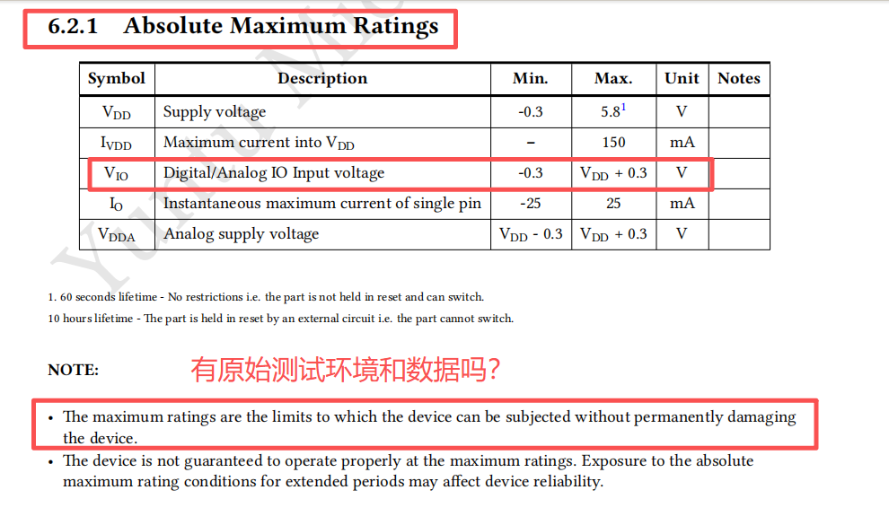

]]></description><link>https://forum.ytmicro.com/post/9127</link><guid isPermaLink="true">https://forum.ytmicro.com/post/9127</guid><dc:creator><![CDATA[kid_li]]></dc:creator><pubDate>Tue, 07 Jul 2026 09:50:22 GMT</pubDate></item><item><title><![CDATA[Reply to ME05 GPIO耐压 on Tue, 07 Jul 2026 09:47:38 GMT]]></title><description><![CDATA[<p dir="auto"><img src="https://yt-static-main.oss-cn-shanghai.aliyuncs.com/nodebb/887/1f74b0ab-5f0a-4fb3-a238-16681ef09653.png" alt="image.png" class=" img-fluid img-markdown" /></p>

]]></description><link>https://forum.ytmicro.com/post/9123</link><guid isPermaLink="true">https://forum.ytmicro.com/post/9123</guid><dc:creator><![CDATA[xianghan]]></dc:creator><pubDate>Tue, 07 Jul 2026 09:15:58 GMT</pubDate></item></channel></rss>
