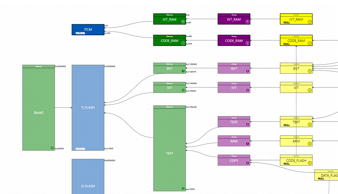

<?xml version="1.0" encoding="UTF-8"?><rss xmlns:dc="http://purl.org/dc/elements/1.1/" xmlns:content="http://purl.org/rss/1.0/modules/content/" xmlns:atom="http://www.w3.org/2005/Atom" version="2.0"><channel><title><![CDATA[b1ha0 使用sdk进行Boot Swap时，bank切换成功，但是程序还是执行旧的]]></title><description><![CDATA[[[topic:post-is-deleted]]]]></description><link>https://forum.ytmicro.com/topic/2075/b1ha0-使用sdk进行boot-swap时-bank切换成功-但是程序还是执行旧的</link><generator>RSS for Node</generator><lastBuildDate>Wed, 01 Jul 2026 19:05:01 GMT</lastBuildDate><atom:link href="https://forum.ytmicro.com/topic/2075.rss" rel="self" type="application/rss+xml"/><pubDate>Wed, 01 Jul 2026 08:08:18 GMT</pubDate><ttl>60</ttl><item><title><![CDATA[Reply to b1ha0 使用sdk进行Boot Swap时，bank切换成功，但是程序还是执行旧的 on Wed, 01 Jul 2026 09:09:02 GMT]]></title><description><![CDATA[<p dir="auto"><a class="plugin-mentions-user plugin-mentions-a" href="https://forum.ytmicro.com/uid/28">xianghan</a> <img src="https://yt-static-main.oss-cn-shanghai.aliyuncs.com/nodebb/1125/54d2dae6-d327-4923-9707-a122df28a06d.png" alt="b9494d90-d102-4301-9173-7ca42b2610fa-image.png" class=" img-fluid img-markdown" /> 这样布局有问题吗</p>

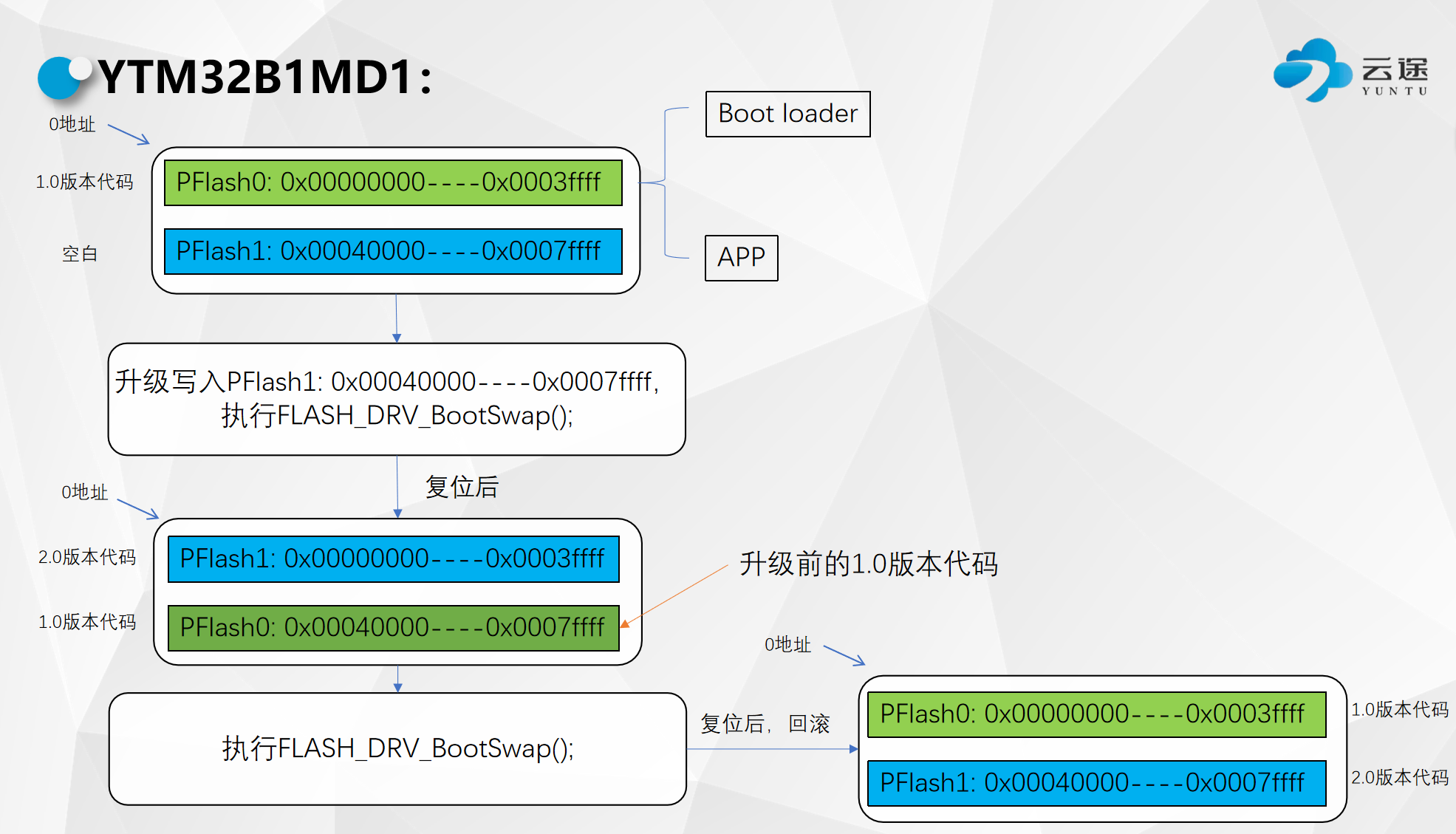

]]></description><link>https://forum.ytmicro.com/post/8998</link><guid isPermaLink="true">https://forum.ytmicro.com/post/8998</guid><dc:creator><![CDATA[lf]]></dc:creator><pubDate>Wed, 01 Jul 2026 09:09:02 GMT</pubDate></item><item><title><![CDATA[Reply to b1ha0 使用sdk进行Boot Swap时，bank切换成功，但是程序还是执行旧的 on Wed, 01 Jul 2026 08:55:44 GMT]]></title><description><![CDATA[<p dir="auto"><img src="https://yt-static-main.oss-cn-shanghai.aliyuncs.com/nodebb/28/d487b12f-ea12-4b07-83af-5f2fccc844cc.png" alt="image.png" class=" img-fluid img-markdown" /></p>
]]></description><link>https://forum.ytmicro.com/post/8992</link><guid isPermaLink="true">https://forum.ytmicro.com/post/8992</guid><dc:creator><![CDATA[xianghan]]></dc:creator><pubDate>Wed, 01 Jul 2026 08:55:44 GMT</pubDate></item><item><title><![CDATA[Reply to b1ha0 使用sdk进行Boot Swap时，bank切换成功，但是程序还是执行旧的 on Wed, 01 Jul 2026 08:48:21 GMT]]></title><description><![CDATA[<p dir="auto"><a class="plugin-mentions-user plugin-mentions-a" href="https://forum.ytmicro.com/uid/28">xianghan</a> 切换成功后，地址0不应该映射到bank1的地址吗，去执行bank1的代码吗</p>
]]></description><link>https://forum.ytmicro.com/post/8988</link><guid isPermaLink="true">https://forum.ytmicro.com/post/8988</guid><dc:creator><![CDATA[lf]]></dc:creator><pubDate>Wed, 01 Jul 2026 08:48:21 GMT</pubDate></item><item><title><![CDATA[Reply to b1ha0 使用sdk进行Boot Swap时，bank切换成功，但是程序还是执行旧的 on Wed, 01 Jul 2026 08:28:57 GMT]]></title><description><![CDATA[<p dir="auto">硬件A/B分区本身只是地址映射切换，代码永远执行0地址；</p>
]]></description><link>https://forum.ytmicro.com/post/8980</link><guid isPermaLink="true">https://forum.ytmicro.com/post/8980</guid><dc:creator><![CDATA[xianghan]]></dc:creator><pubDate>Wed, 01 Jul 2026 08:28:57 GMT</pubDate></item><item><title><![CDATA[Reply to b1ha0 使用sdk进行Boot Swap时，bank切换成功，但是程序还是执行旧的 on Wed, 01 Jul 2026 08:24:26 GMT]]></title><description><![CDATA[<p dir="auto"><a class="plugin-mentions-user plugin-mentions-a" href="https://forum.ytmicro.com/uid/28">xianghan</a> 我从bank0切换到bank1，通过EFM-&gt;STS寄存器看到切换成功，复位后还是执行的bank0里面的代码，这是为什么</p>
]]></description><link>https://forum.ytmicro.com/post/8979</link><guid isPermaLink="true">https://forum.ytmicro.com/post/8979</guid><dc:creator><![CDATA[lf]]></dc:creator><pubDate>Wed, 01 Jul 2026 08:24:26 GMT</pubDate></item><item><title><![CDATA[Reply to b1ha0 使用sdk进行Boot Swap时，bank切换成功，但是程序还是执行旧的 on Wed, 01 Jul 2026 08:19:28 GMT]]></title><description><![CDATA[<p dir="auto">切换成功后，程序还是在0地址启动的，判断是否在哪个程序，可以去Toggle GPIO 或者点灯</p>
]]></description><link>https://forum.ytmicro.com/post/8978</link><guid isPermaLink="true">https://forum.ytmicro.com/post/8978</guid><dc:creator><![CDATA[xianghan]]></dc:creator><pubDate>Wed, 01 Jul 2026 08:19:28 GMT</pubDate></item></channel></rss>
