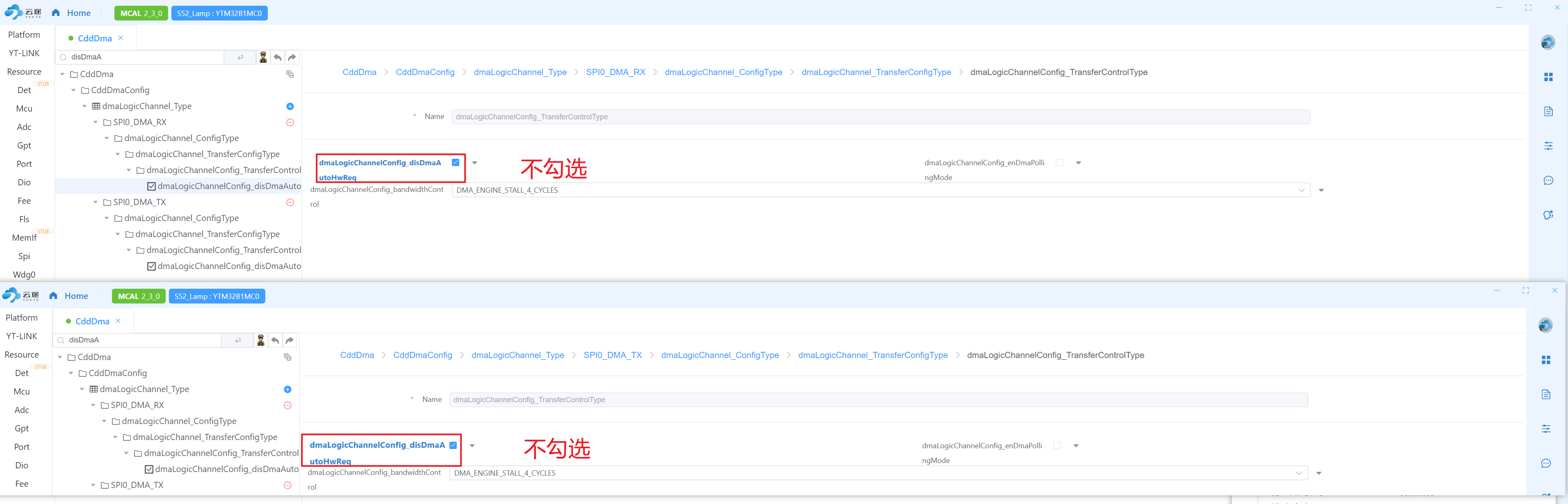

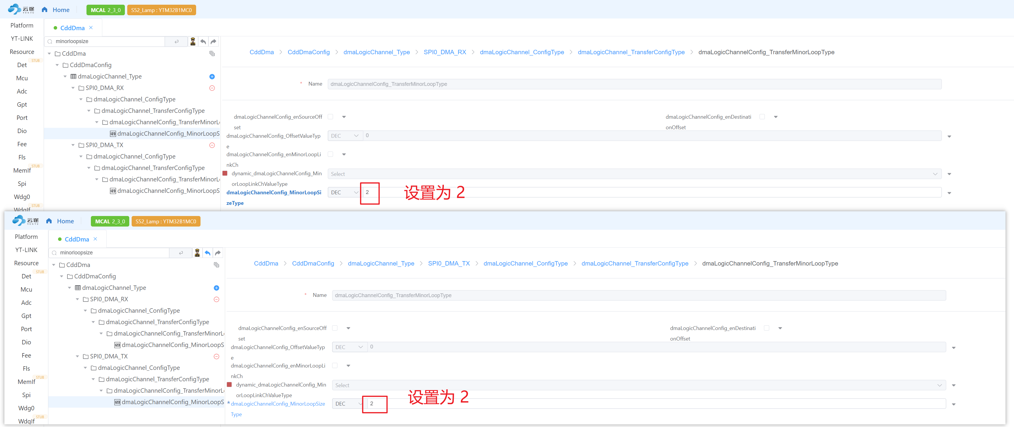

<img src="https://yt-static-main.oss-cn-shanghai.aliyuncs.com/nodebb/710/07d92f29-93f6-4bec-8882-e70fdeafe987.png" alt="04716eb5-7403-4cec-b917-847afe630508-image.png" class=" img-fluid img-markdown" /><br />
配置上按照上述两张图修改一下后再试一下</p>

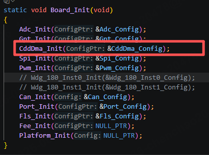

<p dir="auto"><img src="https://yt-static-main.oss-cn-shanghai.aliyuncs.com/nodebb/1720/b75b19a4-b900-4bd0-a7aa-6601533361f6.png" alt="0f3c2c48-2614-4807-a4ae-d24eec1ac952-cc7543c9cc2576ff27b0c8bf1ccbf96f.png" class=" img-fluid img-markdown" /> 代码里面调用的</p>

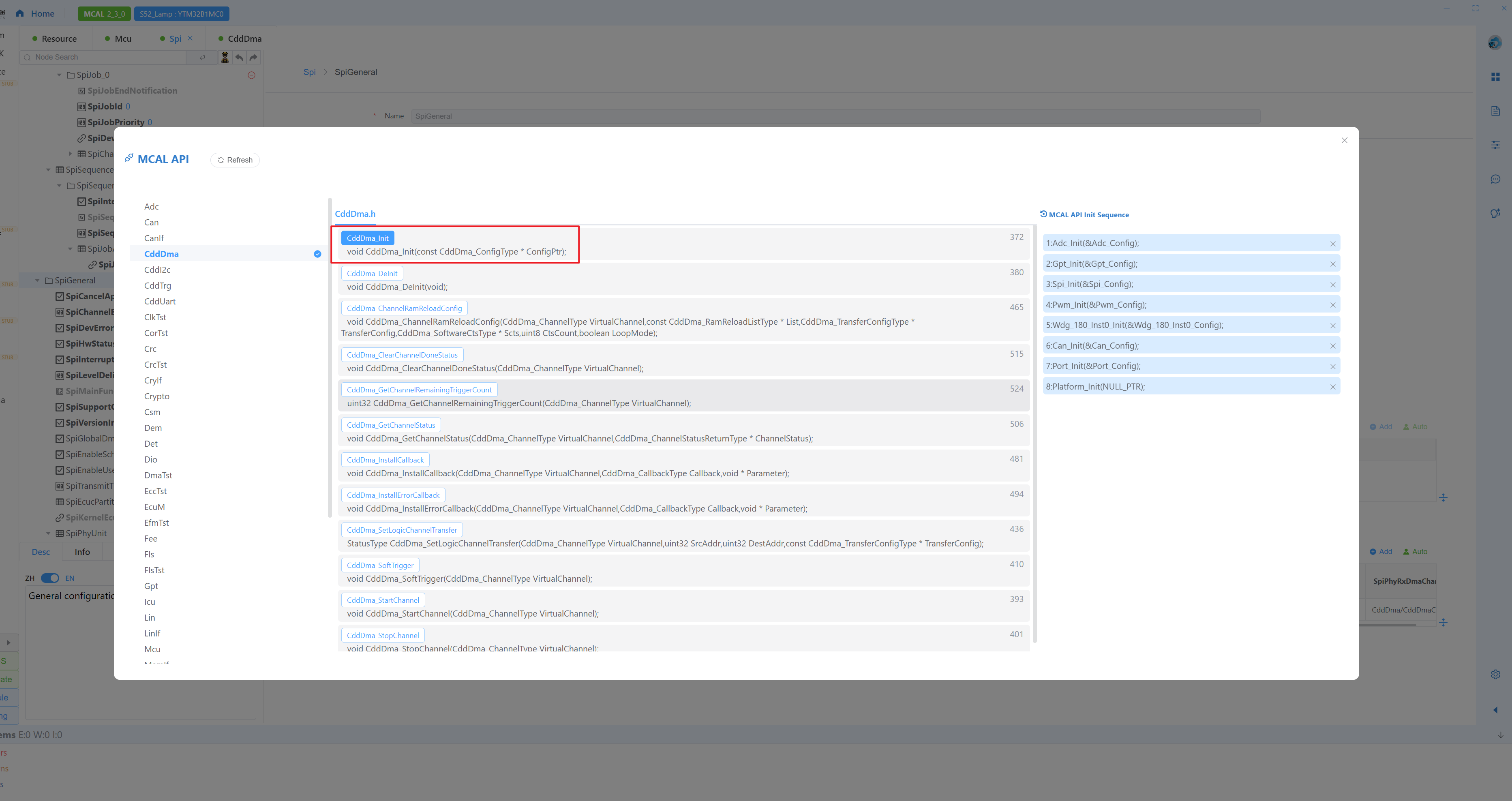

<p dir="auto">您这边 CddDma_init 是自己在代码里调用的吗，我看 API 里没有勾选</p>
