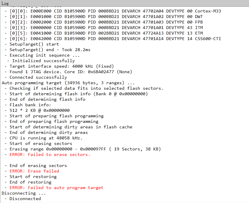

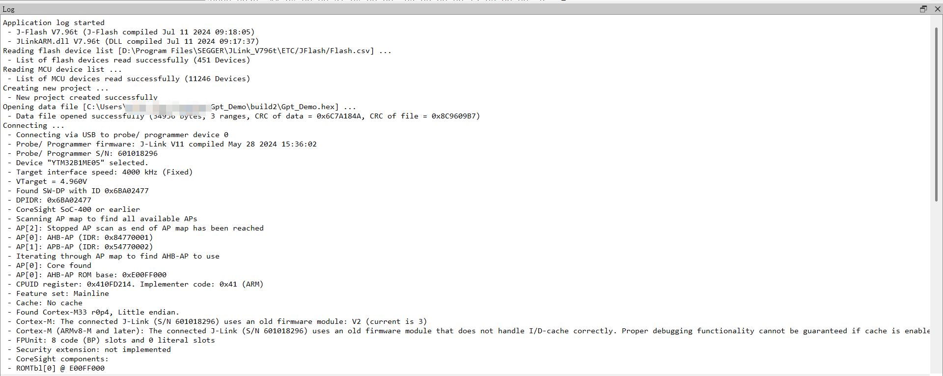

<?xml version="1.0" encoding="UTF-8"?><rss xmlns:dc="http://purl.org/dc/elements/1.1/" xmlns:content="http://purl.org/rss/1.0/modules/content/" xmlns:atom="http://www.w3.org/2005/Atom" version="2.0"><channel><title><![CDATA[JLINK无法擦除Flash]]></title><description><![CDATA[<p dir="auto">使用jlink进行刷写时，连接正常，提示擦除失败。开发板型号为YTM32B1ME0-EVB-Q144 Rev.C，使用了外部供电，据之前使用者描述曾经调试过crypto模块。<img src="https://yt-static-main.oss-cn-shanghai.aliyuncs.com/nodebb/1895/161eebcb-ea6b-4ce6-a1f7-772b7c334dac.png" alt="e98b73b4-34a7-4b96-b15c-379f6913c324-image.png" class=" img-fluid img-markdown" /> <img src="https://yt-static-main.oss-cn-shanghai.aliyuncs.com/nodebb/1895/3b08fecf-ed46-4c83-be7d-ec1db163baea.png" alt="bcf93a4e-1285-4658-9b91-a26460f4388b-image.png" class=" img-fluid img-markdown" /></p>

]]></description><link>https://forum.ytmicro.com/post/8789</link><guid isPermaLink="true">https://forum.ytmicro.com/post/8789</guid><dc:creator><![CDATA[QianBufan]]></dc:creator><pubDate>Wed, 10 Jun 2026 07:54:33 GMT</pubDate></item><item><title><![CDATA[Reply to JLINK无法擦除Flash on Wed, 10 Jun 2026 07:42:33 GMT]]></title><description><![CDATA[<p dir="auto"><a class="plugin-mentions-user plugin-mentions-a" href="https://forum.ytmicro.com/uid/1026">yangke</a> Erase Chip也无法擦除</p>
]]></description><link>https://forum.ytmicro.com/post/8788</link><guid isPermaLink="true">https://forum.ytmicro.com/post/8788</guid><dc:creator><![CDATA[QianBufan]]></dc:creator><pubDate>Wed, 10 Jun 2026 07:42:33 GMT</pubDate></item><item><title><![CDATA[Reply to JLINK无法擦除Flash on Wed, 10 Jun 2026 07:31:51 GMT]]></title><description><![CDATA[<p dir="auto">1、可以用万用表检查一下SWD相关端口的电压<br />
2、在J-flash里面用Erase Chip试试能否擦除</p>
]]></description><link>https://forum.ytmicro.com/post/8785</link><guid isPermaLink="true">https://forum.ytmicro.com/post/8785</guid><dc:creator><![CDATA[yangke]]></dc:creator><pubDate>Wed, 10 Jun 2026 07:31:51 GMT</pubDate></item></channel></rss>
