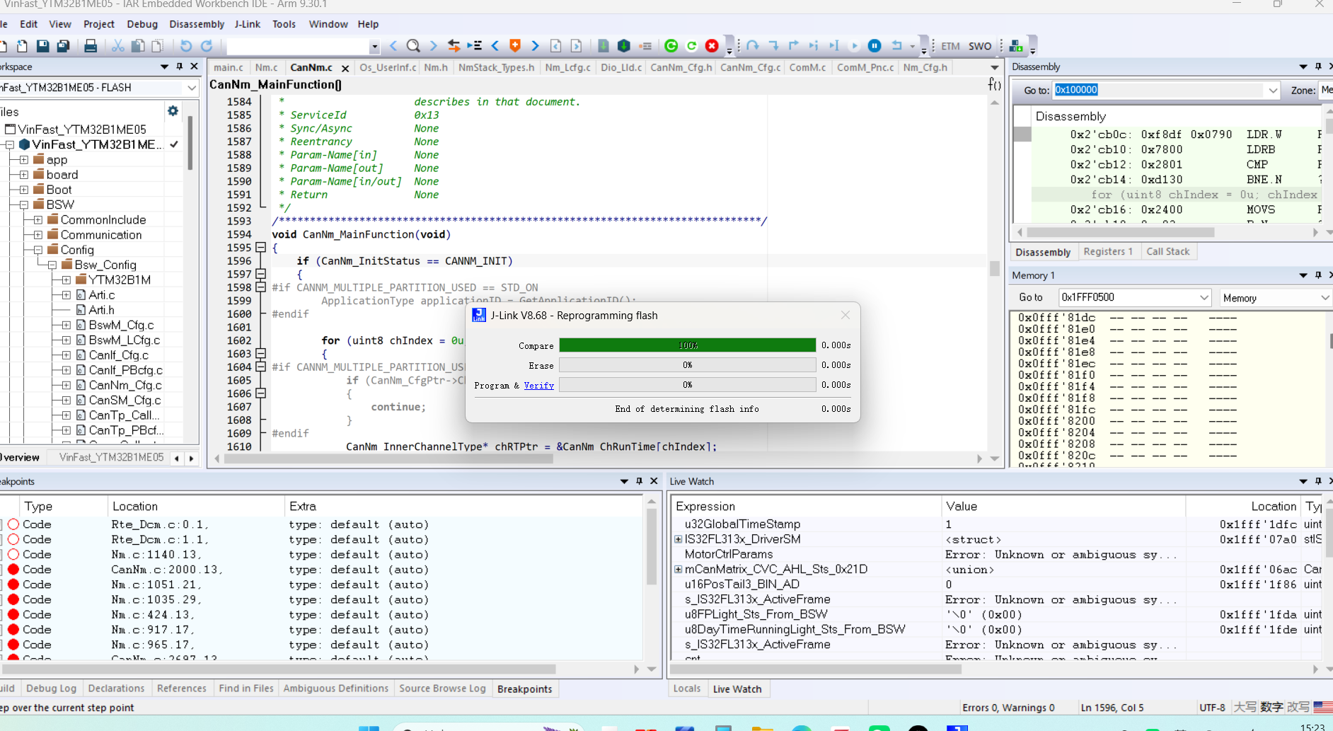

<?xml version="1.0" encoding="UTF-8"?><rss xmlns:dc="http://purl.org/dc/elements/1.1/" xmlns:content="http://purl.org/rss/1.0/modules/content/" xmlns:atom="http://www.w3.org/2005/Atom" version="2.0"><channel><title><![CDATA[J-LINK突然无法调试]]></title><description><![CDATA[<p dir="auto">之前一直正常，可以进入debug界面，但是单步调试不行，会卡死<br />
<img src="https://yt-static-main.oss-cn-shanghai.aliyuncs.com/nodebb/1591/4bf7f968-6f26-4a81-9e41-28ad12967a5f.png" alt="d26968fd-0777-4ec0-ba09-34bed6d6d0ba-image.png" class=" img-fluid img-markdown" /></p>
