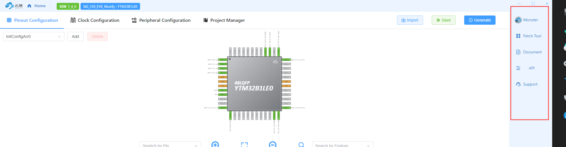

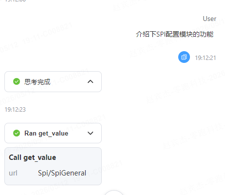

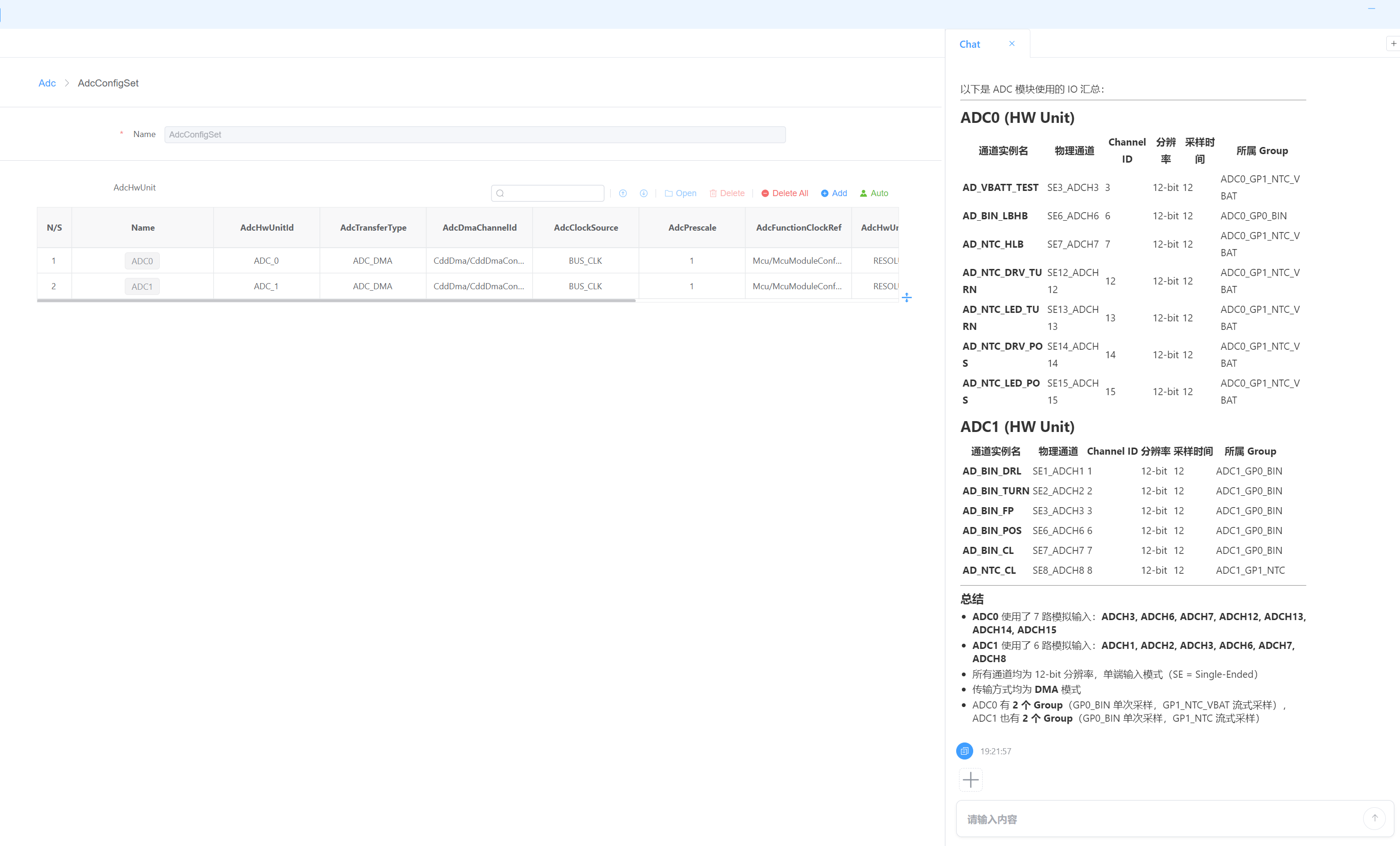

<?xml version="1.0" encoding="UTF-8"?><rss xmlns:dc="http://purl.org/dc/elements/1.1/" xmlns:content="http://purl.org/rss/1.0/modules/content/" xmlns:atom="http://www.w3.org/2005/Atom" version="2.0"><channel><title><![CDATA[YCT中Al Agent使用]]></title><description><![CDATA[<p dir="auto">目前agent支持问那些问题，出现下面的内容正常吗？<br />
<img src="https://yt-static-main.oss-cn-shanghai.aliyuncs.com/nodebb/1756/dc8e3f11-e4a8-4f29-9fa3-f1015249ac88.png" alt="77bf7209-383c-40e3-b2f1-a7cd28c0889a-image.png" class=" img-fluid img-markdown" /></p>

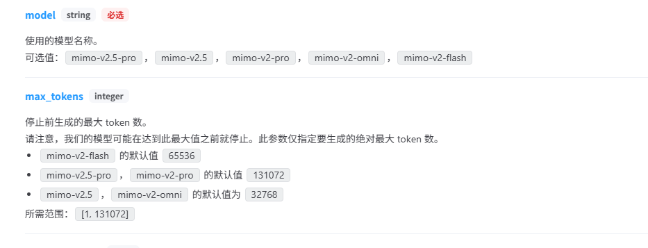

]]></description><link>https://forum.ytmicro.com/topic/1944/yct中al-agent使用</link><generator>RSS for Node</generator><lastBuildDate>Wed, 13 May 2026 11:57:22 GMT</lastBuildDate><atom:link href="https://forum.ytmicro.com/topic/1944.rss" rel="self" type="application/rss+xml"/><pubDate>Tue, 12 May 2026 11:14:23 GMT</pubDate><ttl>60</ttl><item><title><![CDATA[Reply to YCT中Al Agent使用 on Wed, 13 May 2026 01:01:19 GMT]]></title><description><![CDATA[<p dir="auto">不是我想要的结果，对于问题的提问有要求？<br />
<img src="https://yt-static-main.oss-cn-shanghai.aliyuncs.com/nodebb/1756/39b58cba-a777-455f-8bdf-110fa4be8ab7.png" alt="image.png" class=" img-fluid img-markdown" /></p>

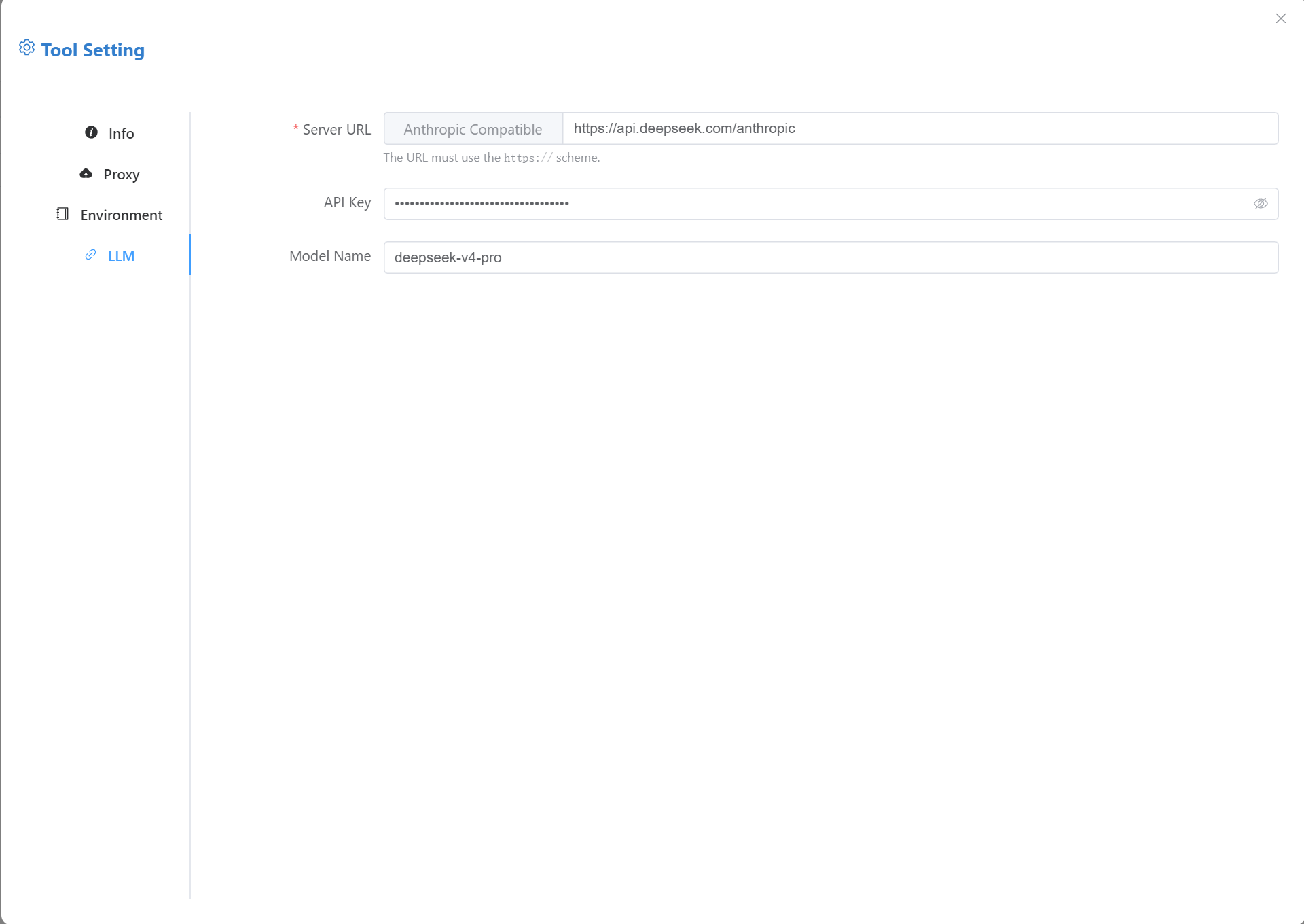

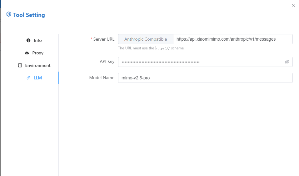

]]></description><link>https://forum.ytmicro.com/post/8431</link><guid isPermaLink="true">https://forum.ytmicro.com/post/8431</guid><dc:creator><![CDATA[LPLP]]></dc:creator><pubDate>Wed, 13 May 2026 01:01:19 GMT</pubDate></item><item><title><![CDATA[Reply to YCT中Al Agent使用 on Tue, 12 May 2026 11:31:34 GMT]]></title><description><![CDATA[<p dir="auto">先配置好API，在Setting-&gt;LLM界面,这里以接入deepseek为例，可参考deepseek的API文档<a href="https://api-docs.deepseek.com/zh-cn/" rel="nofollow ugc">https://api-docs.deepseek.com/zh-cn/</a>，填写好如下信息后,重启YCT.<img src="https://yt-static-main.oss-cn-shanghai.aliyuncs.com/nodebb/1300/70bf98d5-9a85-4433-9e91-89c88f34cb7f.png" alt="image.png" class=" img-fluid img-markdown" /></p>

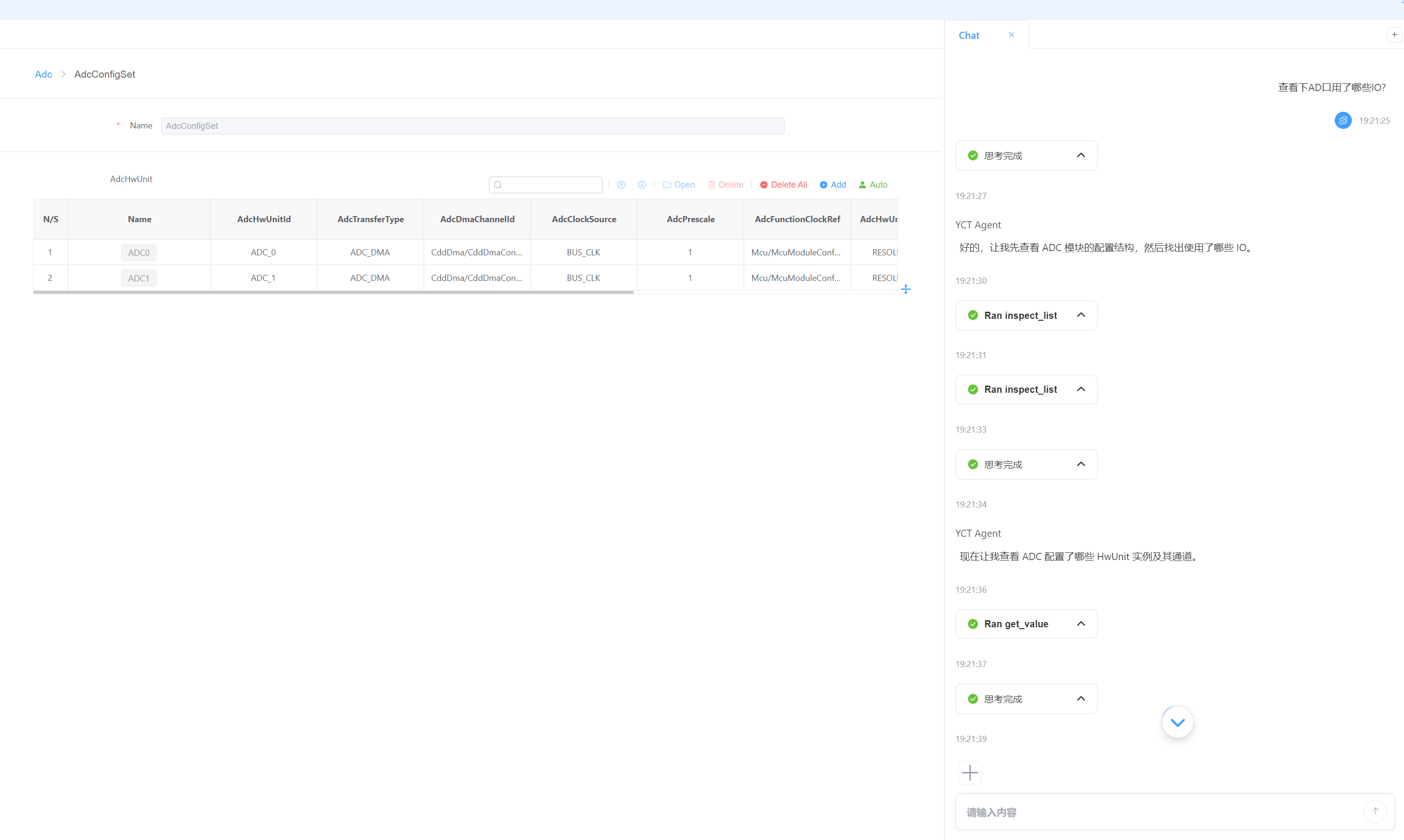

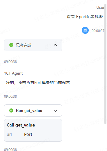

<p dir="auto">重启后，可以正常对话了，比如分析下当前项目的AD配置:<br />
<img src="https://yt-static-main.oss-cn-shanghai.aliyuncs.com/nodebb/1300/66e6cf29-89d8-44b4-8117-73fd78b57fe2.png" alt="2ee48bc0-e406-48ac-88f4-688d8df33ea3-image.png" class=" img-fluid img-markdown" /><br />
<img src="https://yt-static-main.oss-cn-shanghai.aliyuncs.com/nodebb/1300/830d6e77-7e7b-46ea-bdd4-c23d0da76d65.png" alt="5a6ca317-6b40-428a-aa31-515576e22c70-image.png" class=" img-fluid img-markdown" /></p>
