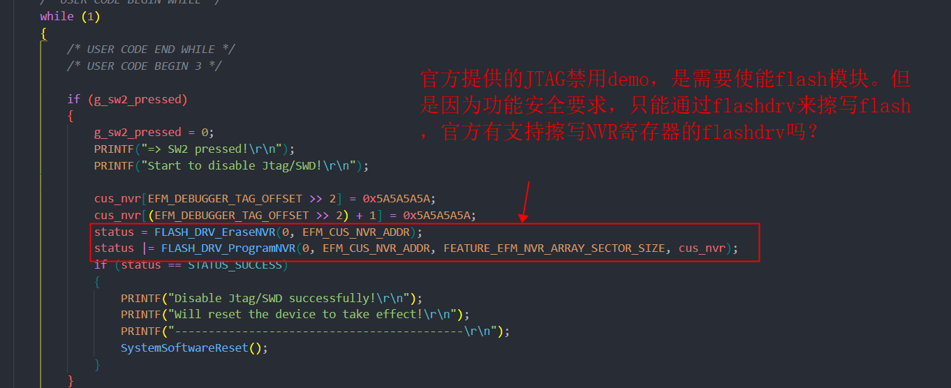

<?xml version="1.0" encoding="UTF-8"?><rss xmlns:dc="http://purl.org/dc/elements/1.1/" xmlns:content="http://purl.org/rss/1.0/modules/content/" xmlns:atom="http://www.w3.org/2005/Atom" version="2.0"><channel><title><![CDATA[ME05的flashdrv能支持擦写CUS_NVR吗]]></title><description><![CDATA[<p dir="auto">官方提供的JTAG禁用demo：<br />
<img src="https://yt-static-main.oss-cn-shanghai.aliyuncs.com/nodebb/1425/f6047c06-b79d-42f1-8138-88eed4193424.png" alt="df0aad82-c975-45fb-9046-54b49c0dd043-image.png" class=" img-fluid img-markdown" /></p>

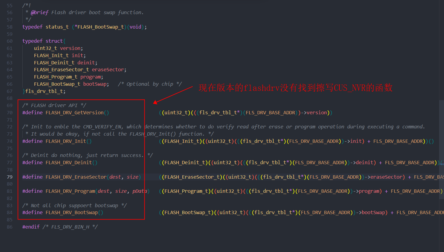

<p dir="auto">现在手头上的flashdrv（应该是1.3.1版本的）：<br />
<img src="https://yt-static-main.oss-cn-shanghai.aliyuncs.com/nodebb/1425/2fc15f35-c5a3-47bd-abc4-f68bc4095f09.png" alt="01a42c00-1c79-4515-a459-7a16cd383081-C4FC7445-C5D5-4345-A037-CDB317360566.png" class=" img-fluid img-markdown" /></p>

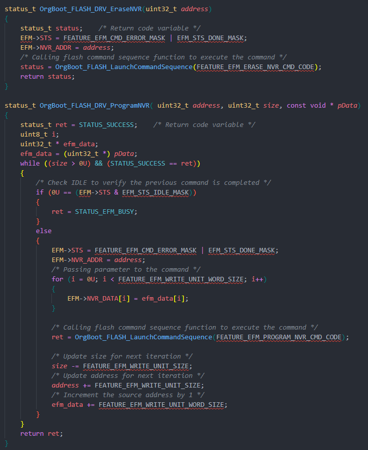

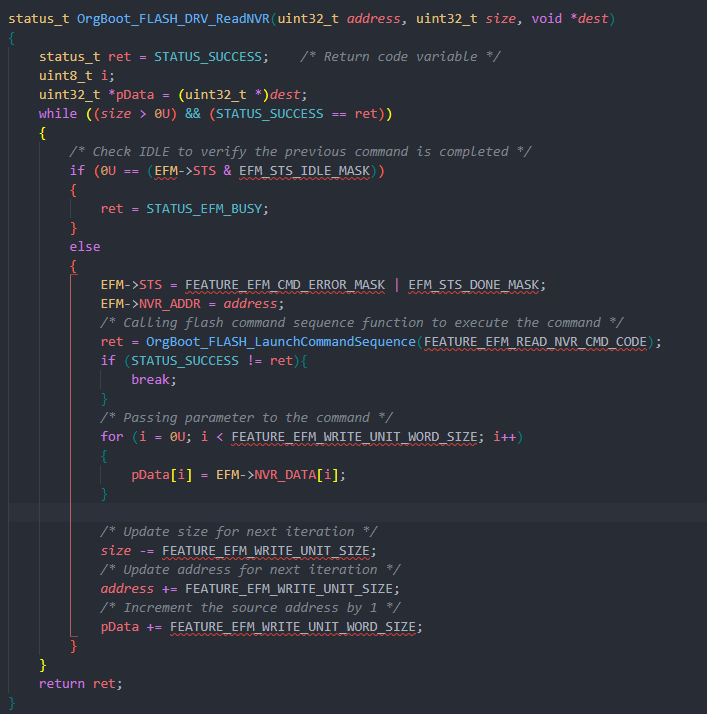

<p dir="auto">我直接从flashdrv的那个工程(bin_project),把这几个函数挪到我的APP代码里，可以吗？<br />
<img src="https://yt-static-main.oss-cn-shanghai.aliyuncs.com/nodebb/1425/6afc2bfb-a655-4f0f-afb2-68a62993560b.png" alt="403b520b-040d-42b0-92a7-81baeb3a83f6-7524F827-71C8-4e3e-8A7A-5C3653DA99EA.png" class=" img-fluid img-markdown" /><br />
<img src="https://yt-static-main.oss-cn-shanghai.aliyuncs.com/nodebb/1425/2936a477-3258-4047-841d-3f9d974815db.png" alt="9b037b08-56a0-4dd2-aee1-984067c9afd1-6B6F1C45-A2C0-439c-9EFD-E3212CDC988E.png" class=" img-fluid img-markdown" /></p>

<p dir="auto">我原来1.3.1的flashdrv已经出过货了，我不想更改flashdrv了，但是又因为信息安全，我在app中不能开启flash模块。我可以直接把flashdrv工程里面的FLASH_DRV_ReadNVR、FLASH_DRV_ProgramNVR、FLASH_DRV_EraseNVR拷贝到APP里面来实现吗？我在FLASH_LaunchCommandSequence里面限定用于擦写CUS_NVR</p>
]]></description><link>https://forum.ytmicro.com/post/8202</link><guid isPermaLink="true">https://forum.ytmicro.com/post/8202</guid><dc:creator><![CDATA[feiniu002]]></dc:creator><pubDate>Tue, 14 Apr 2026 03:02:34 GMT</pubDate></item><item><title><![CDATA[Reply to ME05的flashdrv能支持擦写CUS_NVR吗 on Tue, 14 Apr 2026 02:46:12 GMT]]></title><description><![CDATA[<p dir="auto"><a class="plugin-mentions-user plugin-mentions-a" href="https://forum.ytmicro.com/uid/1425">feiniu002</a> flashdrv 的flash_driver.c中 有 FLASH_DRV_EraseNVR 和 FLASH_DRV_ProgramNVR。<br />
